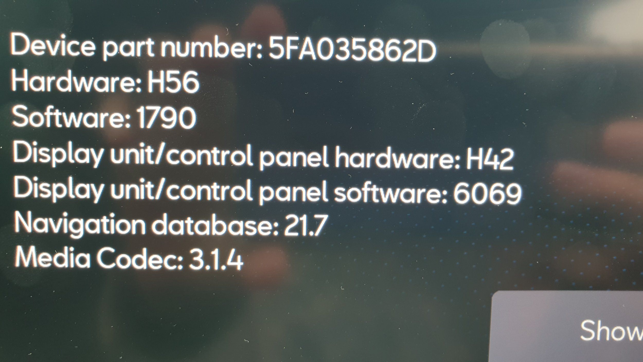

Yes that's the pop I've heard before.
Could you post a picture of the system information/versions on yours?
I hear popping sound once per every drive for a month or so. Initially, I thought it's plastic bottle in the drink holder. But only on two occasions, after the pop, I got SOS error and GPS lost its location. Otherwise, nothing happens after the pop.
OK yep you're on what I was before the dealer updated it, and my control panel software got updated to 6078 - and it fixed everything for me.
