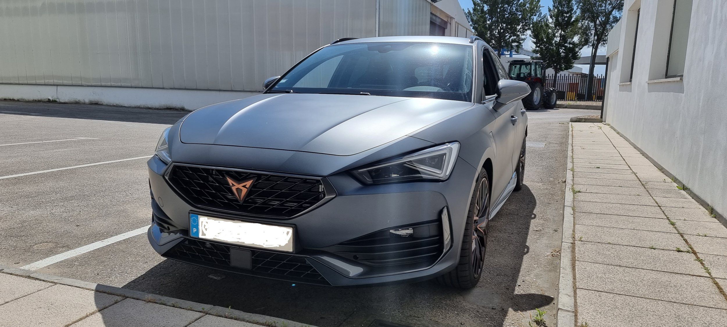

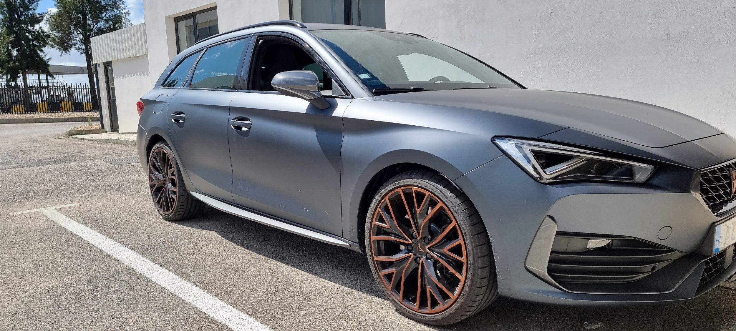

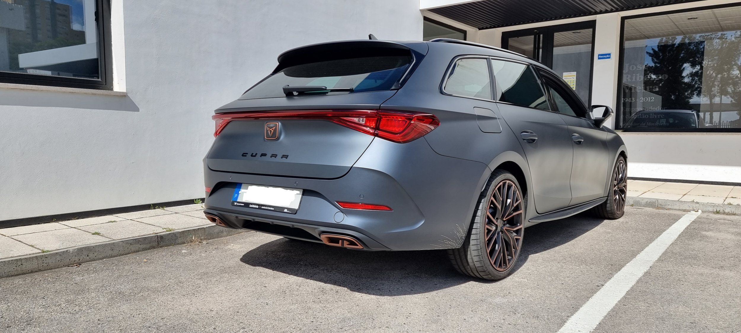

here are some pictures of my car.
Well that's what I call a result! Your new car looks fantastic ?
