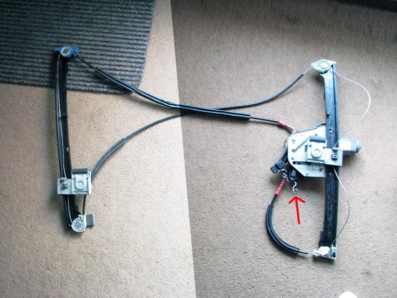

Well I took it apart (what a fecking pain that was, sliced my thumb apart while trying to undo the stupid window clamps) Seems that the actual motor and mechanism are OK, but the cable is completely and utterly fcked, twisted and snapped. So before I go spending £90 of my hard earned cash I will try and replace the steel cable with a new one or some kind of strong string ;)

Well the problem with mine is that the steel cable had snapped (how, I'll never know??). So all I need to do is replace the cable. Problem is you can't buy just the cable from SEAT because you need to have some little metal bits crimped on, but they need to be crimped on only once the wire is running through the mechanism. I'm just about to go to B&Q to get some steel wire to see if I could replicate it.
p.s. I would of never imagined that there are 3.5 meters of wire in the stupid mechanism
This is what mine looks like. Where the arrow points you can see that the wire is twisted and snapped:

Thats what happened to mine yeah. I was thinking of repairing it, but looks like a pain in the arse to thread the wire through. Made sure I got pleanty of oil into the new one. Oh, and the motor doesnt come off.
