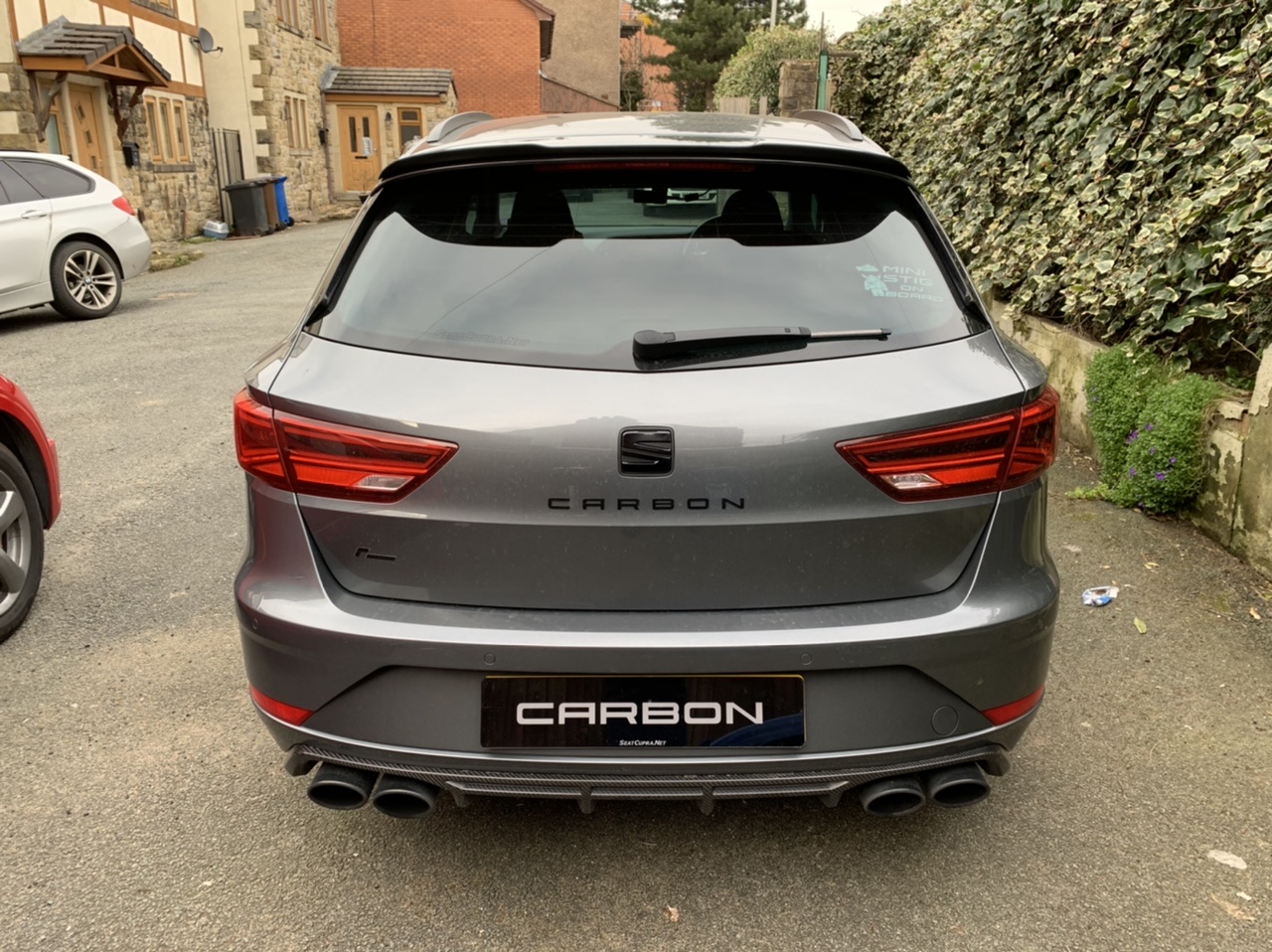

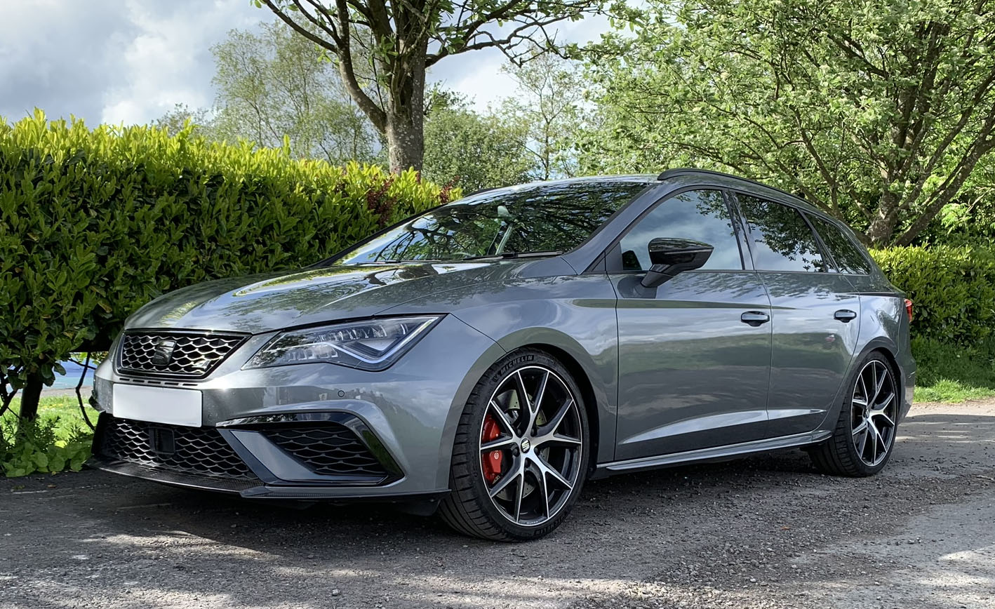

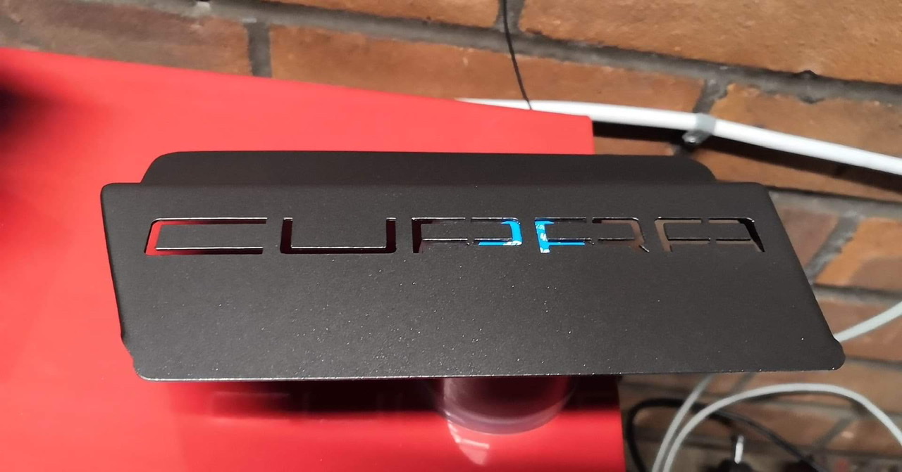

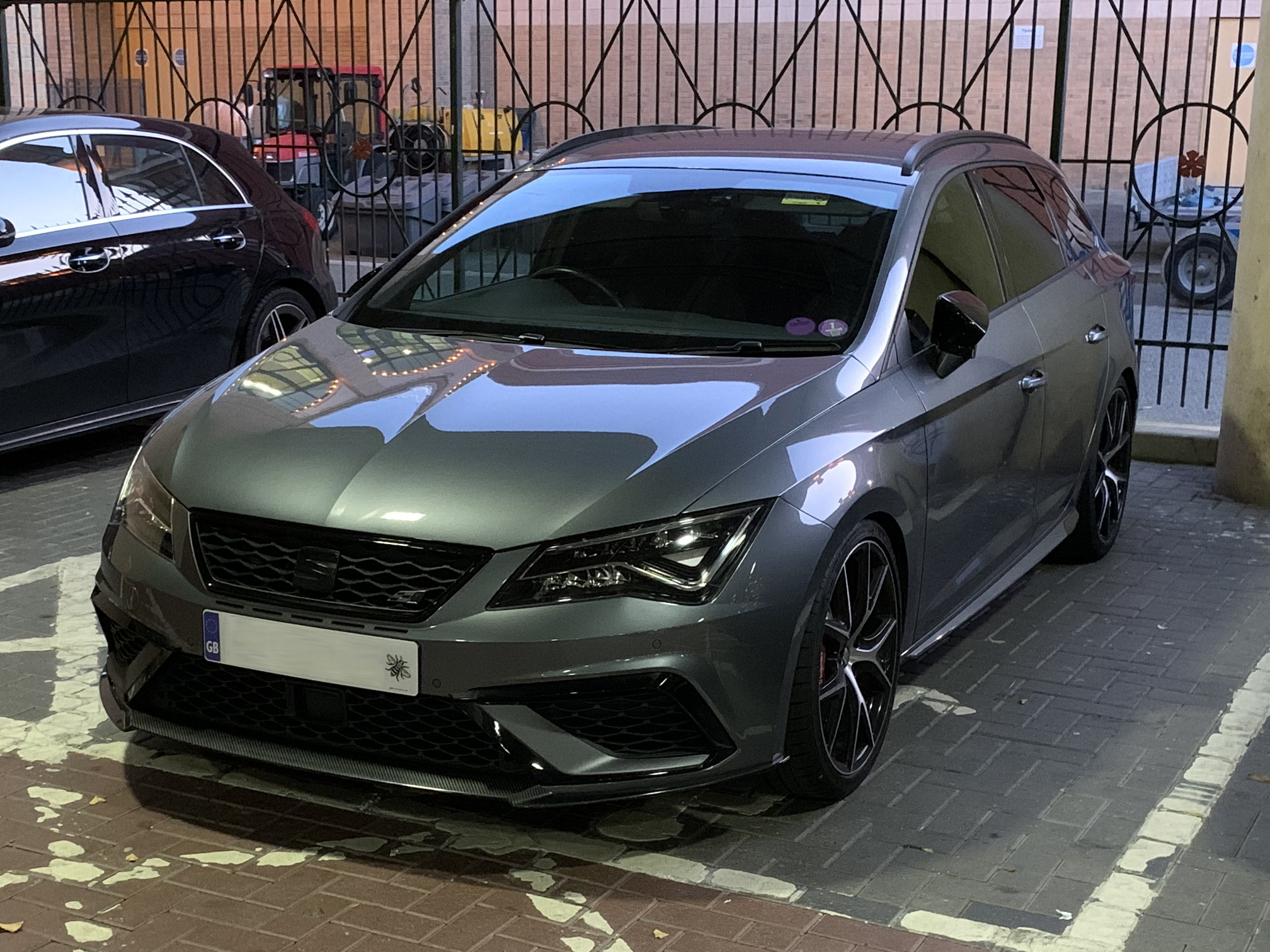

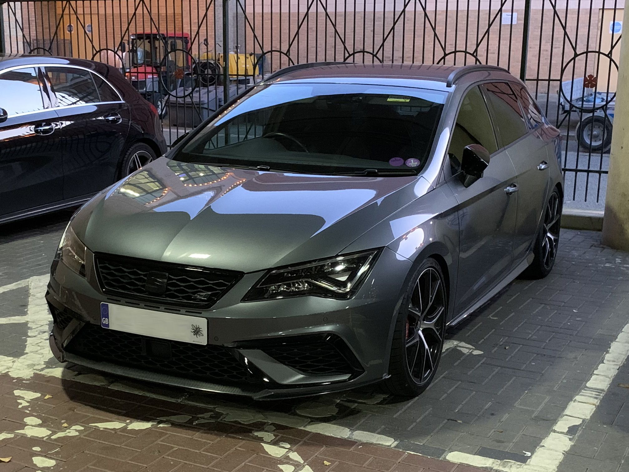

So I have a few mods in the works. Painted rear bumper insert (body colour) and the Maxton rear spoiler lip (also to be painted body colour). However I also bought a second set of R grills now that they're easy to get.
As every person and his dog now appear to be getting their hands on them though, bought them to make mine look a little different.
The ones fitted are currently painted all black but this was too much, so the inserts are wrapped with some 3M 1080 Matt Dark Metallic Grey:
However I can get the new grills painted however I like. In my head I want the black painted body colour, and it seems to look good on photoshop, but wondering if if I do the insert as well, or leave the insert black. Or just paint the insert like everyone else. Decisions...

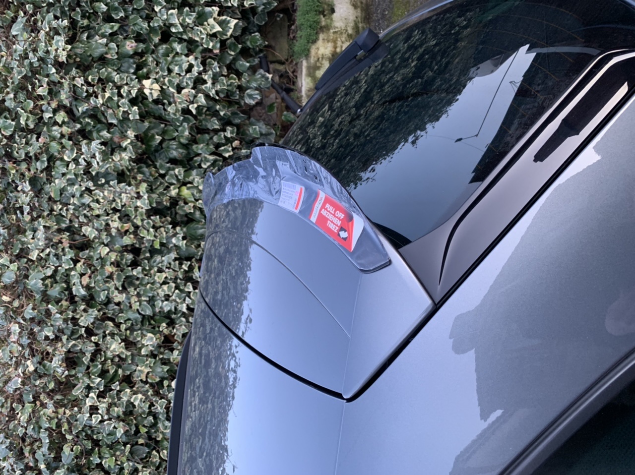

Just waiting on the spoiler lip, once I have that I'll send them all of to be painted at the same time. Saves on paint cost.
Fully painted for me, looking at mid April for another Doncaster meet will one be ready for then lol
Yeah I'd expect so, all depends on when the spoiler lip arrives and the paint shop. And then fitting it all haha none of it will be fun jobs.

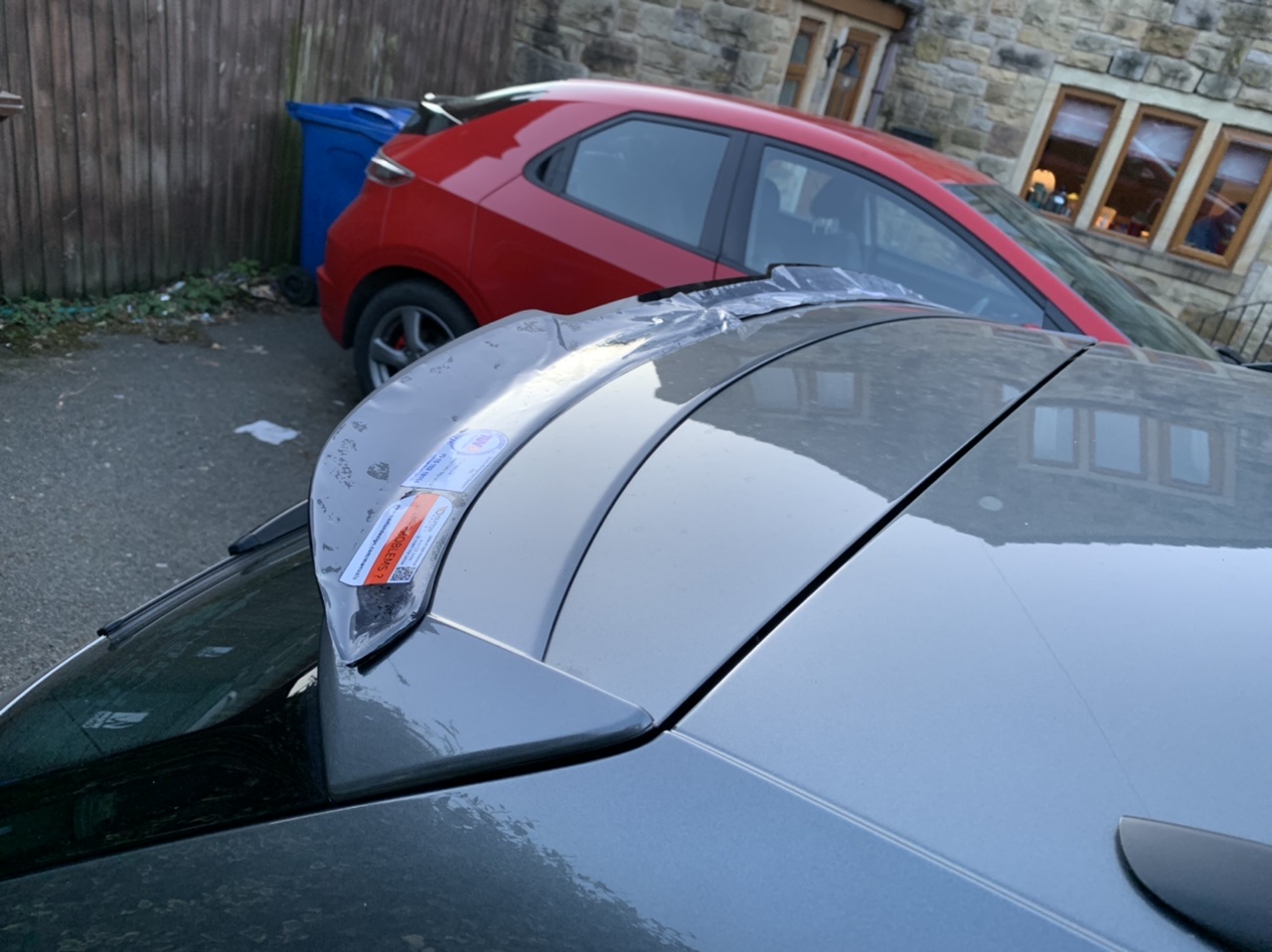

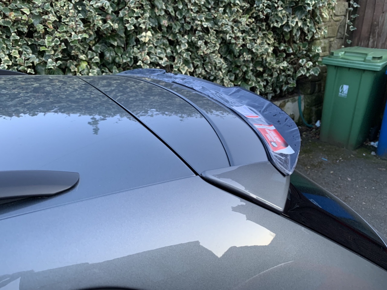

I was under the impression that the Maxton Rear Spoiler lip wouldnt fit the ST! Please share your secrets!
Hahahaha
Not so much a secret as a new version for the ST. They say facelift only but the spoiler is the same across all the Cupra ST's apart from the R and special editions in europe.
Reactions: wms_F1
Hahahaha

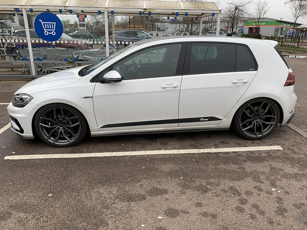

And what a day! Not only did I walk away smiling, with a very healthy car after being really looked after by a great bunch of people. I also got to spend a morning unsupervised driving their Stage 3 Golf R, Stage 3 Ceramic Brakes and some secretive development suspension that was very cool.
**** me is about all I can really say. It was a fun morning and glad I had @paddy6789 with me to yabber to.
Anyway whilst I was out driving the Golf to Tesco (to warm the oil) and bringing it back the scenic route, my car was on their Dyno (more on that later).

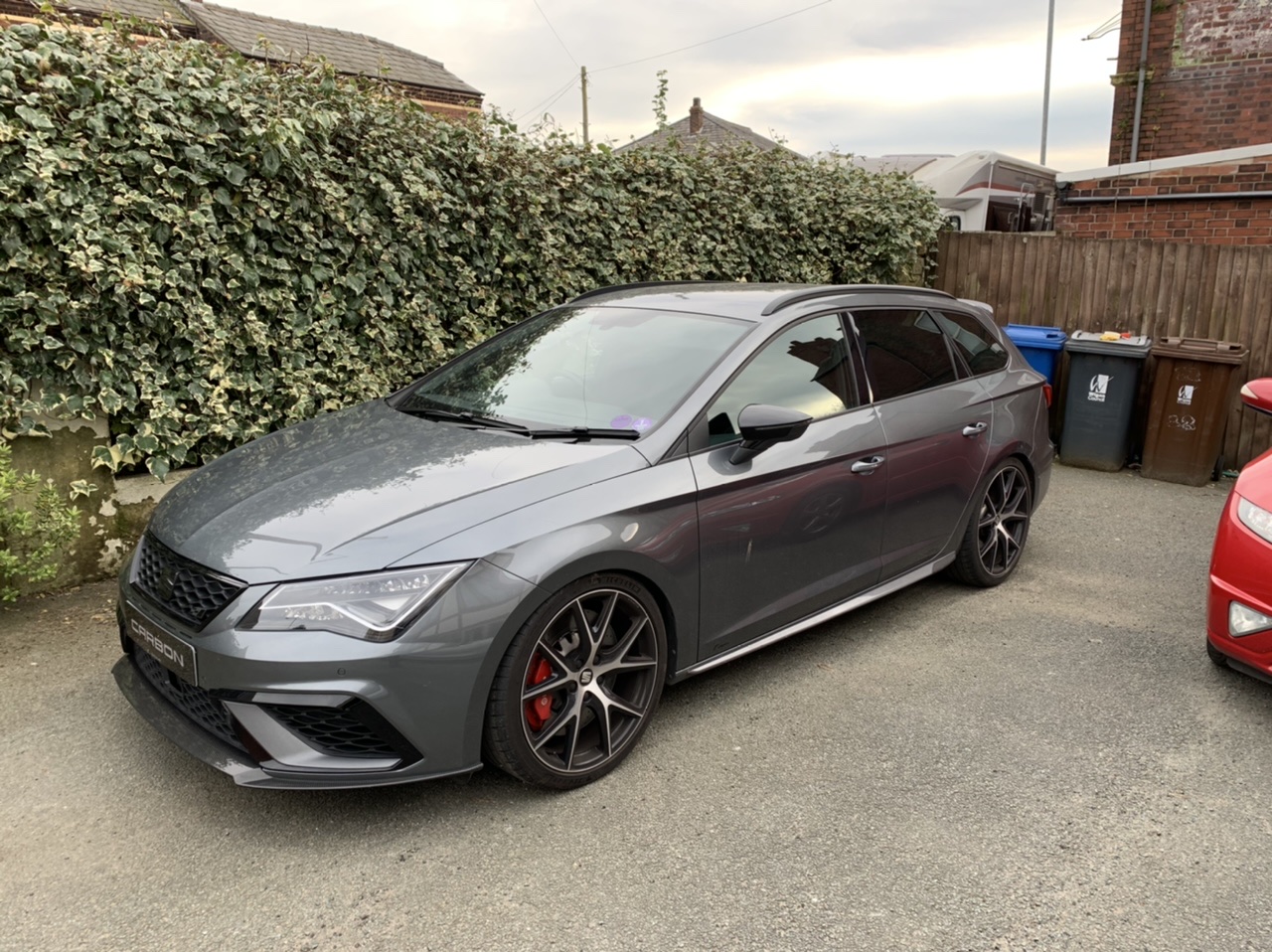

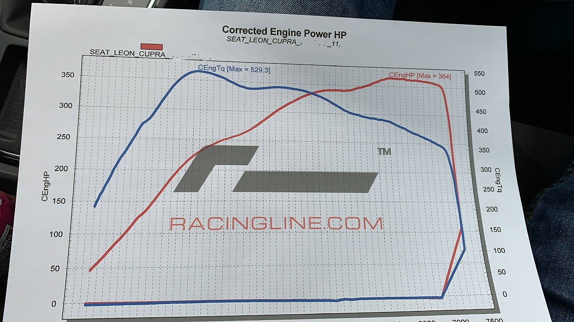

As expected my car produced 330hp so comparable to the numbers from unicorn.
They then took their original Stage 1 calibration off and it produced 310 stock (but it does have the R600 etc) so the car is defo healthy.
So after a new calibration they were still not 100% happy and wanted to double check what fuel was in it. After confirming it was running on V Power 99 as always they did another tweak and re ran everything with the result that raining it back a little mid range, ended up giving it a little more top end. I'm putting it simplistically after seeing what they did later there, as it looked very Matrix like to me.

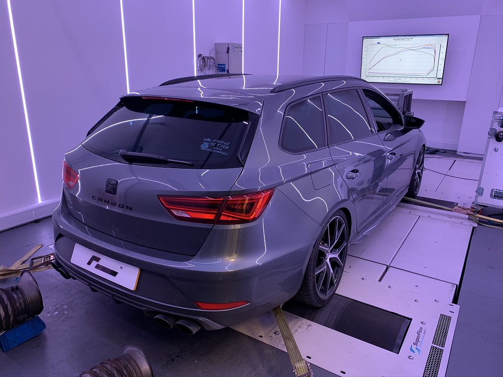

So after a bacon barm (Or roll if your a southerner) we were invited for a tour and a chance to see the Dyno:
The fans on this thing are immense. Don't be fooled by the fan at the front, thats just to help direct the flow to the radiator more. I was stood behind the car, and the best way to describe it is like having my head stuck out the sunroof on the motorway.
The car produced 392 uncorrected for air temps (it was cold in MK) and 364hp/529NM corrected :D
So took the car for a spin, and it was never slow before, but now? It’s just better, smoother (and it was never not smooth anyway) and more umph top end.
So a very happy man indeed.

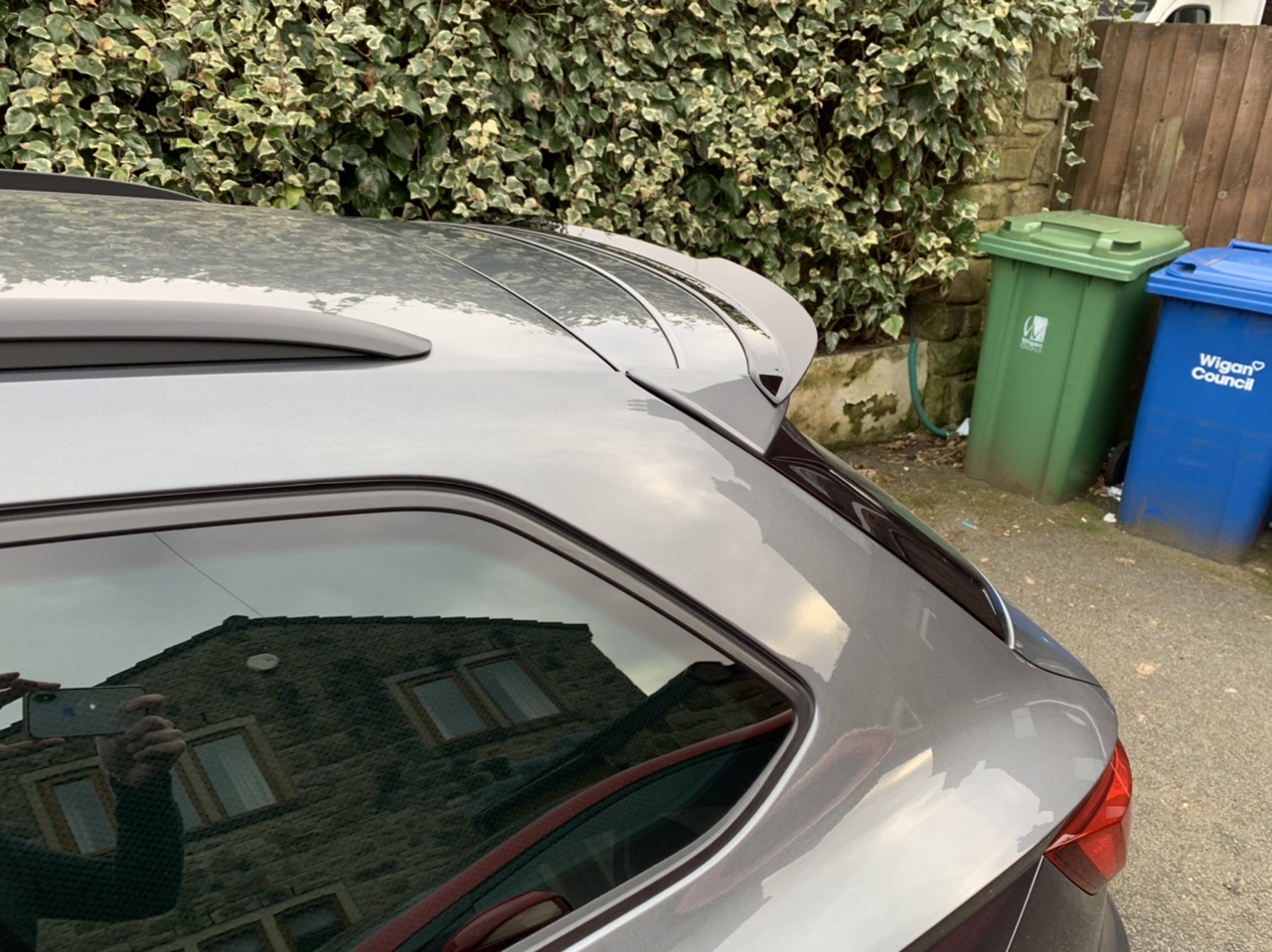

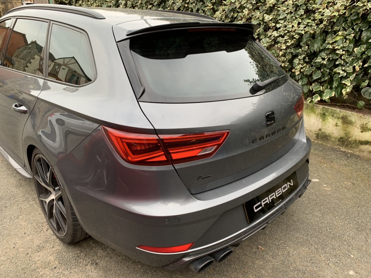

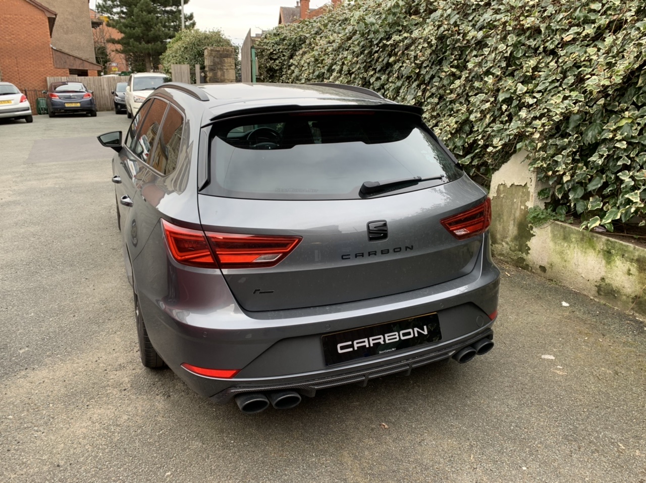

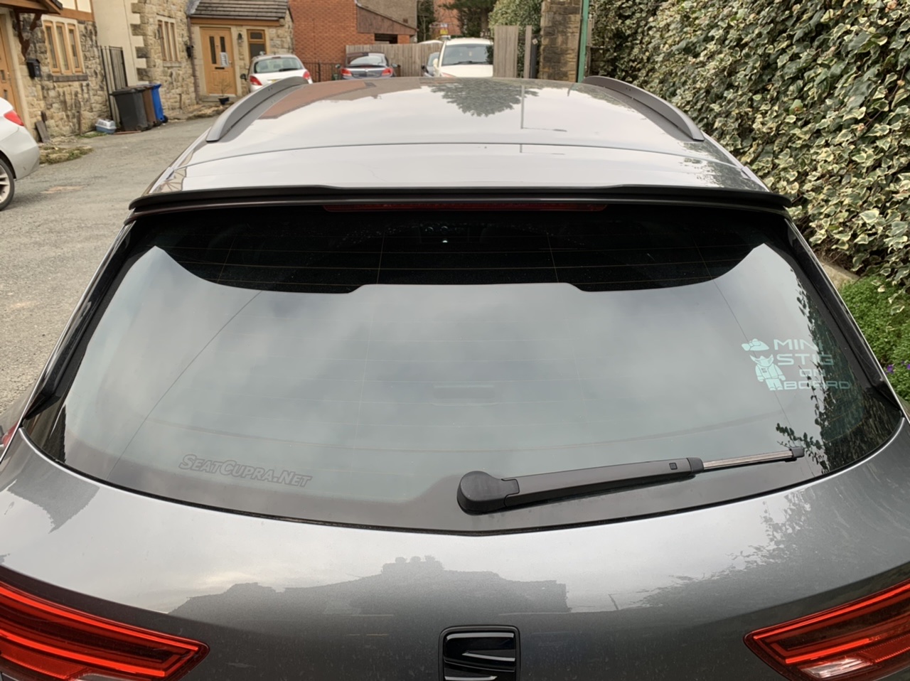

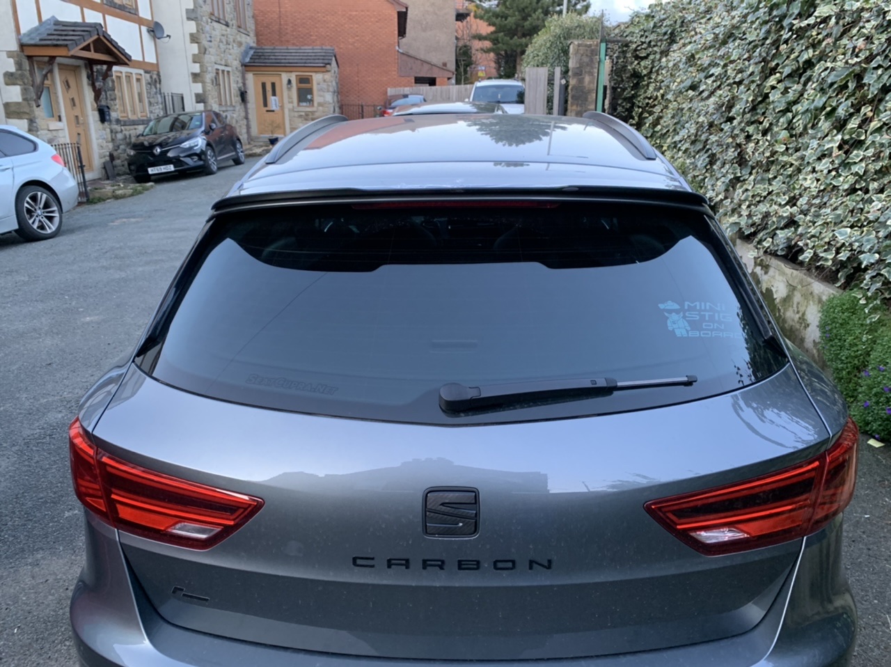

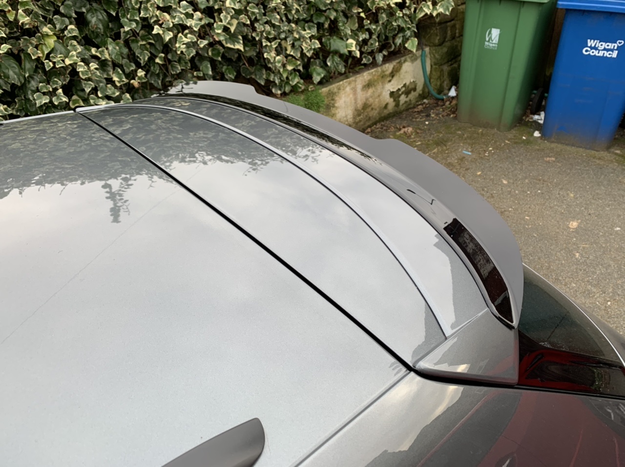

Nice Damp, can you take some nice photos from different angles? I'm also considering to get this for my 300ST.
This is the maxton design in gloss black?
