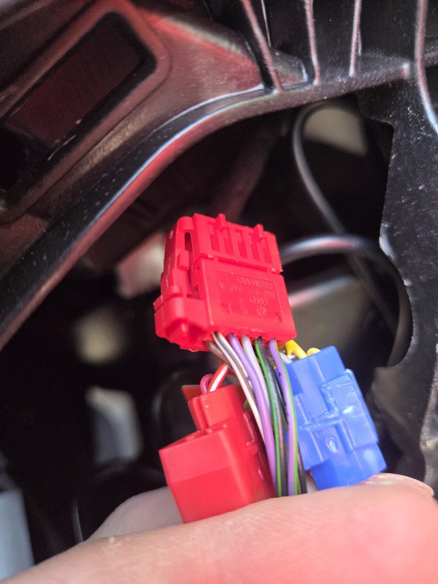

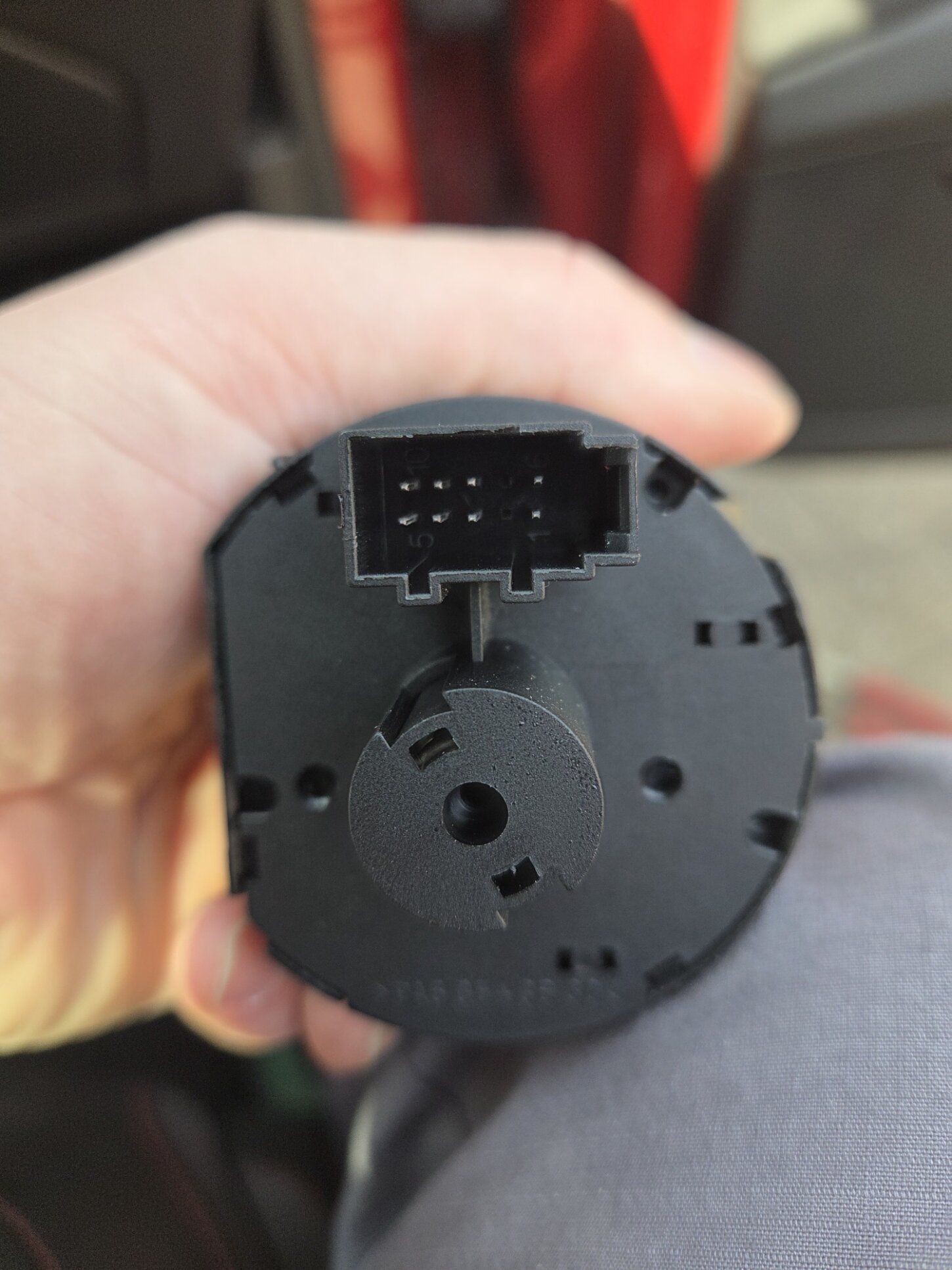

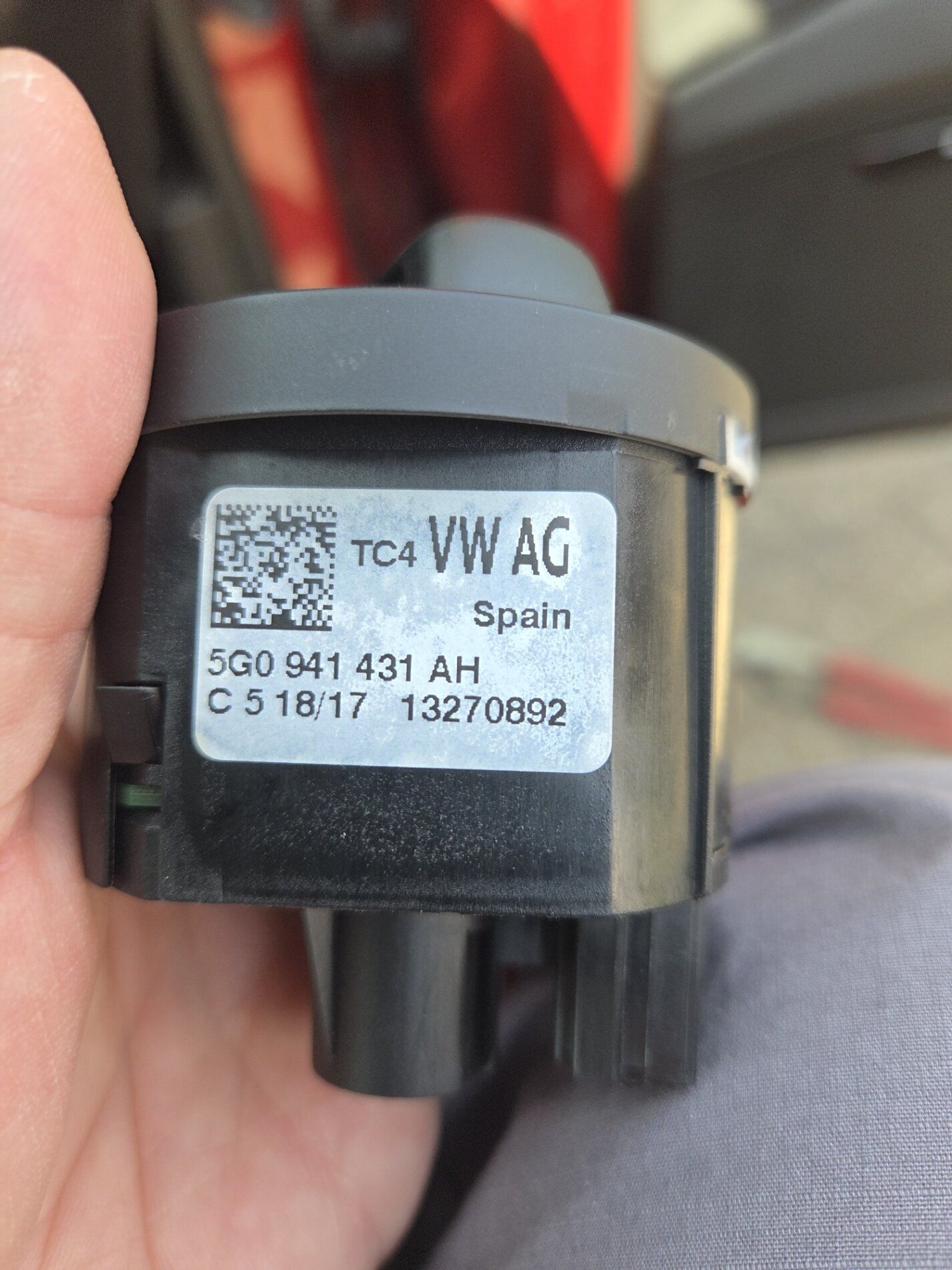

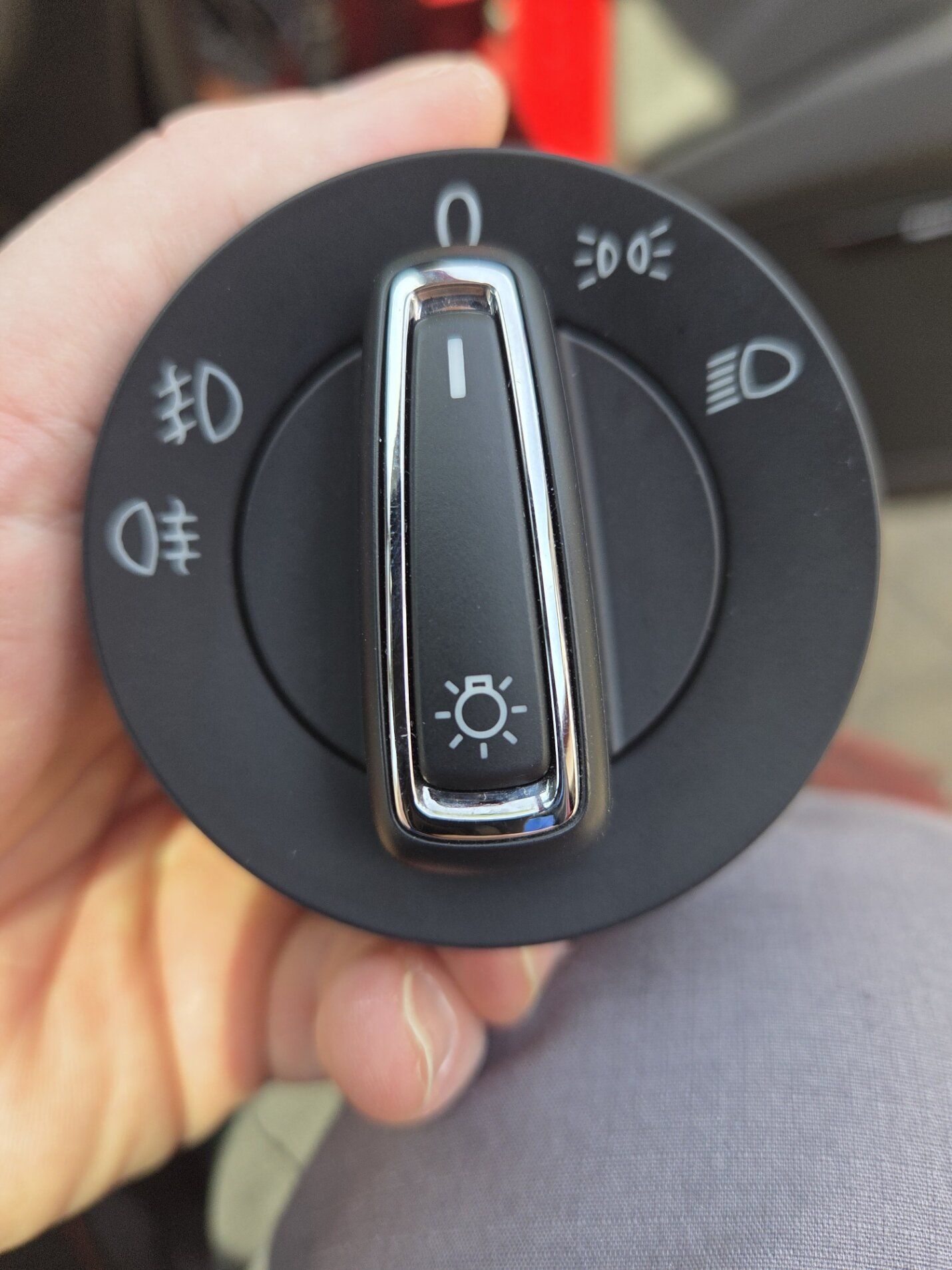

I have a 3-wire dashcam kit going in. I've got two of these kits in other cars and they work fine. I've hooked up the permanent live to pin 8 on the headlight connector and the switched live to pin 10. Before I connected everything I used a tester to see which pins were live with ignition on and off, having pulled the switch out and disconnected it first. Pin 8 was live all of the time so that seems to abe a permananet live feed, no problem with that one.
The issue I have is with the switched live. When I installed the dashcam and put the headlight switch back it's not working as expected, the dashcam now only comes on when the sidelights are turned on. I did a few more tests, and it seems that pin 10 only behaves as ignition-switched when it's not connected to the switch. When it's connected to the switch it only comes live if sidelights are turned on.
So my question is, which wire from the back of the headlight is a true switched live?
Mk3 Leon FR on a 67 plate.

The light circuit is canbus controlled. You'll have all sorts of problems and false bulb out errors if you connect to the light switch. Connect direct to the fusebox, with a separate fuse protecting the circuit.
Reactions: nd-photo.nl
Not a good choice for many reasons.
Seeing as you've run it to the driver side, you may as well use the OBD port for your feeds now as that has a good T15 and T30. Pin 1 for switched and 16 for permanent
I don't mean to be a know-it-all, I just want to clarify. In the Leon 5F, the light switch isn't monitored via CAN bus, and it's not a LIN sub-device. The BCM only checks for a plausible switch position. If it's disconnected, the vehicle's emergency lighting mode activates, or if the signal is implausible, a warning message appears on the display.
Thanks, I'll check out the OBD route.
