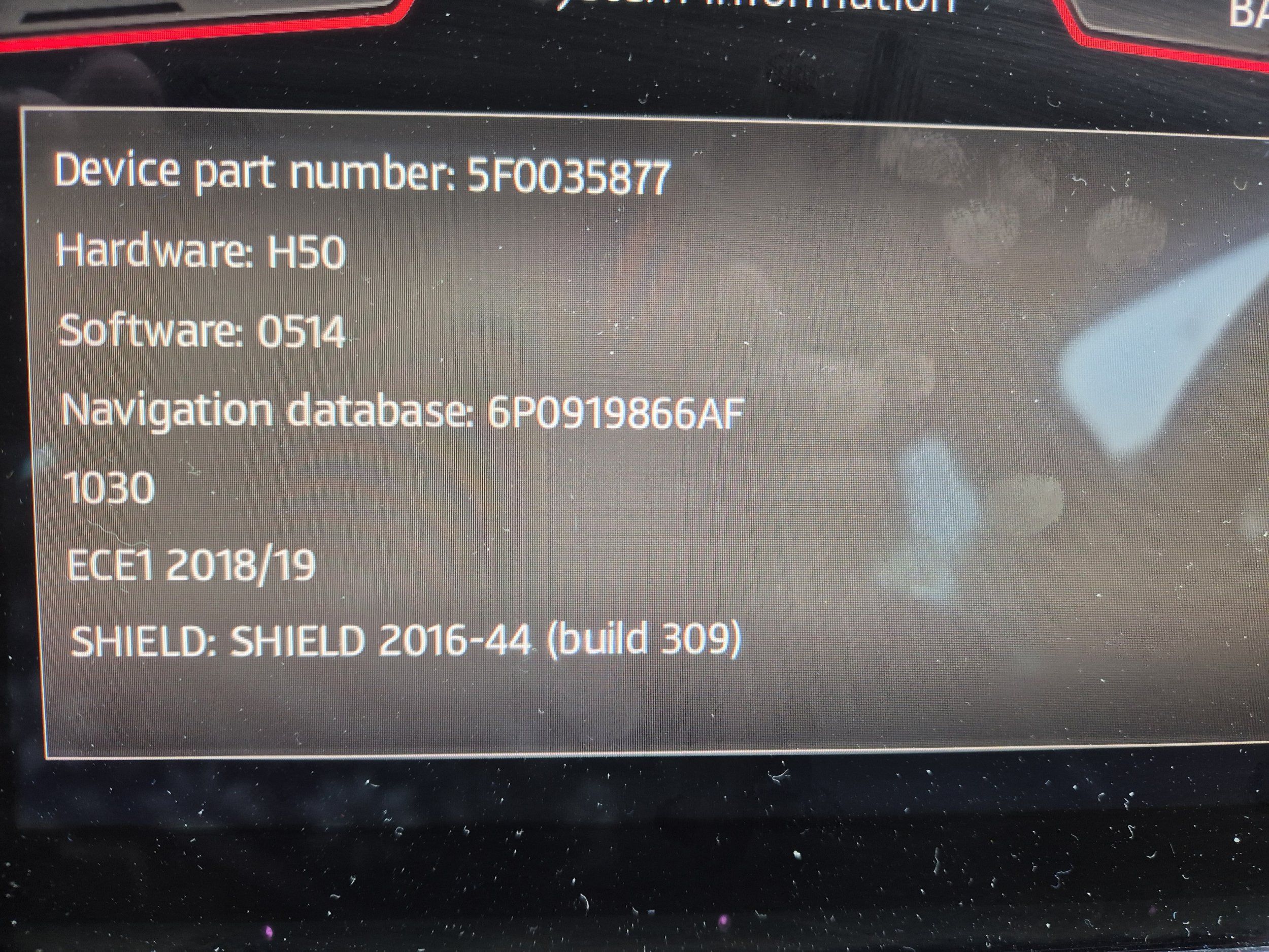

It's a pre-facelift 2020 registered Ateca. Not sure how to check the error log or get the virtual cockpit hardware number. Yes, all 'changing data' appears to have gone (Except of course the overall mileage). All the other stuff (like MPG since last trip/fuel refill etc) is basically reset.
Any advice appreciated.
The picture shows the multimedia system. For the speedometer you need a diagnostic tool. Are the values in the speedometer and radio set to 0?
The Car is Produced in the year 2020? Why you have a Navi Mal from 2018?

That means that in the virtual cockpit the values "from start", "long-term" and "from refueling" are set to 0 but you have values displayed on the radio?
Correct. So after it happened for example my fuel tank was about 3/4 full but the distance travelled since last ref-fuelling was now set to 0. The radio appears to be unaffected. Only data in the cockpit display impacted.
If you say the vehicle is probably a 2019 model, it is one of the first Virtual Cockpits. These were not technological marvels. Please tell me the VIN so I can see more details. It probably has the part number 5F0920790 with a SW 16XX. You can try to do an update, but I think the memory is defective.
