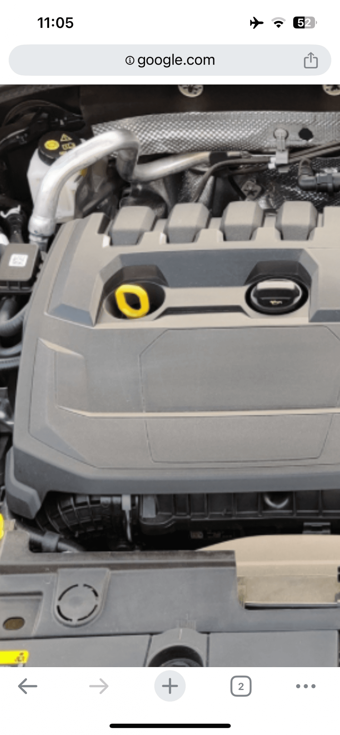

Thanks for the reply the_winner but it’s not like this the 2025 MY ( as in your pic)

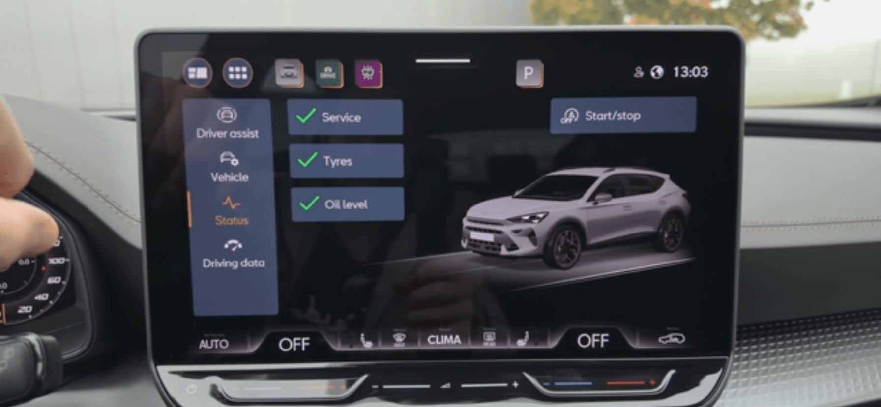

If you go to the car app from there at car status … it has an option check oil levels … it shows a virtual dip stick with your engine oil measurement

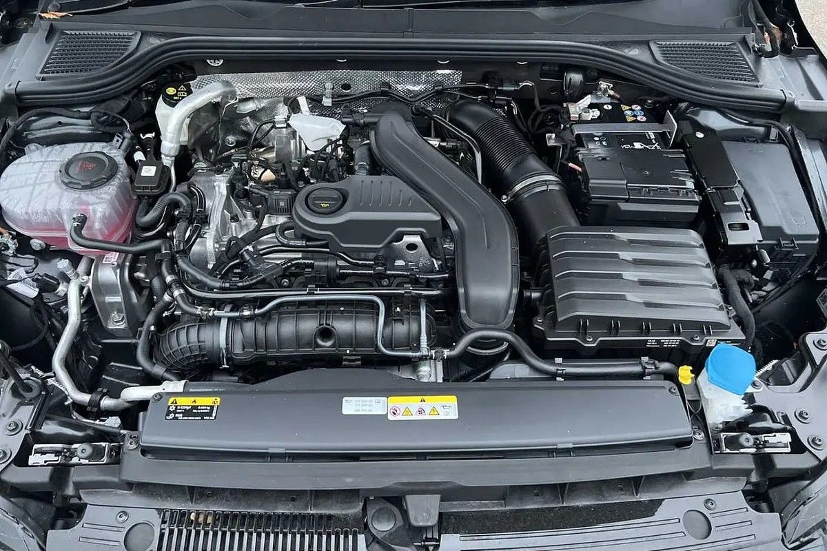

I a, not sure you can do it …as doesn’t seems to have by design ….what it needs as you may see in the picture of the engine bay above ..
I see the picture, somewhere at the cylinder head you will find a plug , if you remove the plug you can install dip stick . In Audi and BMW is like I told you , with plug .
your engine is the same with the pre facelift model which has dip stick .
Thanks I will ask about it at the dealership
ok i double check it from VW ETKA program ,
Your engine use this plug with part no: 04E115418B they have this plug at the hole where the dipstick goes.
You can install the dipstick with part no 05E115611B
