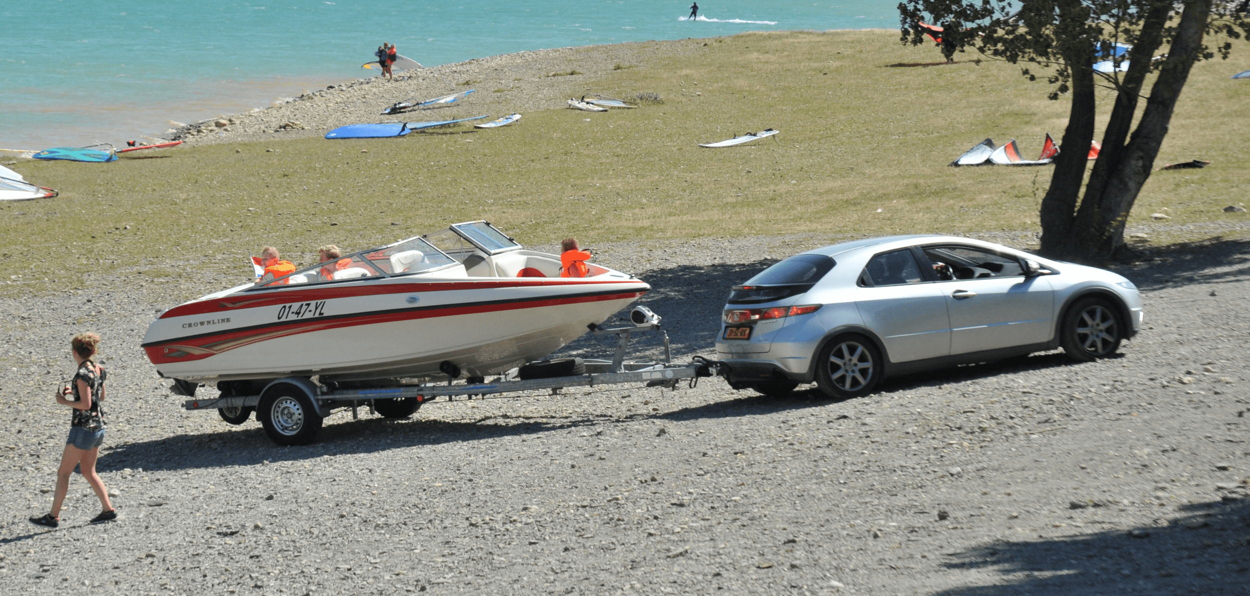

But one of the important demands is that it can pull my boat / trailer combination out of a steeper boat ramp. The combination weight is between 1400 kg (3086 lbs) and 1500 kg (3307 lbs) max.
Currently I am using my European 8th gen Honda Civic (2.2 CDTI 140 hp, kerb weight 1322 kg (2915 lbs) ) to do the job. Small hatchback car, but most ramps work fine. Sadly, in my home town there is a ramp that has a slightly too steep angle. I am able to pull it out when a couple of friends help me to push the car (sounds ridiculous, but this really makes a difference). Lots of wheelspin though, but I do not mind a bit of extra wear on the tires.
I can actually manage it with almost zero wheelspin if I heavily slip the clutch, so it's not strictly a tire grip issue, it's a torque delivery bottleneck at 0 RPM. I basically have to sacrifice and burn the manual clutch just to keep the diesel engine from stalling under that initial launch load. So I would rather have wear on the tire than burned clutch plates, though.
The steeper slipway is the only struggle I have though. I haven't had any problems hauling this combination all the way from the Netherlands through the mountains of the French Alps.
