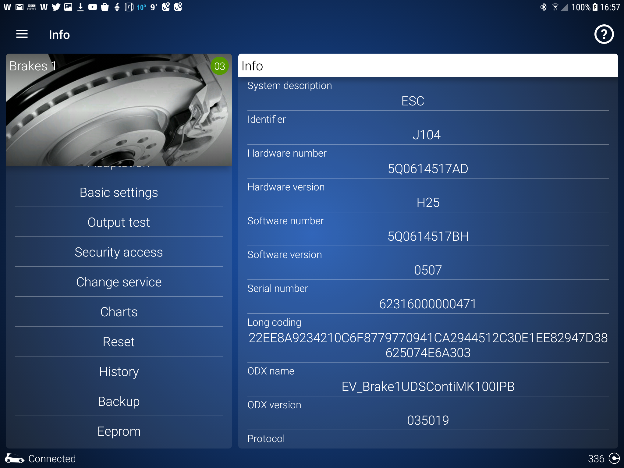

I’ve just taken delivery of a MY20 Xcellence Lux and when using auto hold the brake lights stay on.
I am trying to find a way to disable this as I know personally I hate being stuck behind a car at the traffic lights at night with their brake lights blinding me.
Not sure if the value of “7” in the field below could be changed and solve the issue. The issue is not knowing what to change it too without causing problems.
Tell
Full Member
Saw the thread and thought you had done it :).

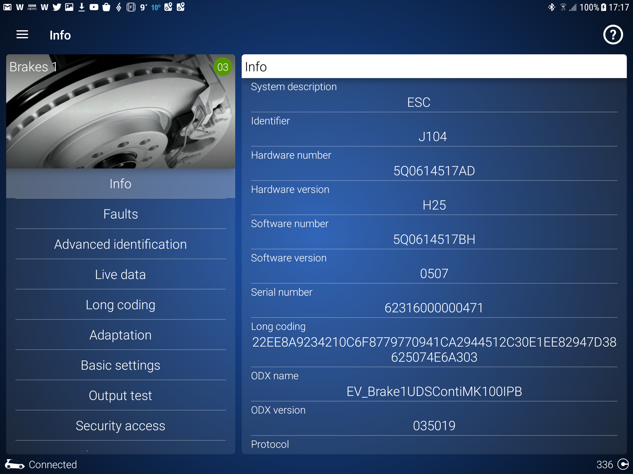

I don't think it's in the Brake 1 unit now but I may be wrong. Mine is this:
Car: Seat Ateca
Year: 2017
Body type: SUV
Engine: DFHA 140 kW (190 HP) 2.0 l
Mileage: 34722 KM
Backup
Control unit: 03 Brakes 1
System description: ESC
Software number: 5Q0614517BH
Software version: 0507
Hardware number: 5Q0614517AD
Hardware version: H25
Serial number: 62316000000471
ODX name: EV_Brake1UDSContiMK100IPB
ODX version: 035019
Backup name: Brake1
Long coding:
22EE8A9234210C6F8779770941CA2944512C30E1EE82947D38625074E6A303
Adaptations:
Tire pressure monitoring display:
Warning thresholds, tire pressure monitoring system:
Roller test bench mode:
Manual activation, possible
Running manufacturer number:
Status:
activated
Engine drag torque control:
activated
Activating and deactivating all development messages:
OFFROAD:
Offroad portion electronic differential lock:
Brake system vacuum pump:
Offset:
5
Hydraulic brake booster:
Offset:
8
Brake prefill:
Brake prefill:
activated
Braking torque boost for distance regulation:
Brake booster:
Brake booster:
Hydraulic brake assistant:
normal
Electronic Stability Program:
Speed-dependent activation:
Not activated
Brake disk drying:
Brake disk drying:
medium
Hill-start assistant:
normal
Straight ahead brake stabilization:
activated
Brake pedal evaluation:
activated
Seat belt buckle scan:
activated
Dynamic starting assist:
normal
Driver door status:
Driver door status:
activated
Automatic application during engine stalling:
activated
Starting vibration reduction:
Strong
Torque limitation:
Deactivated
AUTO HOLD functionality:
Not activated
AUTO HOLD increase threshold, reduced tensioning force:
0 %
AUTO HOLD increase threshold, full tensioning force:
10 %
Developer_Function_1:
Monitoring of functional lights:
Indicator light in the button for electromech. parking brake:
7
Indicator light in AUTO HOLD button:
7
Vehicle and trailer stabilization:
Trailer information evaluation:
Not activated
Roller test bench mode, functional:
Not activated
Overboost in brake system:
activated
Electromechanical parking brake:
Driver presence recognition via brake pedal:
Not activated
AUTO HOLD functional status:
Personalized settings:
Last setting
Tire pressure monitoring display, tire selection:
ABS in lower speed range:
activated
Thresholds for brake performance:
activated
XCP calibration protocol:
Not activated
Advanced identification:
Number of programming attempts:
Bootloader:
Application:
Maximum number of possible update programming:
Bootloader:
100
Application:
1000
Identification of connected components:
ID number:
subsystem_name:
Brakes 1
Bus message/node address:
13
Workshop code and date of last update programming of SW module:
Year:
Month:
Day:
Device number:
Importer number:
Dealership number:
Programming status:
Correct result
Year:
Month:
Day:
Device number:
Importer number:
Dealership number:
Programming status:
Correct result
Subassembly and series number:
0471
Date of last coding:
Year:
16
Month:
9
Day:
19
FAZIT-identification:
Manufacture location index:
TT1-0CA
Day of manufacture:
18.08.16
Manufacturer- test stand number:
0101
01D7
Manufacturer's test stand number:
0101
Manufacturer code:
TT1
Diagnostic mode:
VW - diagnostic mode
VW/Audi part number:
5Q0614517BH
SoftwareVersion:
0507
Supplier identification:
436F6E74696E656E74616C2054657665732C204775657269636B657374722E20372C203630343838204672616E6B66757274
Date of manufacture:
Year:
16
Month:
8
Day:
18
Serial number:
62316000000471
Hardware part number:
5Q0614517AD
System description:
ESC
Adaptation workshop code:
Device number:
18
Importer number:
770
Dealership number:
33281
Date of last adaptation:
Year:
Month:
Day:
ASAM/ODX file identification:
Parameter set part number:
Parameter set version:
ASAM/ODX file version:
035019
HardwareVersion:
H25
Vehicle equipment code:
FFFFFFFFFFFFFFFFFFFFFFFF
Coding workshop code:
Device number:
31
Importer number:
770
Dealership number:
33281
System abbreviation:
J104
Versions of software module:
Bootloader:
0005
Application:
0507
Number of possible access authorizations:
Programmability status:
Programmability:
programmable
Program consistency:
Program present
Coding:
ISO TP block size in bootloader:
f

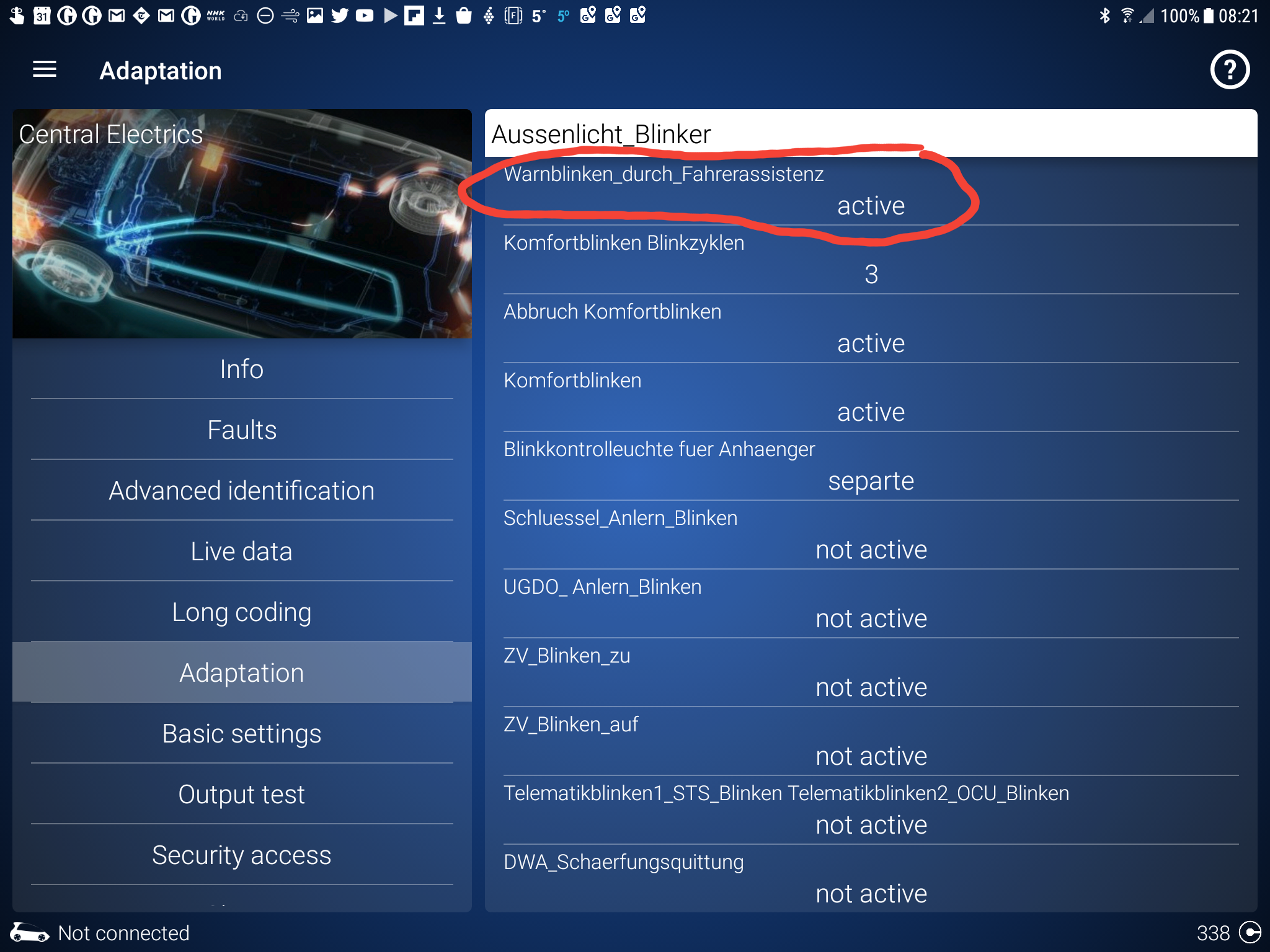

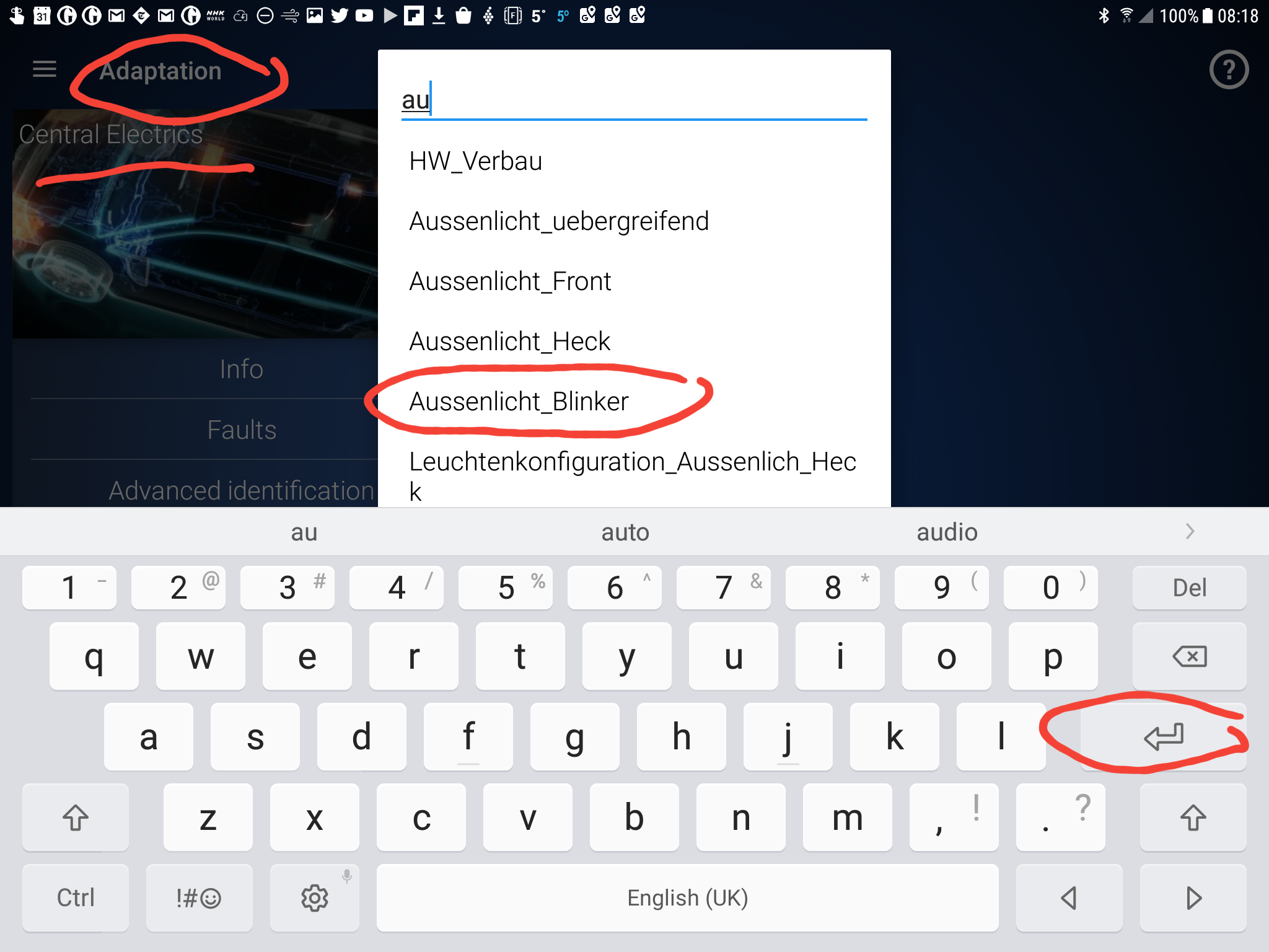

It could be in the Central Electrical (9). I had a go in 2017 working out what these were, post 14:
https://forums.seatcupra.net/index....f-activity-working-ones-for-the-ateca.438134/
Theory being that the control information is sent to the rear lights and it's told what to do with them but I could be wrong.
In this group (my informed name against list - which could be wrong):
Leuchte 20BR LA71 - Left outer tail
Leuchte 21BR RC8 - Right out tail
Leuchte 22BR MA57 - 3rd Brake Light (centre)
Leuchte 23SL HLC10 - Left Inner Tail
Leuchte 24SL HRA65 - Tail light
Leuchte 25KZL HA59 - License plate light
Leuchte 26NSL LA72 - Rear fog
Leuchte 27NSL RC6 - Rear fog
Leuchte 28RFL LC11 - Reversing Light
Leuchte 29RFL RA64 - Reversing Light
Leuchte 2SL VLB10 - Daytime running lights left (headlights)
Could be somewhere else in the Central Electrics. Needs a month of Sundays. Always troubling when I find my own posts in Googles like I'm the only one at it. Working out the other Adaptations in Central Electronics may reveal it or a suitable Google in German :)
Ateca Feststellbremsleuchte vcds
Could be they just don't want you to do it.

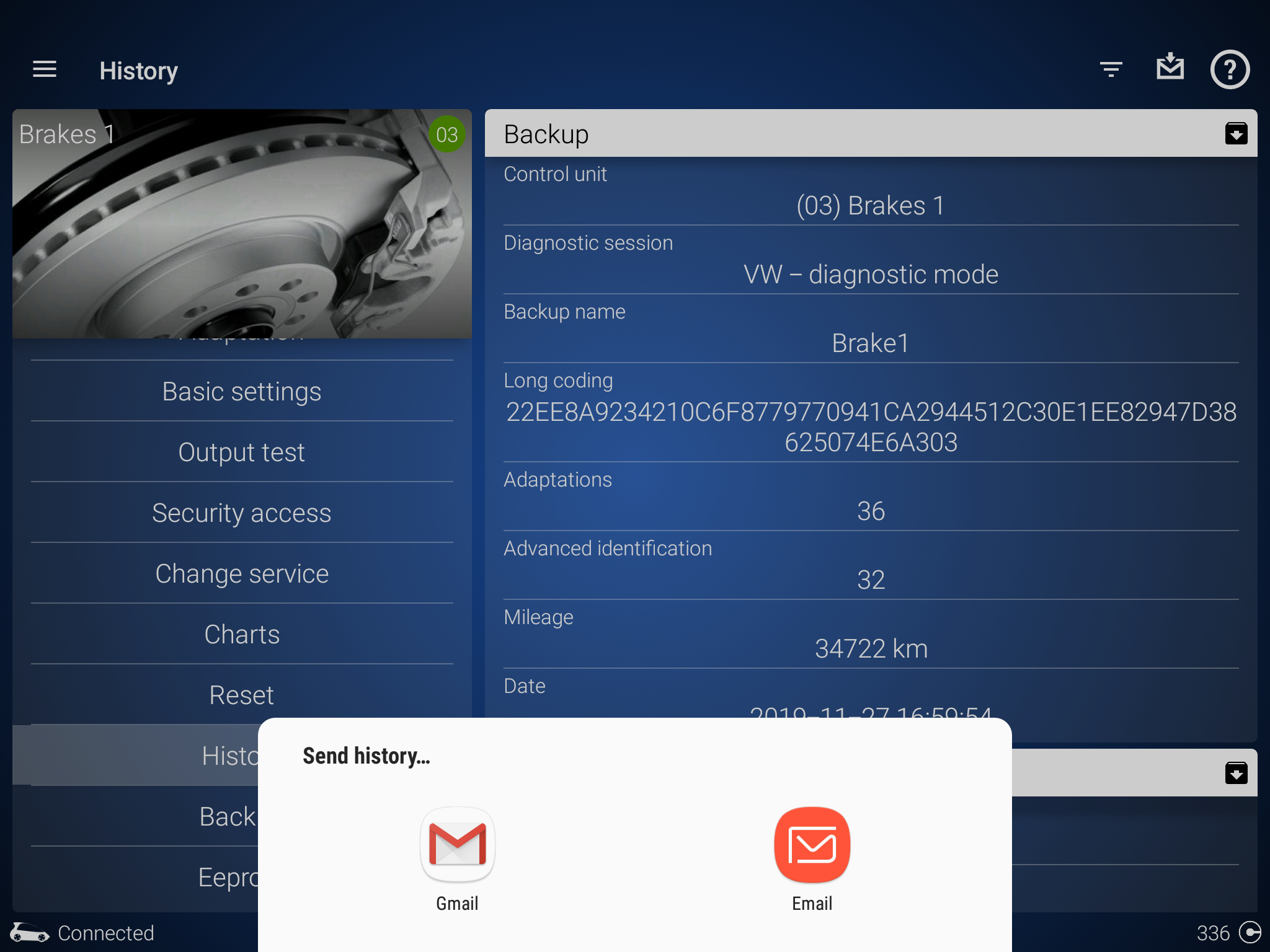

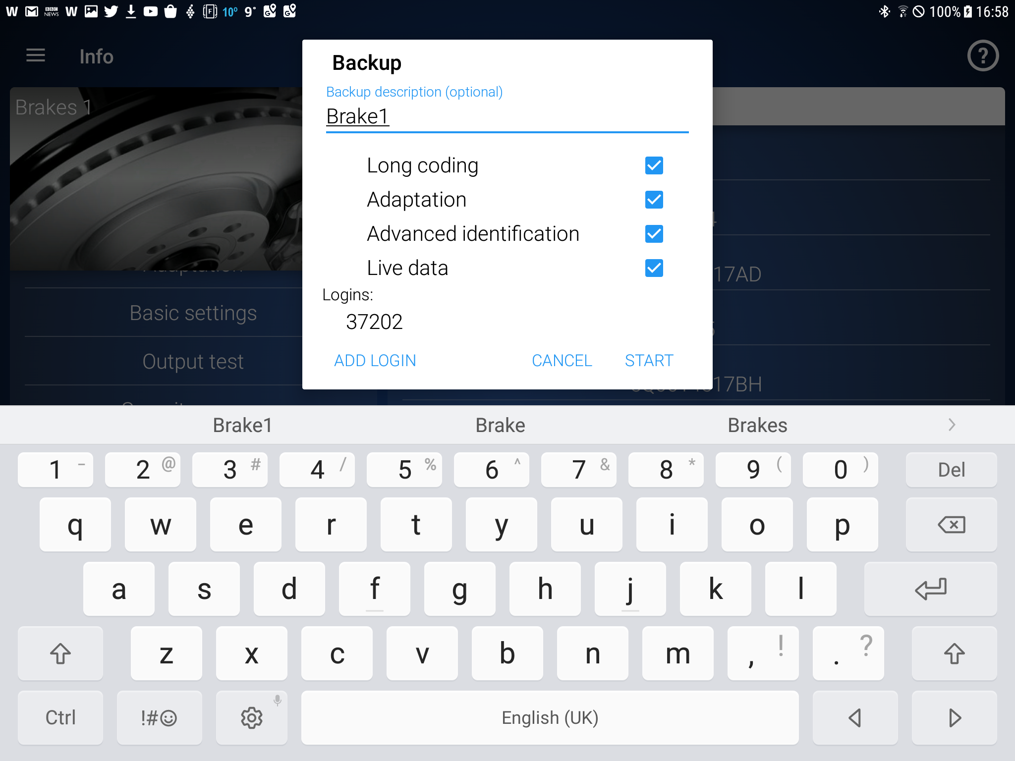

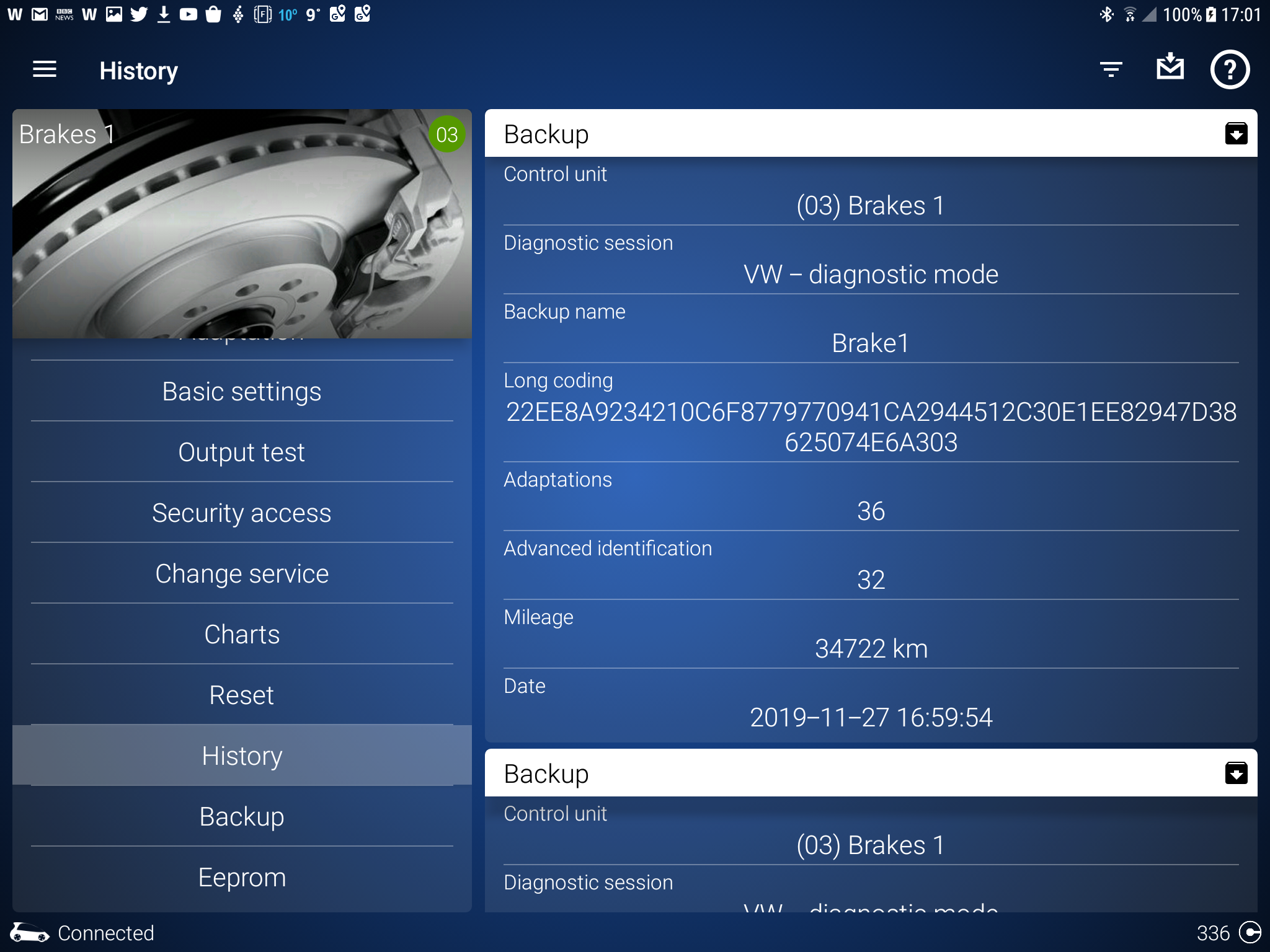

That last log is done via a backup within the module and emailing it too yourself. Click the email icon. You could check each line with yours, just in case something is different. You get a txt file emailed back to yourself.
Agree not much on the internet except people noting differences and being tribal. Then they discuss the systems. Ateca packages all of these together. I got park assist as well, that may or may not have a bearing.
One post did say that the address map for it was not provided by VAG ie. They don't provide a method of adjusting it's behaviour.
BTW you are suppose to do a big back up via the home screen. Restore is manual... history menu always shows you what you have.

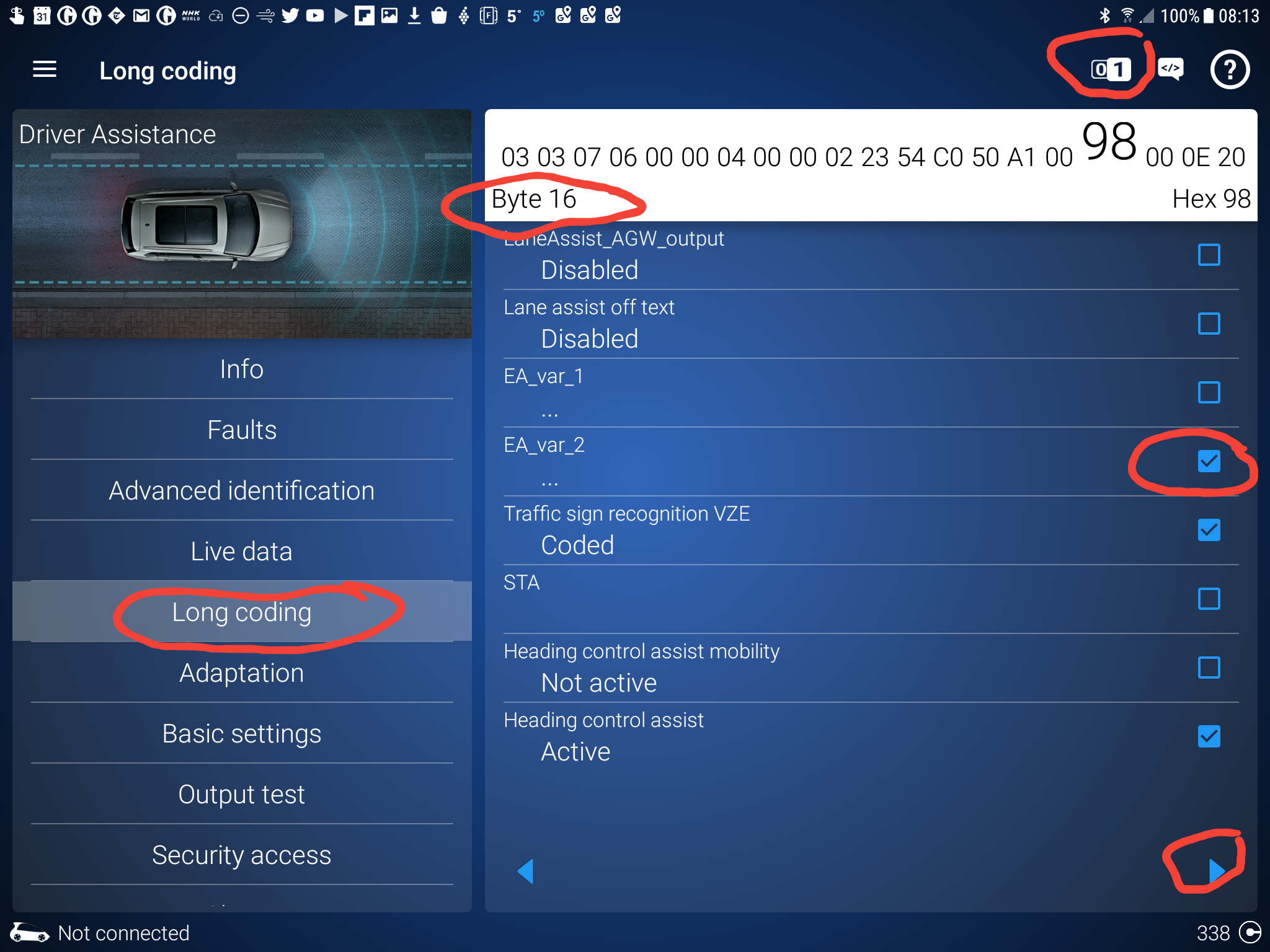

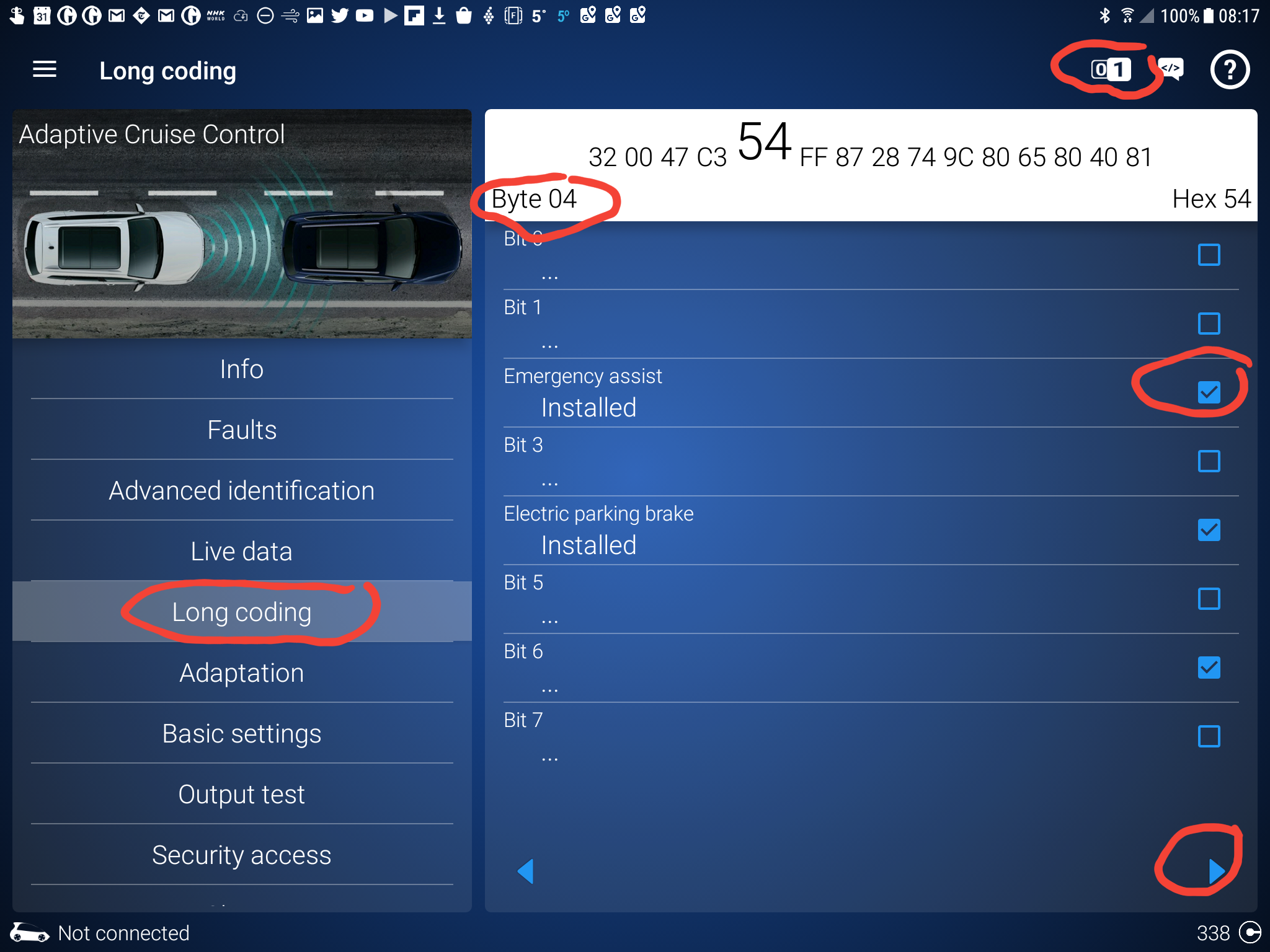

You'll have better luck long coding TSR in via post 65
https://forums.seatcupra.net/index....vity-working-ones-for-the-ateca.438134/page-4

In my reading so far of that thread to 128
https://www.vwwatercooled.com.au/fo...cific-features-au-spec-tiguans-117741-13.html
They have
Adaptive Lane Guidance
  1. Go into Module A5 Front Sensors Driver Assistance System
  2. Select Coding, and change Point of Intervention to Early (Setting Via Menu)
  3. Click on "Accept", and use 20103 as the security access code.
  4. This enables Adaptive Lane Guidance as a menu option under Driver Assistance - Lane Assist.
Which was off Irish cars but on my UK one. Stops Lane assist weaving. You see it as a separate line on the display. They must have thought Ozzie roads were like Irish ones and the road markings wouldn't make it work.

To activate TJA, just upload TJA parameters through VCP, and then follow the steps below with VCDS?
A5 > Coding > Byte 16 > set Bit 2-3 to "08" (EA_Variant2)
03 > Coding > Byte 29 > enable Bit 5
13 > Coding > Byte 04 > enable Bit 2
09 > Login: 31347 > Adaption > Channel "Außenlicht_Blinker-Warnblinken_durch_Fahrerassistenz" > set to "active"
To upload the parameters, just use the Upload function and select the TJA file?
When you perform the procedure, will all settings in module A5 be maintained or reset?
The Ateca (mine) with TJA does indeed have those parameters. You could try them as long as you reset them back if it doesn't work. Although you might be lacking the rest of the software in the unit.
Byte editor on the first three, channel adaption on the last.
Other evidence on this link they say a front assist camera ending with 654... mine does, that's shown as the hardware number. Obviously other cameras may have different number now that would work with it but if yours did end with 654 that would be good.

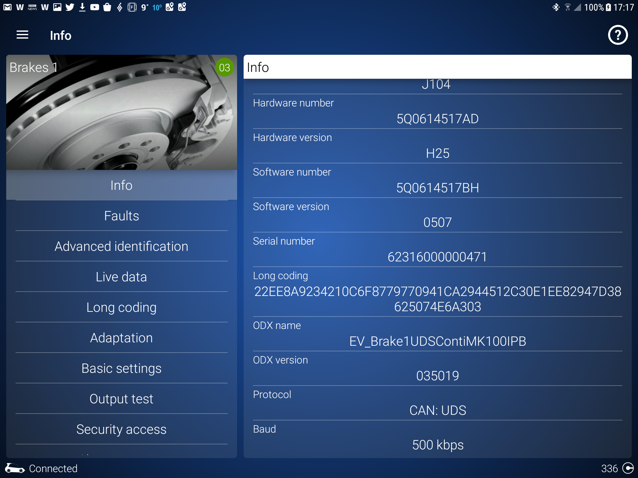

I would be a bit careful. People have messed things up in Brake 1 with some of those test, workshop items. I much prefer somebody to say what a mod does than just try it out.
Basically how it is at the minute the parking brake doesn't come on till the door is open / exit etc then you hear the motor run to pull it on. That's what happened the other day so it's holding it on the brakes even thou you haven't got your foot on it. All that stuff explained on the threads.
Might go back through my 2017 emails to see whether I have my settings from then via a backup in case the dealer did update them. You wouldn't see that in the Obdeleven history file, just your mods I reckon.

My brake 1 long code Jan 2017 then twice this last month. Looks identical. So if it did change it changed somewhere else.
