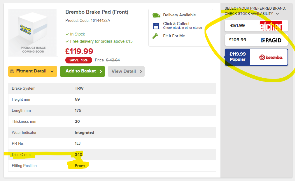

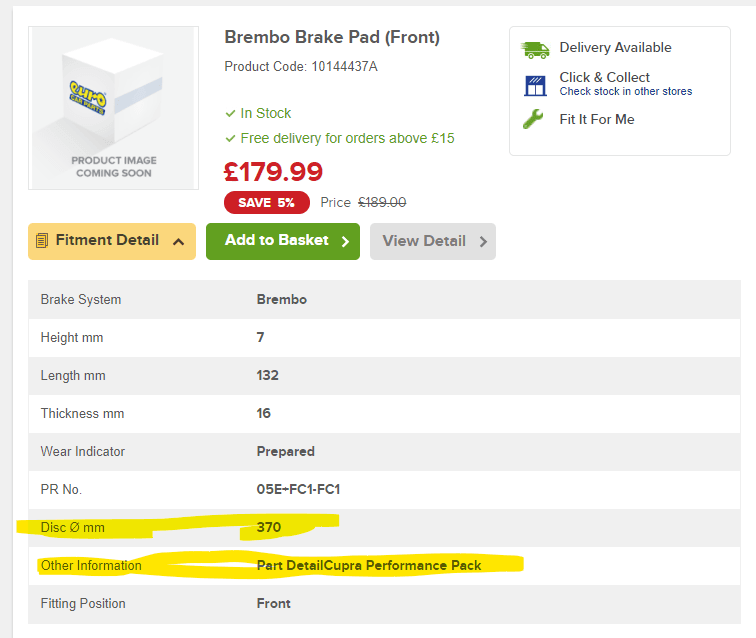

Just had a look myself.
The £179.99 Brembo pads are for the 370mm 4 Pot Calipers, not the 340mm standard setup...
The £119.00 Bremo pads are the correct Brembo setup:

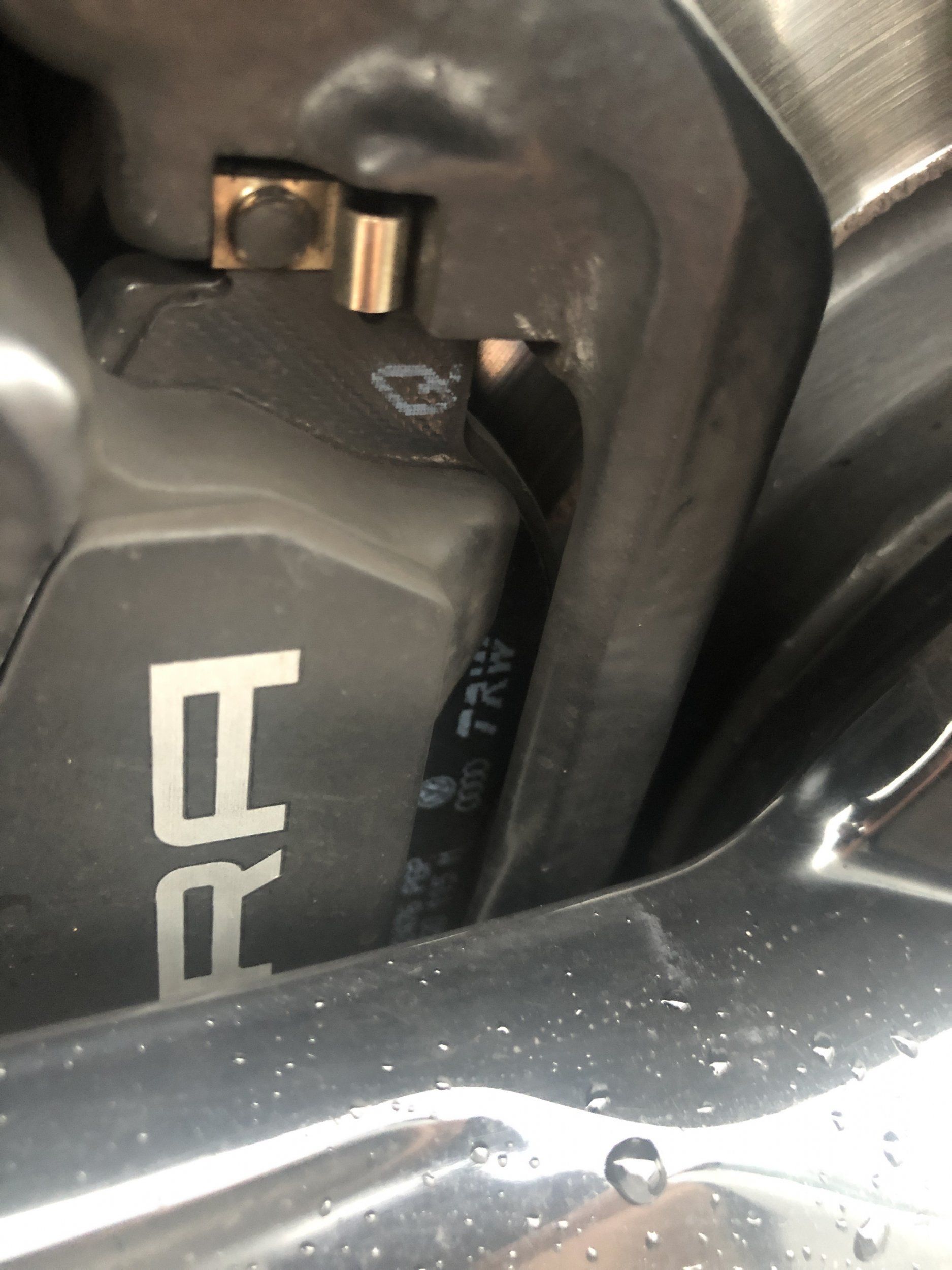

TRW are stamped all over the Cupra, FR front and rear callipers and on the OEM pads - excuse the filthy car; still pouring down!
Ate are fitted widely across VAG too, and occasionally there is a mix with TRW front and Ate on the rears, especially on Seat/Skoda lower hp models.
