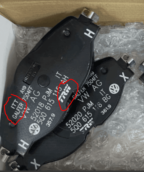

TRW are the OEM brake system/caliper supplier - but not the PAD supplier. They do not make OEM pads.
Same with ATE, Brembo, Bosch etc..
Personally I would but from pad friction lining producer.
For discs I would just get any coated disc with R90 approval - as this gives a reasonable max machining tolerance limit.
Interesting. Who is it that makes the pads then?

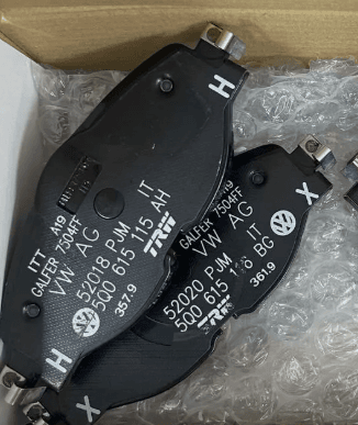

TRW and ATE are amongst the brands on OEM VW group brake pads...
Reactions: Mo_86
So in both of your examples - ITT Galfer is the OEM pad producer.
Galfer is one of the bigger OEM manufactures.
7504FF is the OEM friction material.
TRW, and ATE on the second pad are just the brake system/caliper manufactures. As I said - they do not make the pads.

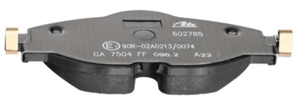

Correct.
Another OEM variant produced by Jurid! This one is harder to see - Jurid hard marked in the centre.

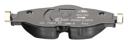

The ATE version of this same pad is 13.0460-2785.2 - and if you search for images (below) you can see the same friction code 7504FF as the OEM in this instance.
Trouble is - I can find OEM pads selling for similar prices to this ATE pad!

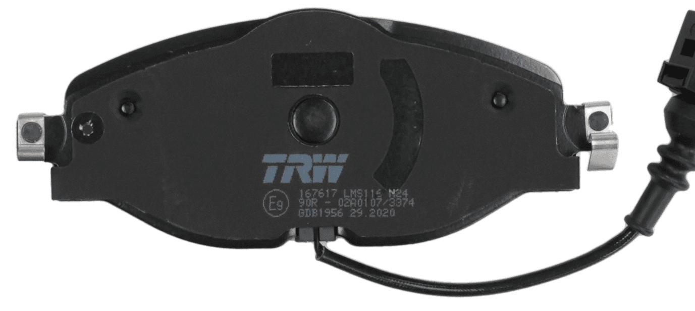

TRW version - try and find similarities with any OEM pad!
