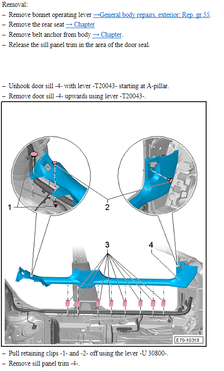

Any idea how to remove bonnet operating lever ?? (Sill, first step.)
I need it for change of footrest for stainless steel VW R style.

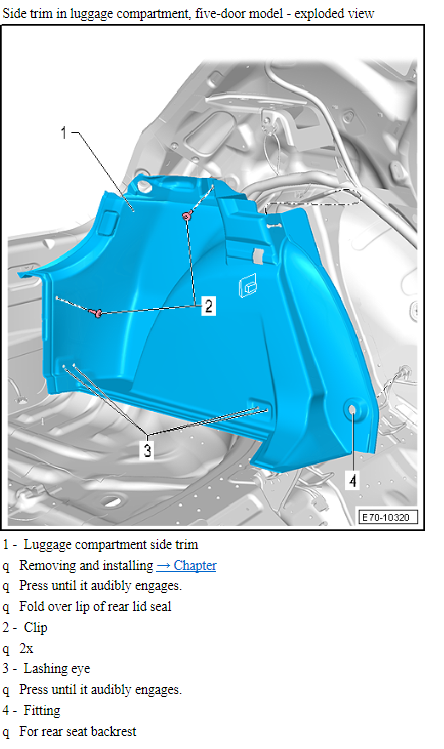

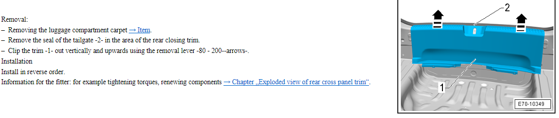

simmo1 - you wouldn't happen to have the diagram/instructions for removing the boot trim on a ST, please?
I'm particularly interested in the carpet that goes around the wheel arches.
That just pulls off, start at a corner by the boot glass then work your way around.

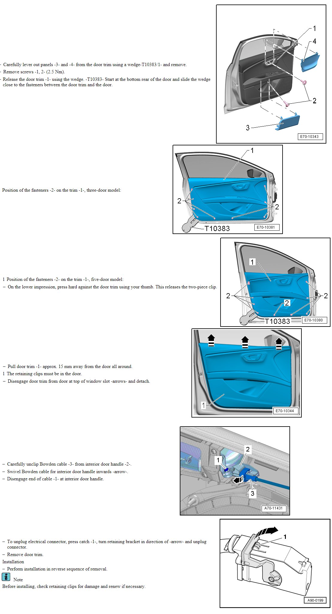

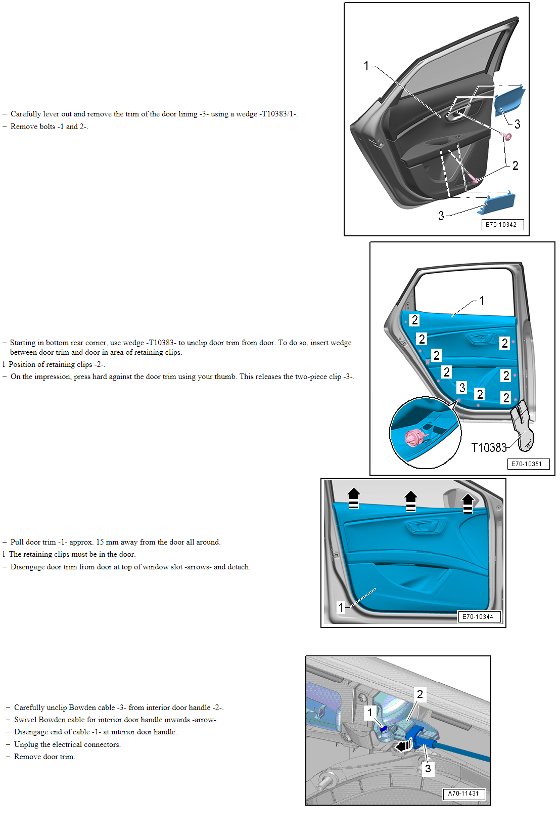

Yeh I saw that one, but it contain everywhere, but the door itself
