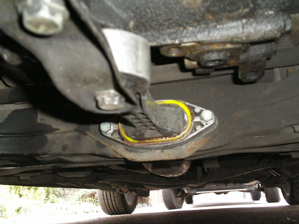

after a 300bhp upgrade had dogbone fitted by amd and has made massive difference to the car and traction. worth every penny and good advice to get done,,,,,,, thanks shaun
Yep thats the monkey mate!
Should look something like this on the car;
