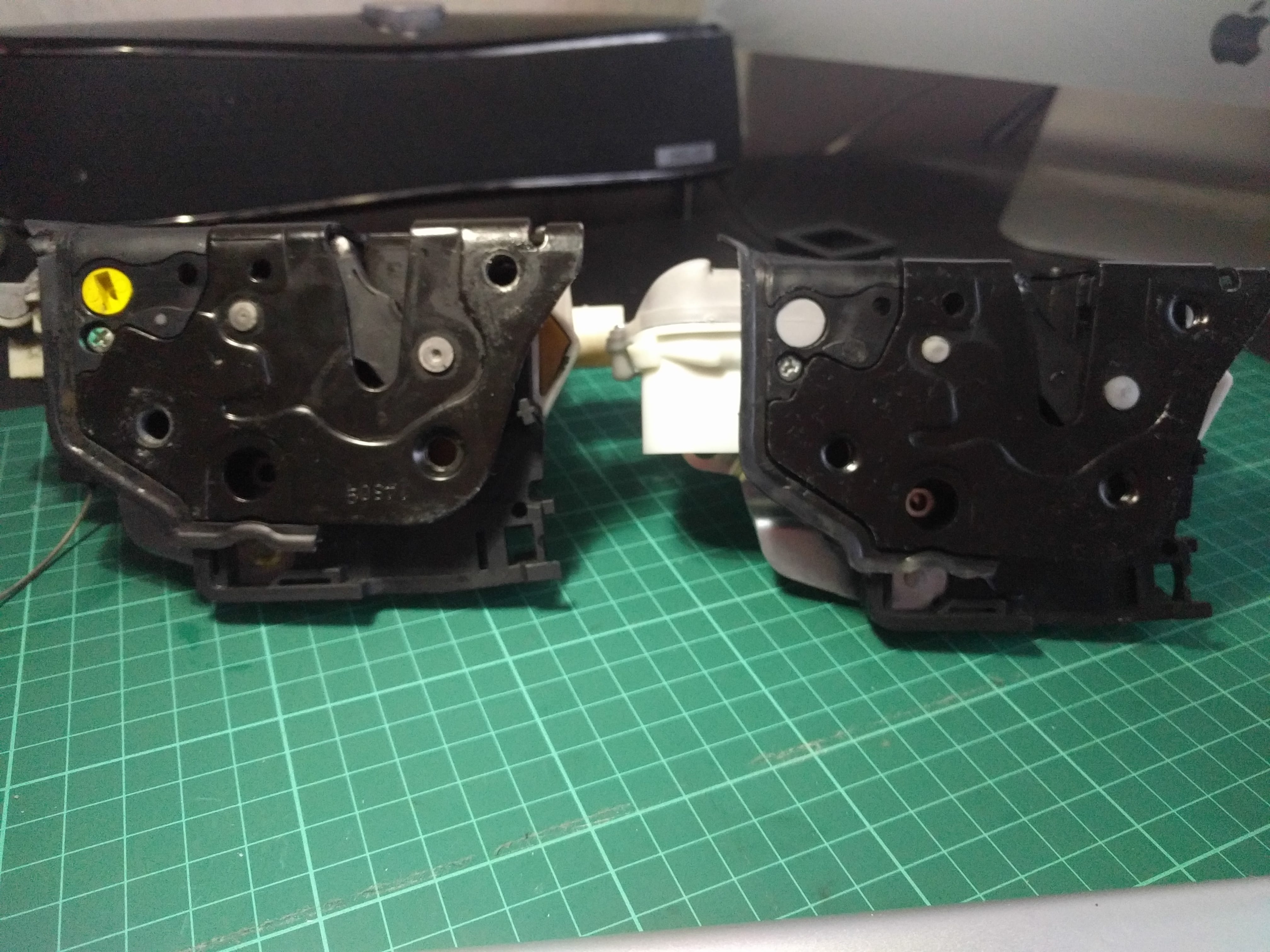

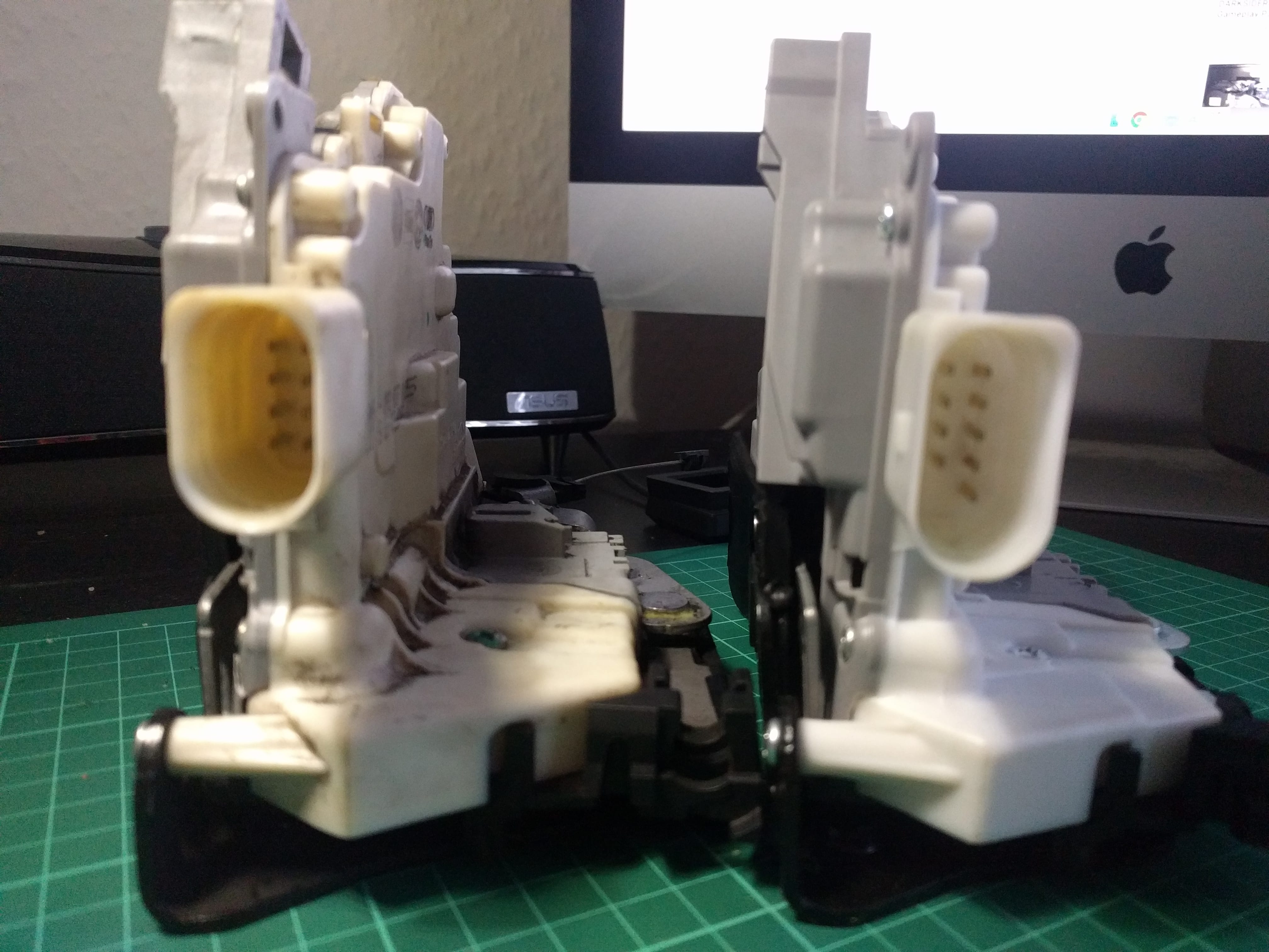

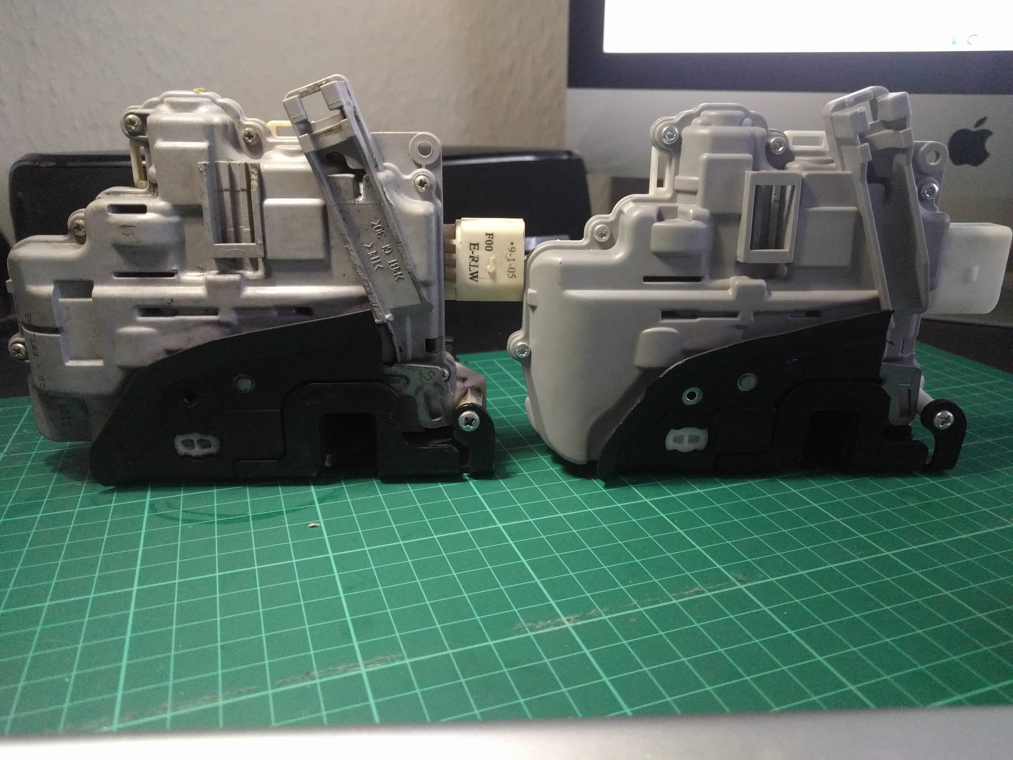

so below is a fellow photos and a small guide to changing a euro module with a uk module
for the 1p2 door lock module
first few photos
as you can see they are different
but they go together well and happy

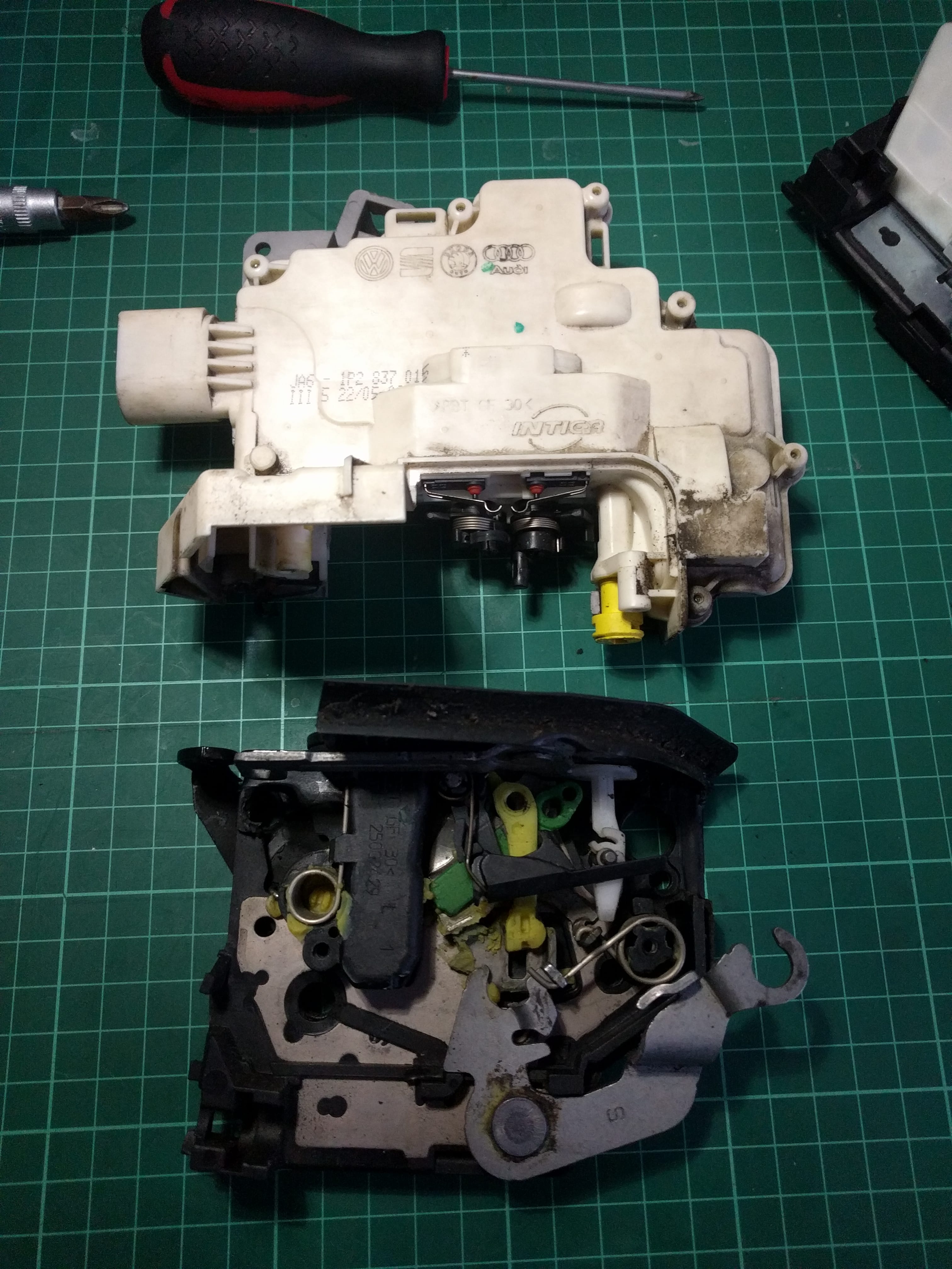

all you need is star head / torx t10 and a flat metal spudger tool

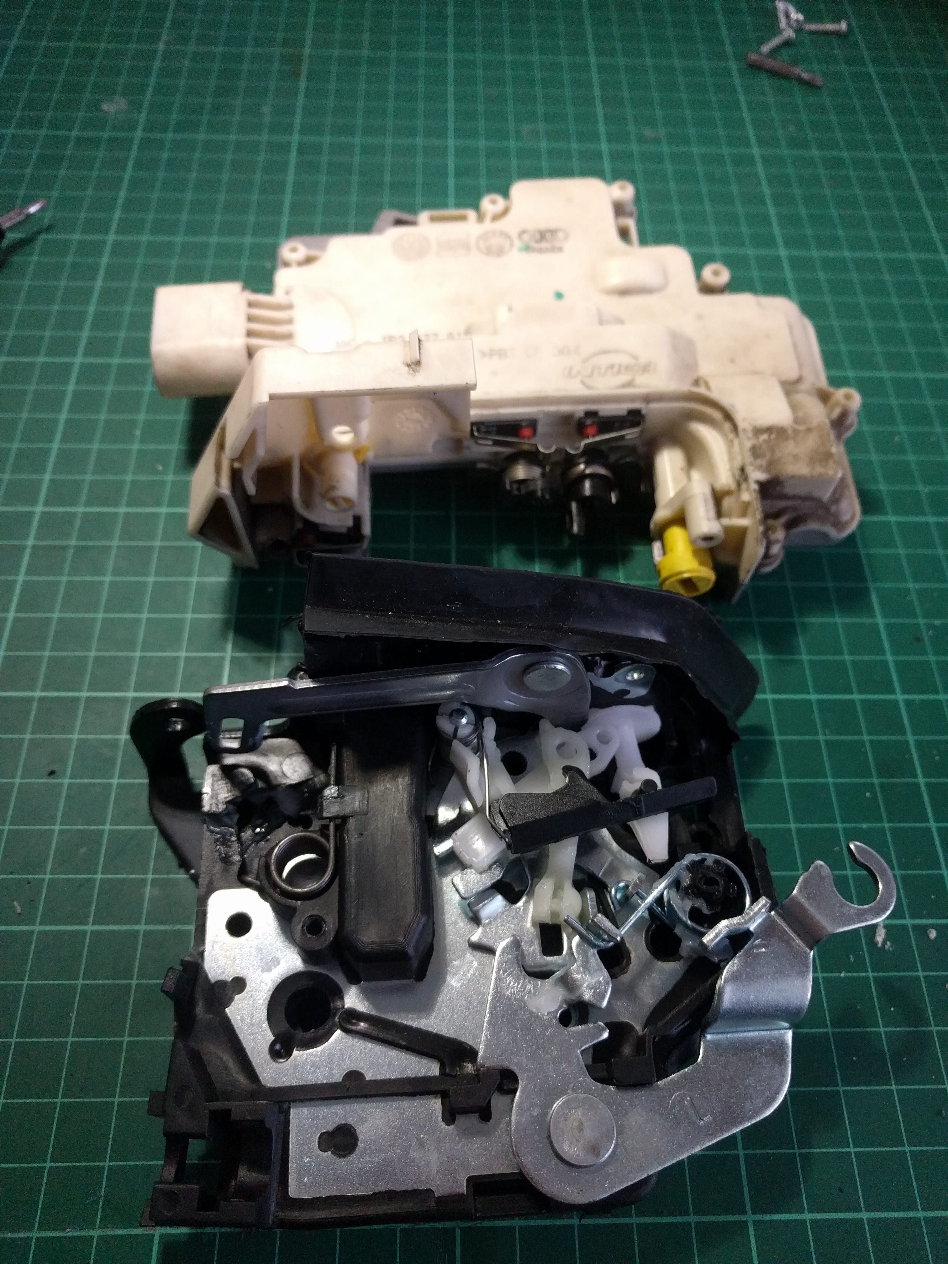

first of remove the dark grey cover. it only has one has one star head in it. pull the latch open and remove the cover
remove the next 3 star head screw holding the base to the top section
at this stage to can left the plastic section a small amount above the metal. dont pull to hard. as there is two plastic clips holding them together and this is it.
use the flat metal spudger tool to pop them
here they are here
you need to pop the green and yellow bars from the clips in the top section
there is a spring in each of them, and you dont want them to pop out if you can, just adds extra work.
so thats the two sections part from each other

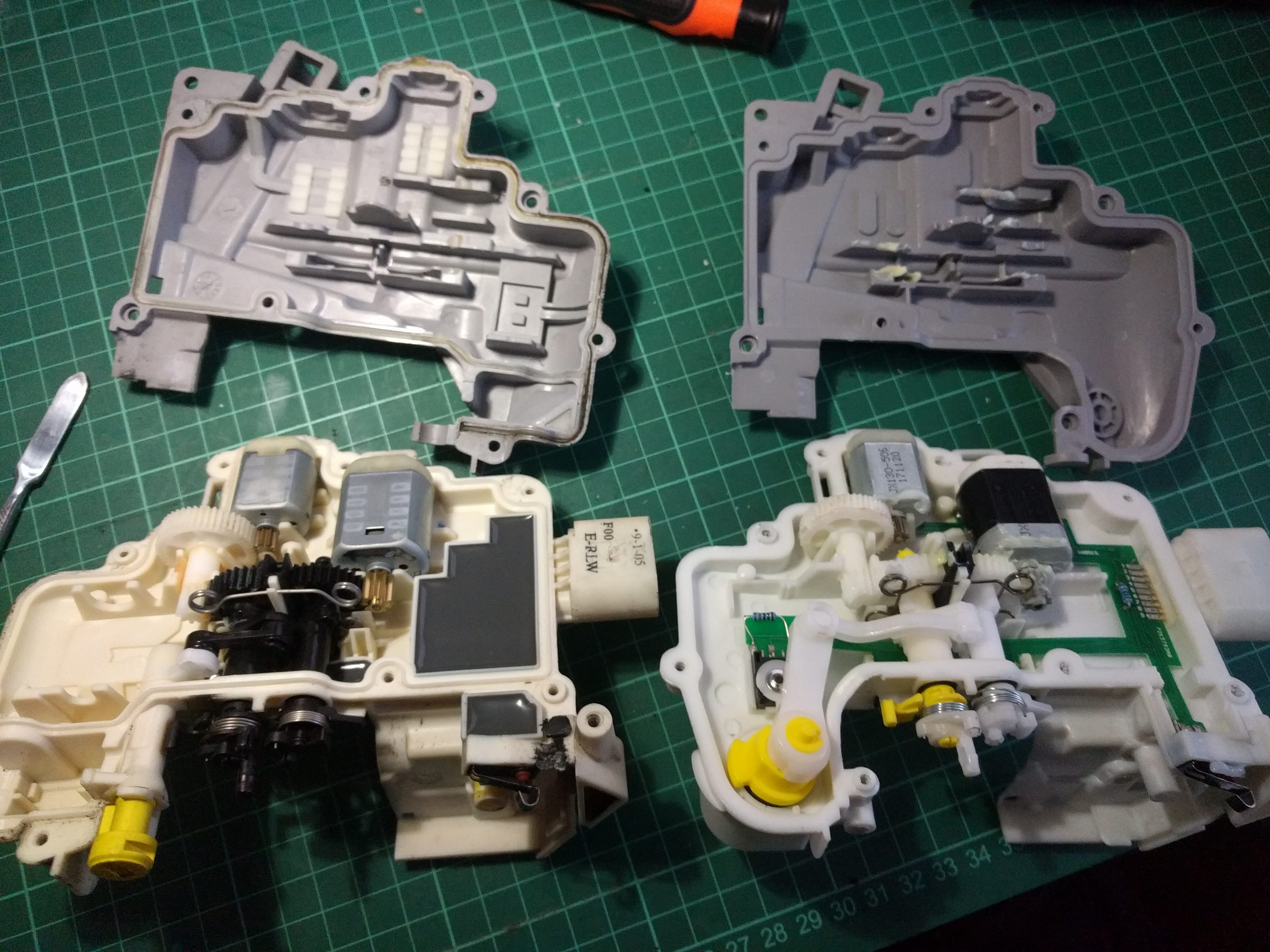

now on to the top plastic section
there is 8 torx t10 screws in this
un do them and put them to the side
you need the flat metal spudger tool again. go around the edge and separate the two plastic sections
dont go pulling this apart to fast
place the light white plastic down on your table. everything is in this section. so thats grey side up
remove the top grey section and you well see the insides
this is where you will start to see the difference really

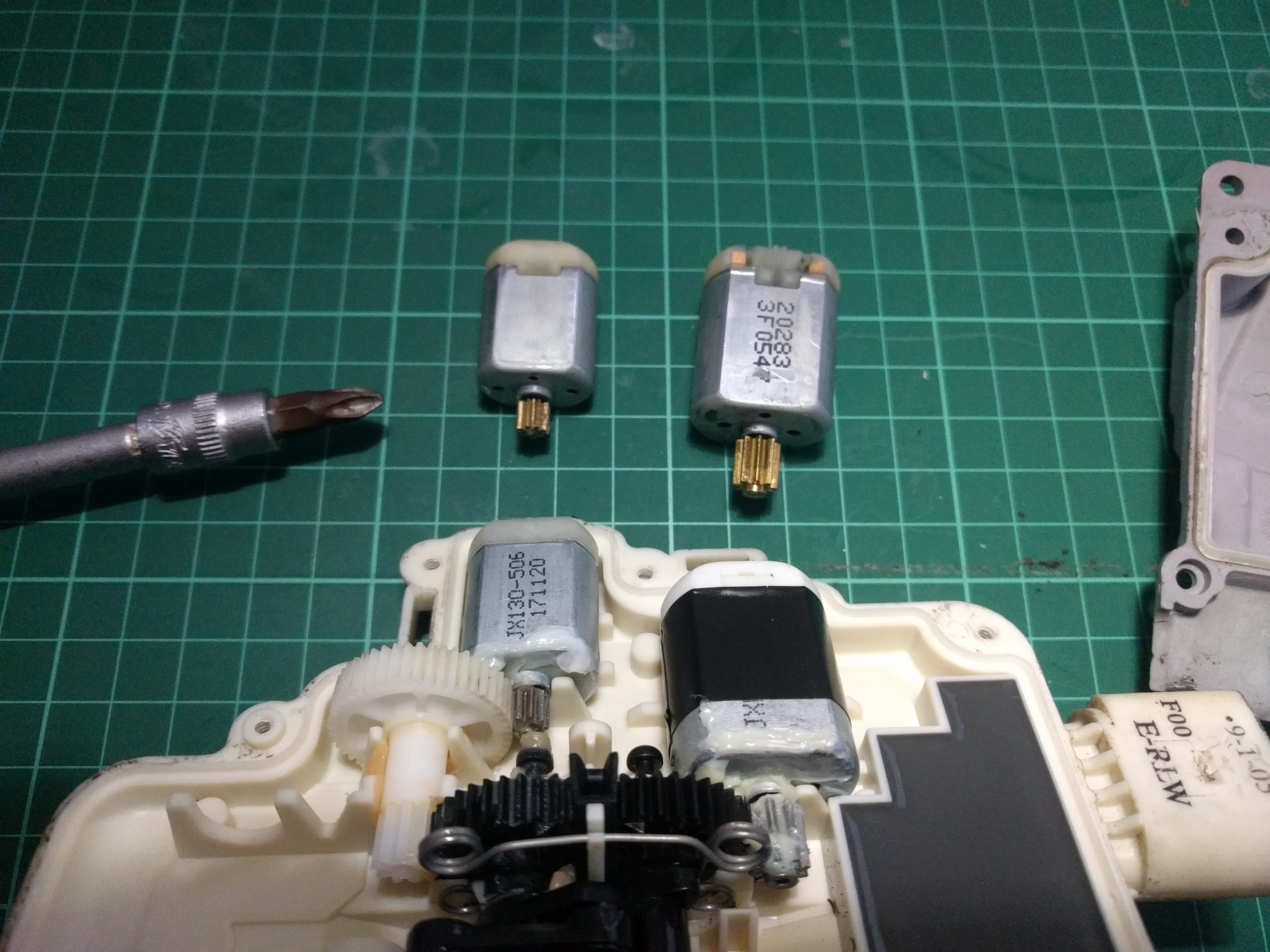

but the added new bits in the new lock are not needed
for this guide im only changing the motors
so you need the flat metal spudger again and your finger
so what your looking to do is
place your finder on the middle metal open spring towards which side your locking to remove the motor from
then take your flat metal spudger tool and lift up the motor. on the replace module the circuit is just on the service, so the motor clips might come with it. just pull them out
repeat for the second motor and try not to move the inside bits just to be safe
stephen
Dec 4, 2018
82
10
part 2
once the motors are in and if you want to add some more grease or the likes go ahead
new motors in and out with the old

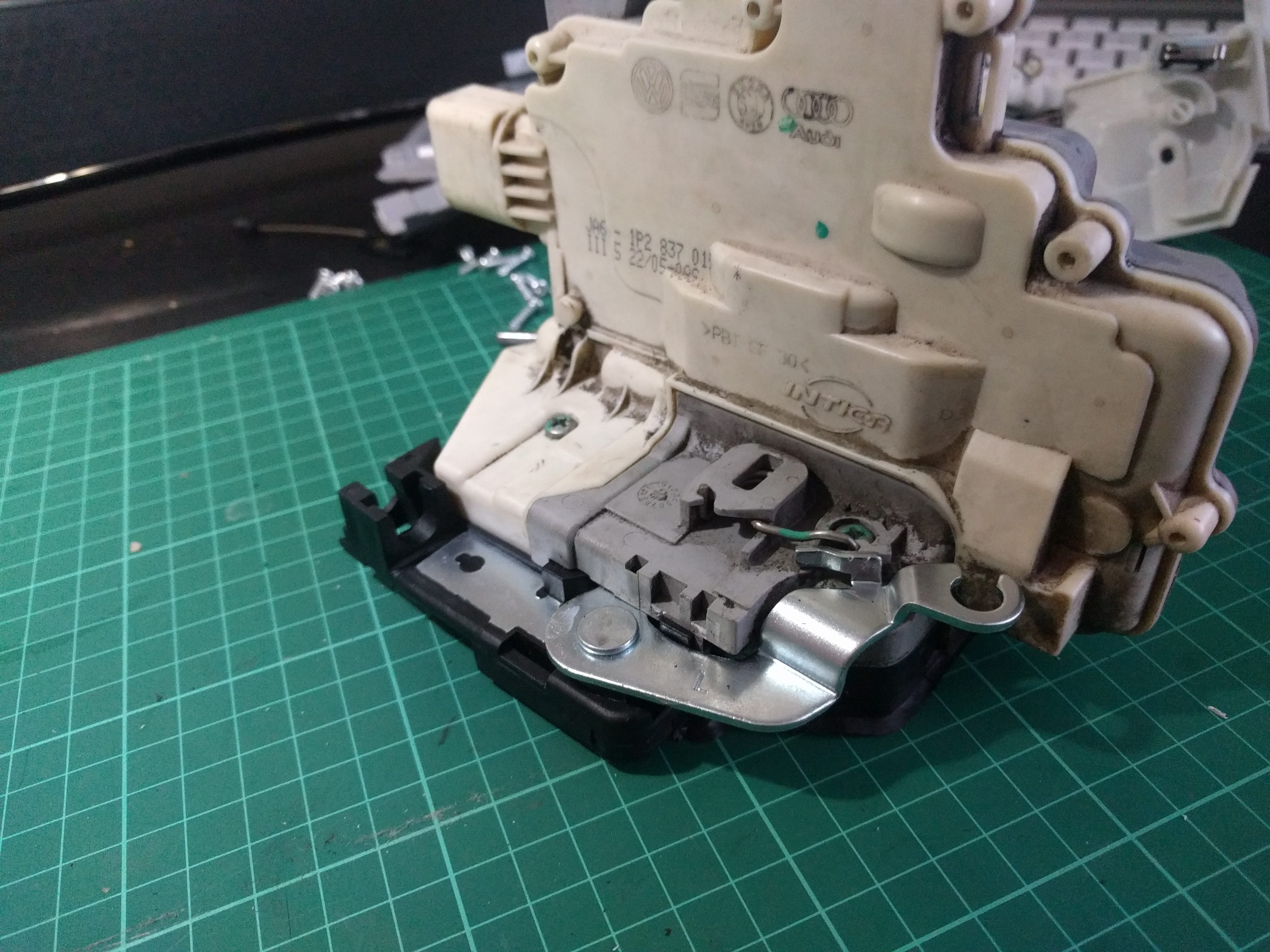

next up is the last hard bit. you dont have to use the new metal section but i wanted to might as well change them

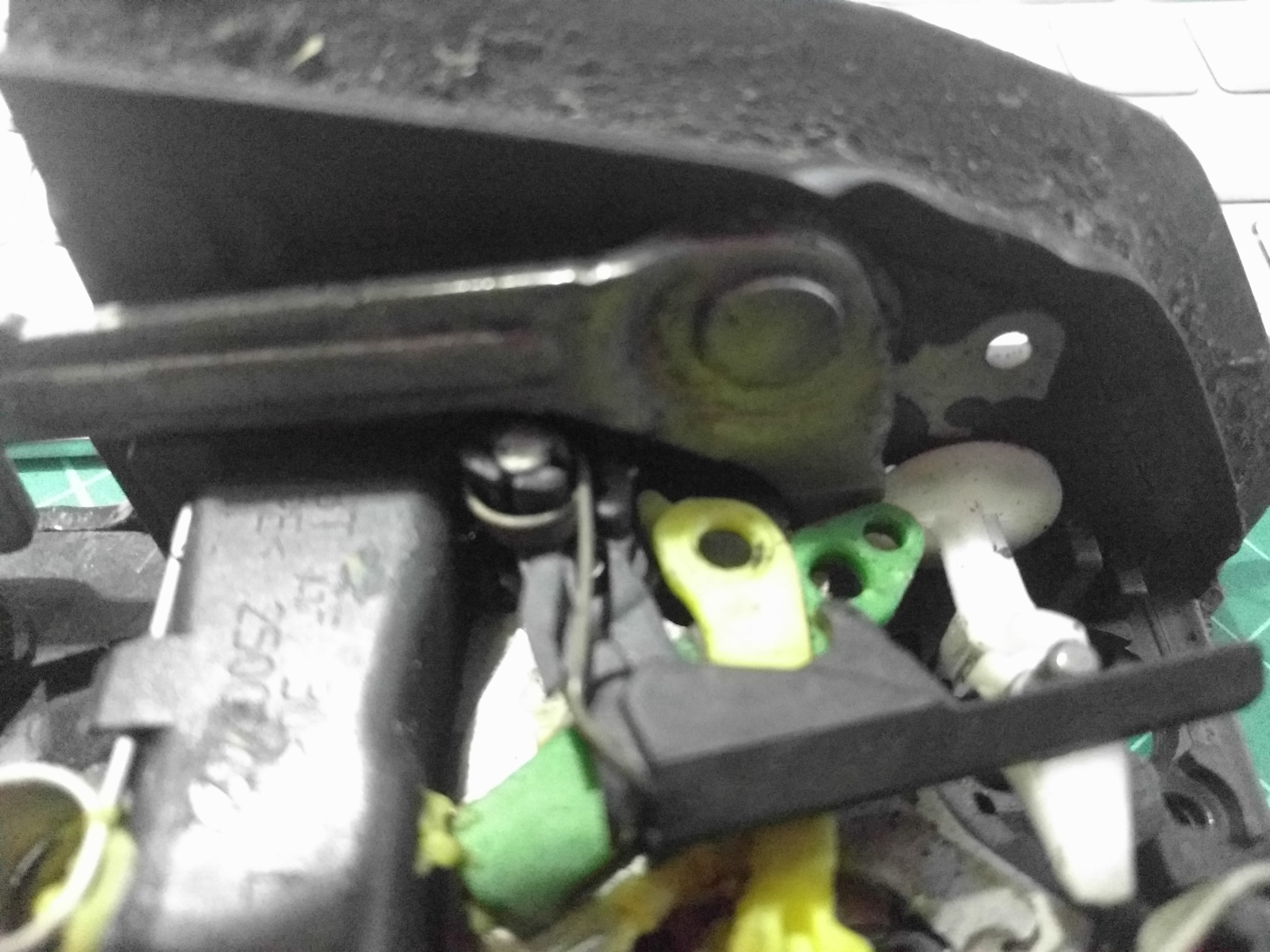

so take the top plastic section and put it back on top of the lower metal section
you will need open the out side door handle pulley, you can see it in the last photo
pull it open and lower the plastic on to it
remember the two clips you removed from the yellow and green bars from the old
well you need to reline them up and and use the flat metal spudger tool to lift them up
it might take a while to get them lined up but dont worry the old will go in to the new
i find it easier to do the lower one, as it more in your view than the top one
so line up the lower one and pop it in
line up the top one and pop int in
you will need to push the top section down as you do it
or put the top screw and screw in it a bit at a time to close the cap
once you have the two clips in make sure the black plastic arm on a spring in front of the clips is in the right place in front of the plastic peg and on top of the are
