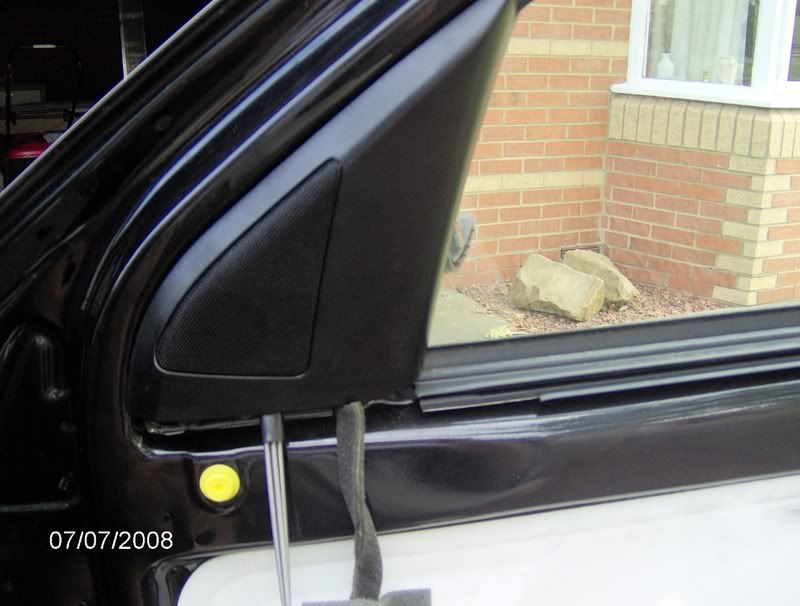

2) Next youll need to remove the small speaker in the corner of the window shown below:
3) It should just pop out if you pull it at the top:

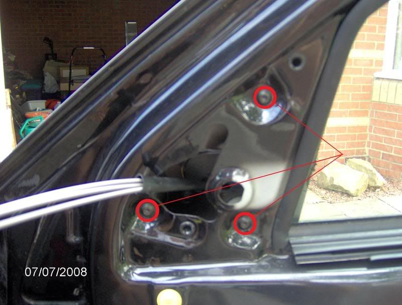

4) Then just unscrew the three star headed screws circled in red in the picture and the back plate should come stright out.

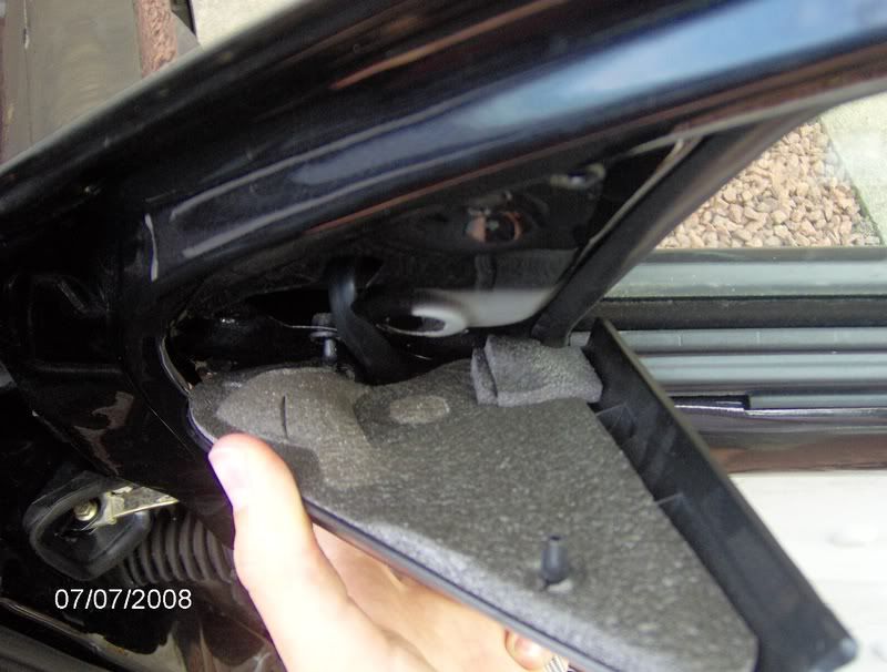

5) Finally just unclip the attachment for the mirror position lever from the door card and hey presto. all done.
