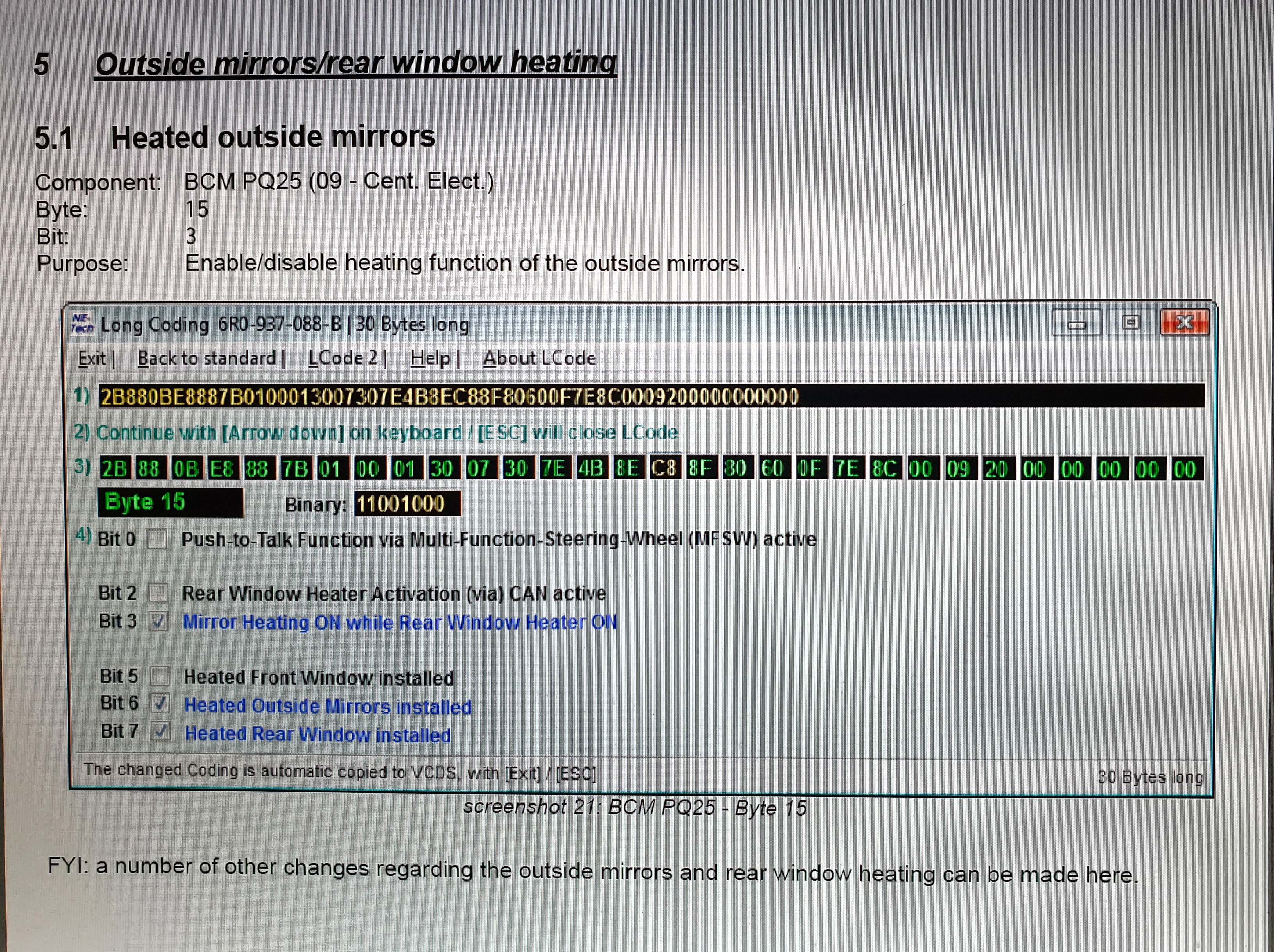

Can I just confirm....
If I want the left hand mirror to auto-dip on reverse, I need to have the switch on "L".
If I want the heated mirrors to, well..., heat, I need it switched to the top-right position.
But I can't have heated mirrors AND auto-dipping, without having to change the setting each time?!
No. Also stupid that you need to manually switch off the heated mirrors. A much more sensible arrangement is a button that activates the heated mirrors for a preset time only. That way you don't have to try and remember to turn them off, which I have forgotten to do several times.

Heated mirrors should be on with HRW in my opinion. This action on my last cars (Nissan and Honda) so never forgot to turn them off as I keep doing now.
Don't know if this will work, I have not had a chance to try it (also don't know if I have that option),
