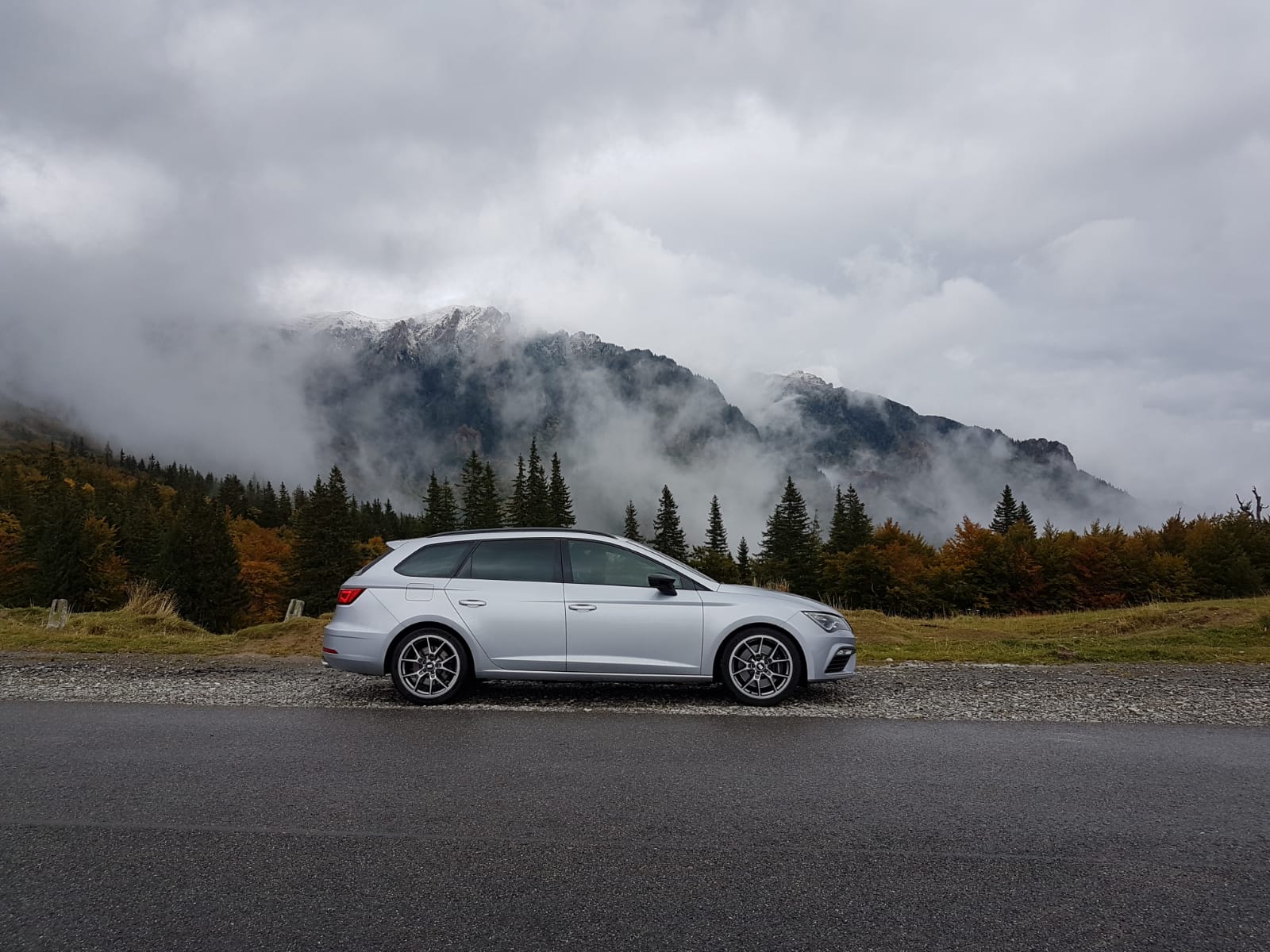

Besides the weight reduction and comfort increase, a strong reason to change the rims was that stock rims did not accommodate the bigger brakes (the bigger width was the problem, not the height) and I didn't want to use spacers. Neuspeed rims are very good at clearing big brakes, but they are also pretty expensive...[/QUOTE]
What rims are you using?

I did go with one of the big tuners: MRC (the local branch).
I think the big tuners do not advertise stage 2 or stage 3 for GPF cars, but if you contact them they will probably do it. For example, if you look at MRC's Facebook page, you'll see that they also tune GPF cars.
I'm not sure the missing port injection affects stage 3 performance, I'm more worried about carbon build-up on the valves. From what I know port injection is used mainly at low RPMs and direct injection at high RPMs, so the impact should not be big if at all. I would also be interested to learn more about this subject.
The limit to 460 HP could be because we used the TT V3 turbo (less powerful but quicker spool compared to TT V4 or V5) or because I said from the beginning that I prefer a rather conservative mapping to minimize risks.
Mods on the car are:
- Racingline R600 full intake;
- Racingline oil management system;
- Wagner intercooler;
- TT V3 turbo + uprated sensors;
- Milltek 76mm full exhaust (with racing cat and resonated);
- LOBA HPFP;
- NGK R7438-9 spark plugs;
- Audi RS3 8V coils;
- StopTech BBK 355x32mm slotted;
- Neuspeed RSe10 lightweight rims (I downgraded from 19" to 18" for better road comfort);
