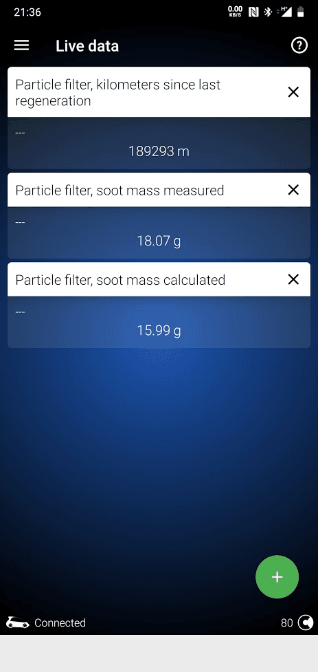

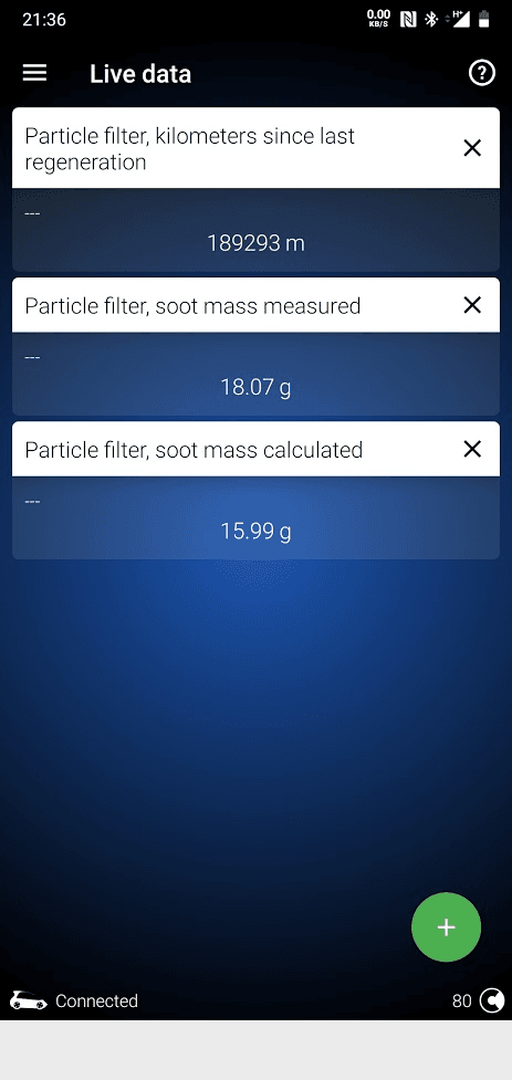

Caught the car in the act. First picture is just after I had got to work this morning, commute on motorways for approx 65 miles. The second is just as I was leaving, and it had started a regen. This happens all the time, I've just never been able to catch the exact moment in screenshot.
Can anyone see any issues with the figures on each (aside from the ludicrous jump in soot load). Would a dodgy sensor be the issue here?

Good work on catching that. Based on my experience, your first screenshot looks perfectly `normal` and then on the 2nd one the car thinks you suddenly have a full DPF.
I can only think (based on my limited experience and Google-Fu) that the DPF pressure sensor is faulty. That measures the airflow/pressure through the DPF and calculates the soot load based on that. If the sensor is `detecting` limited airflow, it thinks the DPF is full and needs a regen.
Can't say for sure but from what I've read that's how it works. There are probably other sensors but not sure if they influence the DPF readings.

The bottom line is that something in your car is telling it that a DPF at 37% is suddenly full and that's not right. The good news is, you have a nice clean DPF!
You could try to swap out the sensor (c.£25+your time) but I can't say for sure that's it. I tend to work through the cheaper/easier options and go from there. No idea on your desire to get your hands dirty!
Got to be a sensor issue for it to think the soot mass has gone from 8.27g to 22.7g in 1 mile!

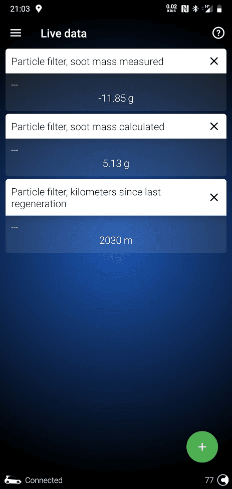

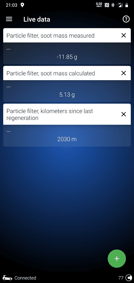

After a regen the soot mass measured goes to -11.85 and calulated to about 4.9-5g.
