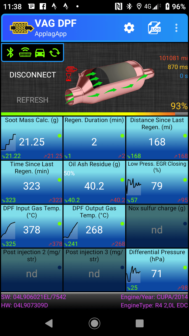

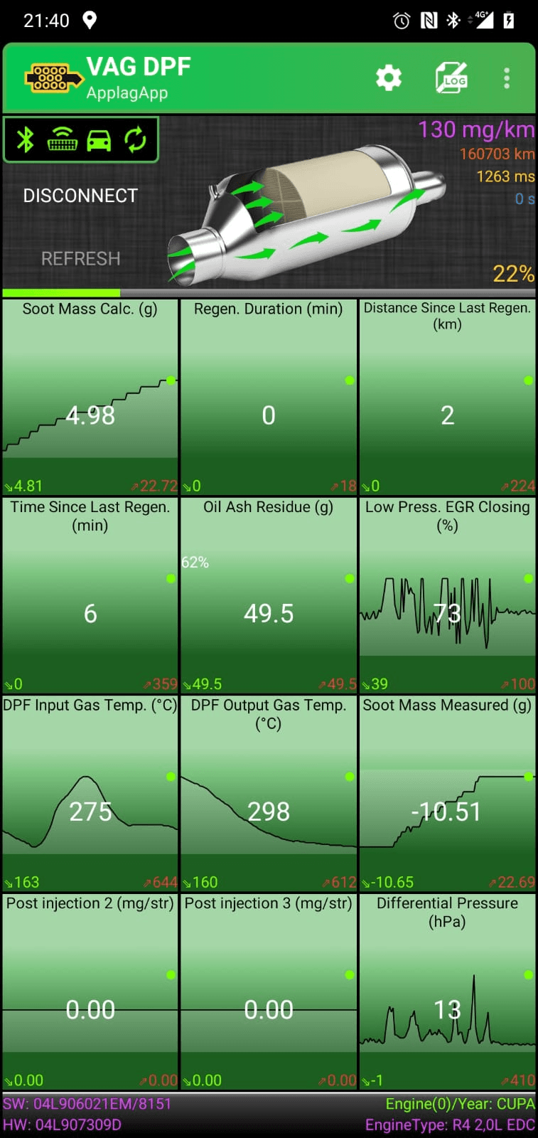

Would still be helpful to know your current ash value from VAG DPF.

Just after a regen:

Thanks - the reason I asked is that my 184 has done 100,000 miles and my Oil Ash Residue is 50%, whereas yours is 62%. I'm wondering whether your car has done either a higher mileage - based on my cars figures, your car has 124,000 miles worth of ash residue. Or that due to more regular regens your car just produces more ash. Either way, the DPF will reach it's end of life sooner than it should.
Have you thought about an engine carbon clean? I had one done and they also do a full diagnostics. Really good for checking that all the other sensors were working as they should and helps you understand why you might be getting an early regen. You can see from my figures that my car did a regen after 168 miles.
I don't know what is causing your car to regen so often but something doesn't sound quite right. Has it been run on premium fuel?

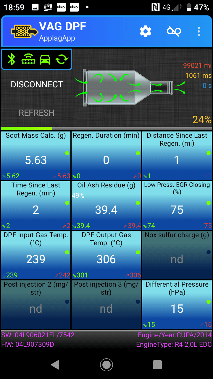

@Brian Gordon-Stables can you please post a picture after regen when idling? I want to see what your differential pressure is like. Thank you!
Yeah - no idea how ash content works but just increases a tiny amount after each regen, hence my rough calculation v's mileage.
This is an older screenshot of my car post regen. I'll get a newer one when I take the car out and will post that later.

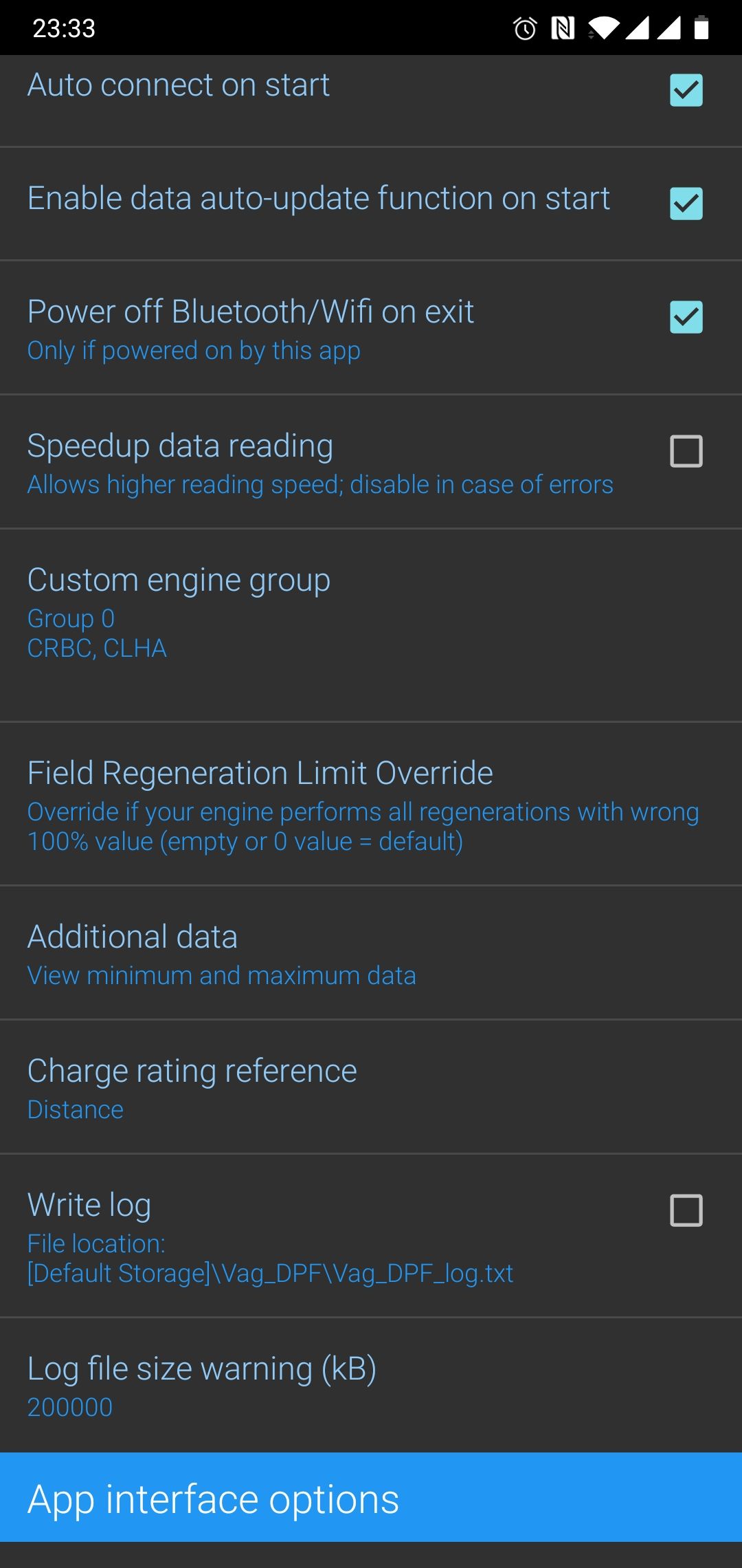

Yep. Maybe if you can check it right after a regen for a correct comparison
As a trick you can put VAGDPF to monitor for group 0 CRBC CLHA to show you soot mass measured also.

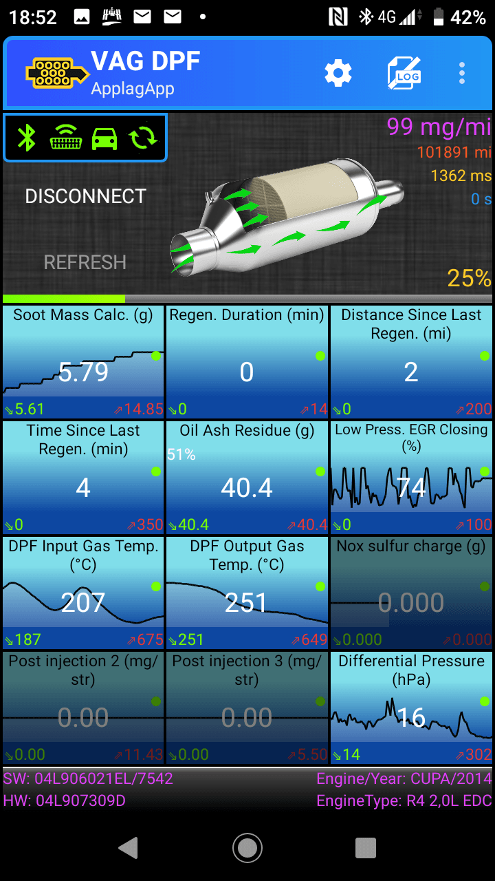

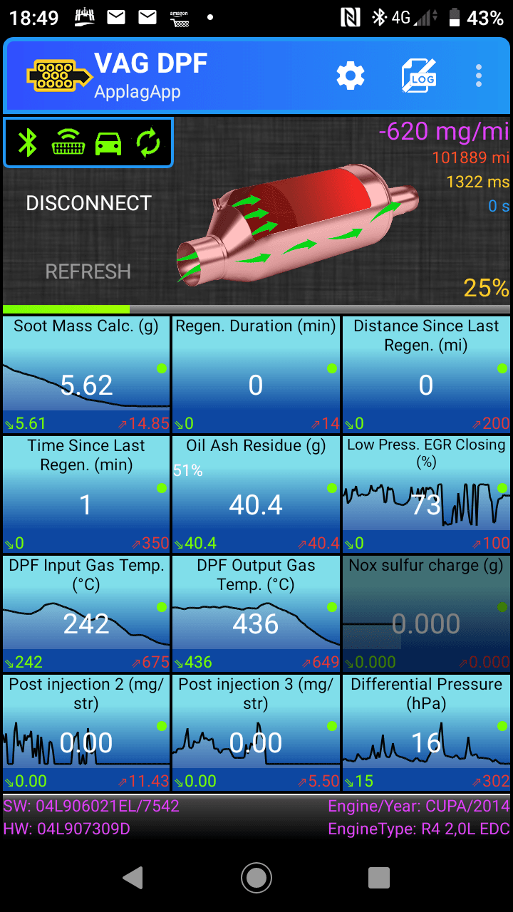

@Brian Gordon-Stables did you monitor after a regen the diff pressure?
Not yet - I did a 550 mile journey last week and it did a regen at 220 miles (more than my usual 180 with local driving) and then 190. As I was on the motorway, I wasn't in a position to monitor the idle diff pressure. Next time is regens when I'm driving locally I'll be able to check and let you know.

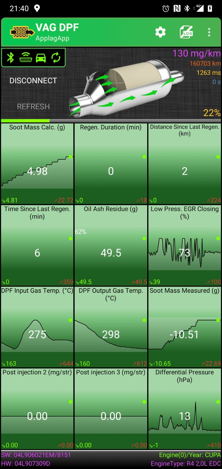

So you have roughly the same differential pressure as me but I should have more oil ash. Can you try the trick I said to put group 0 manually and check measured soot?
Maybe after 50-80 miles ?

Small update on my side. Changed injectors/ cleaned dpf and still I get the same behaviour.
Soot mass measured shoots up the roof if I m driving slow. Either a bad sensor doing havoc or overfueling at slow speeds.

Did you clean your dpf after repairing the engine ? If not your dpf is full of ash.
What is the diff pressure after a regen ?
