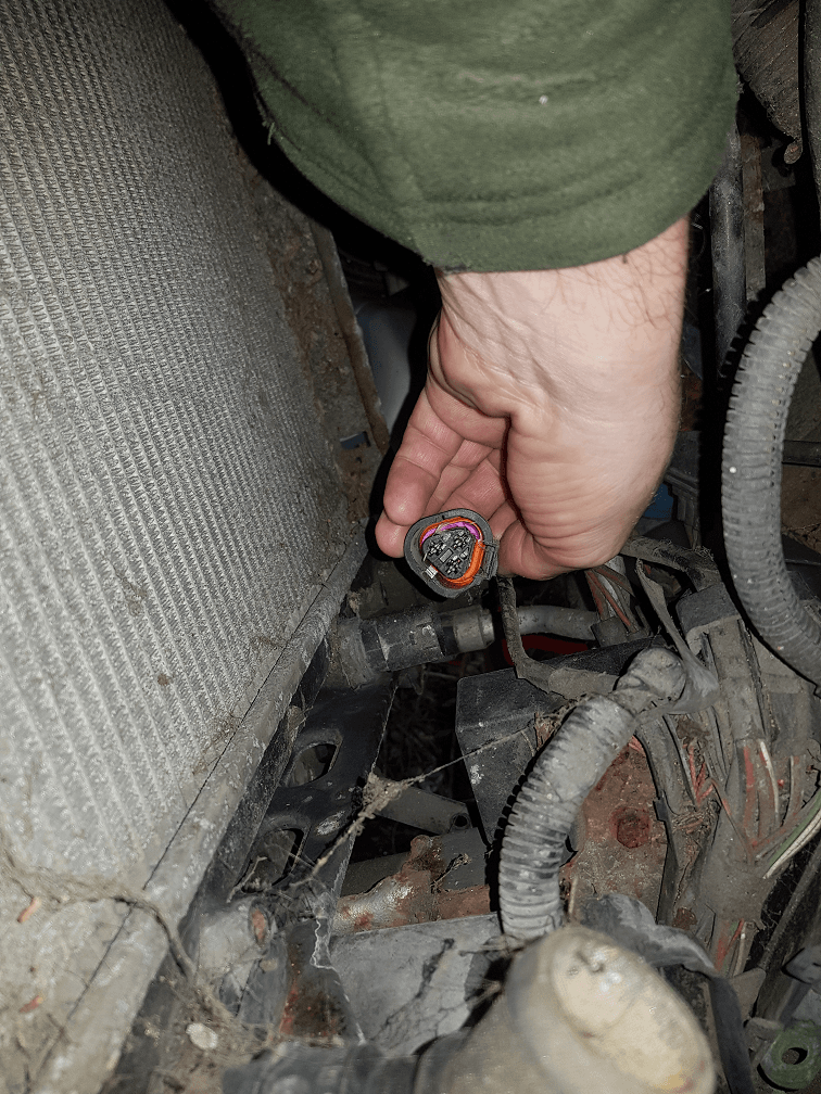

That doesn't really pinpoint the problem enough, it probably just reduced the engine temp because heat is being bled into the passenger cabin. Having the heater on full is probably enough to stop it overheating in this weather, but once it gets hotter weather it will become worse.
You really need to test the fans by jumping the connectors on that triangle plug as shown in the video. You dont even need to put terminals on the wire, just use a thick piece of wire and touch it firmly to the pins. You can probably test it in 10 mins, whereas replacing the fans is a much longer process
The resistors are built into the fans, but there is also a fan control box that comes into play, that's why you need to test at that plug, as that removes the fan control box from the equasion, and you are then purely testing the fans and resistors.

No worries, i have a scrap one on ths drive so i took a pic of the plug for you, its on the passenger side of the radiator, half way up at the back! Obviously watch your fingers in the fans when testing. i'm pretty sure one of the speeds can be activated with the igntion off.
Thank you so so much.. I'm gonna look at this and feedback
