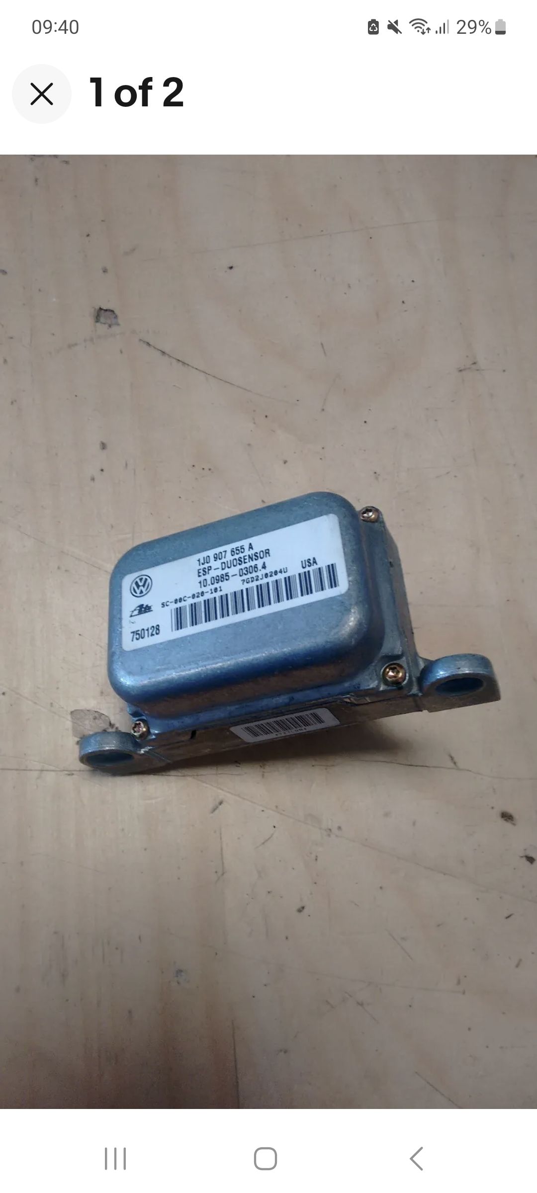

Hi mate, ok I had this a few year back, I tried doing some sort of calibration by moving car forward and back and turning steering wheel 1way then the other something like that but it didn't work, I also tried undoing the battery for 30 mins to reset system this did not work but for others has, some have a said steering angle sensor fixed it for them, for me it was like a silver module/sensor if you look above ur pedals upwards your steering wheel you should see a silver module sensor with a sticker on it, that's what I replaced and it's been fine since, u will need a torch and ur phone take a pic of it for part number if I remember it was like 15 notes on ebay just a fiddly job because where it is. But try the battery and that maybe 1st.
I think this was it, but look anyway as your part number may differ.

So, I drove it today and no TCS light, weird but I will keep an eye on it and take note of what you mentioned. Thank you again!
