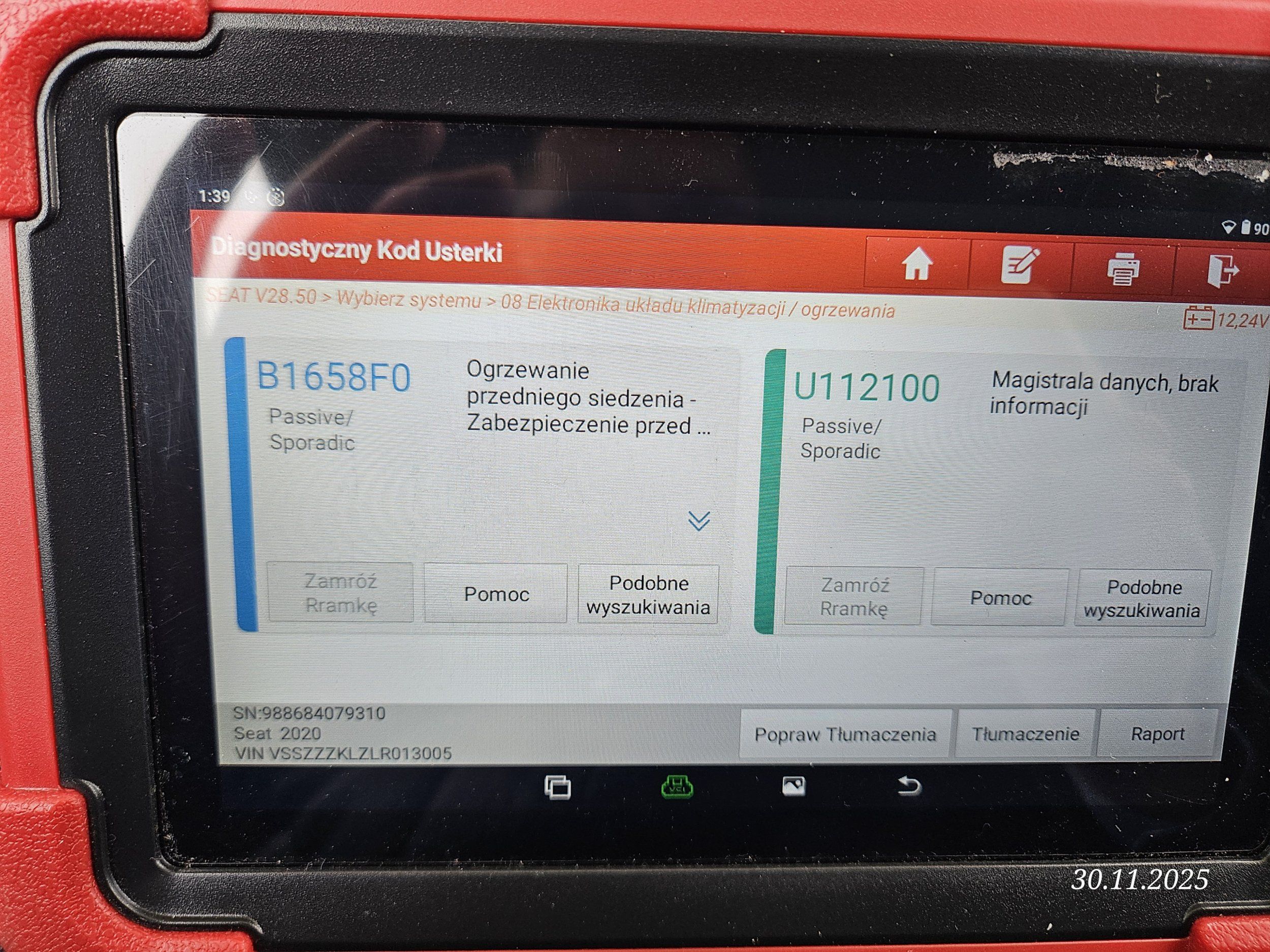

Hi, I recently have an issue with heating of driver seat in my 2020 Leon MK4.
It turns on and after few seconds it turns off on its own on passeger side everyrhing works fine. Diagnostic tool showed error of preventing from overheating. I assume sensor which checks temperature is faulty and turns off the heating. Do you have any idea where this sensor is located? And how it looks? So that I could try to replace. Thanks in advance for tips.

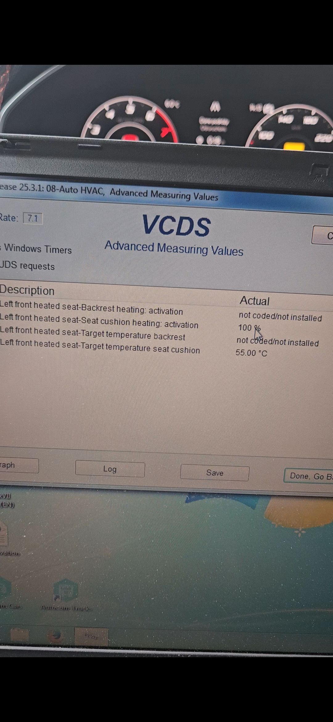

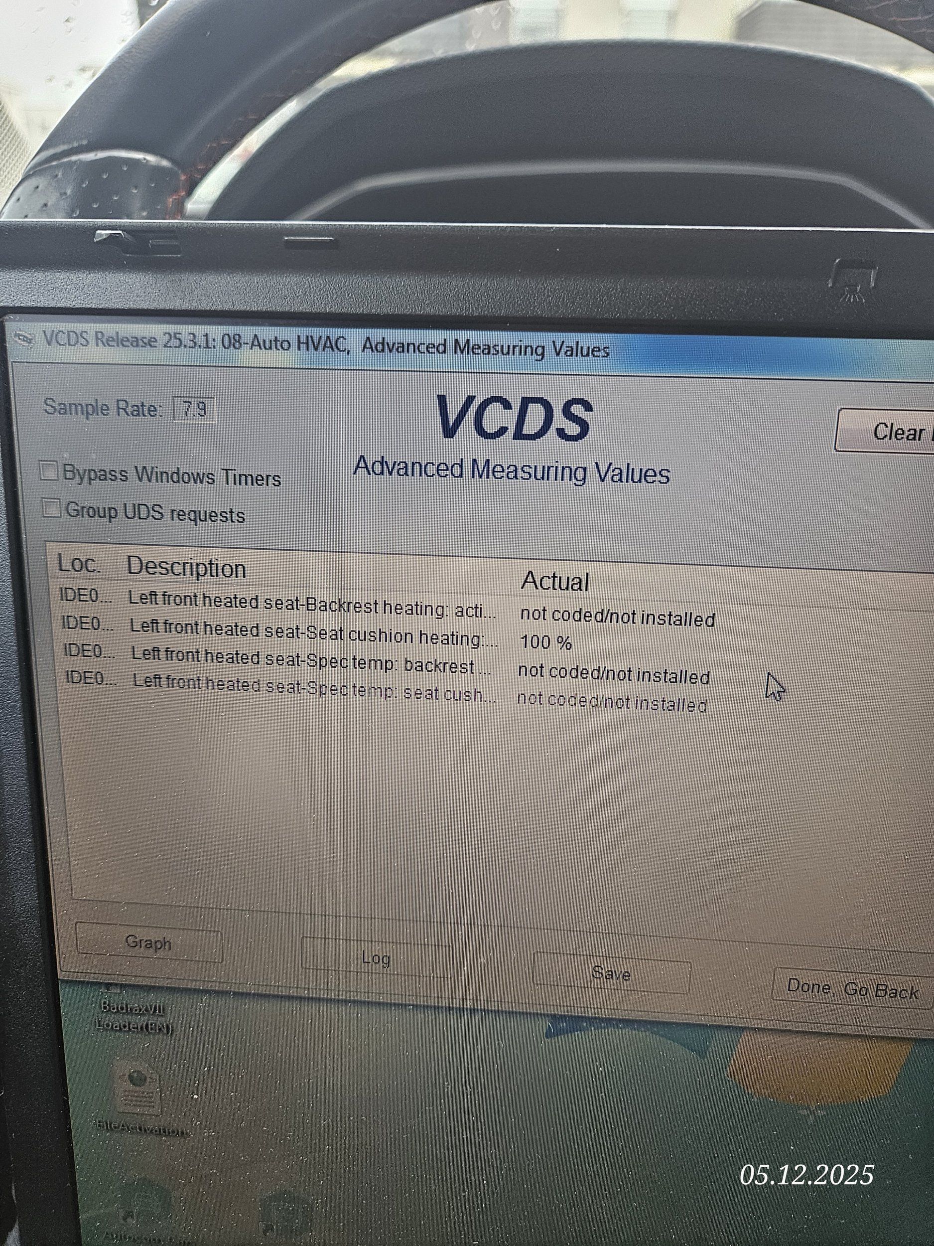

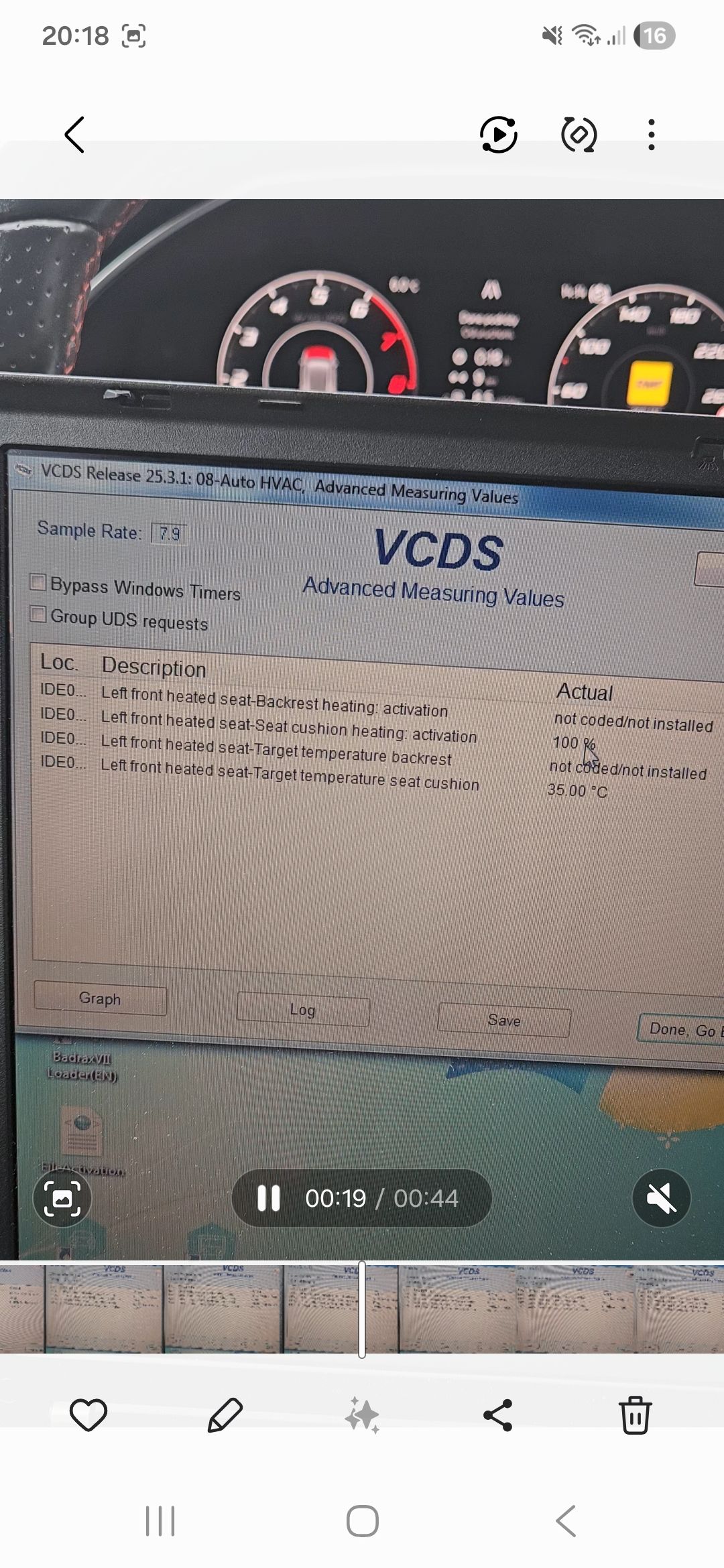

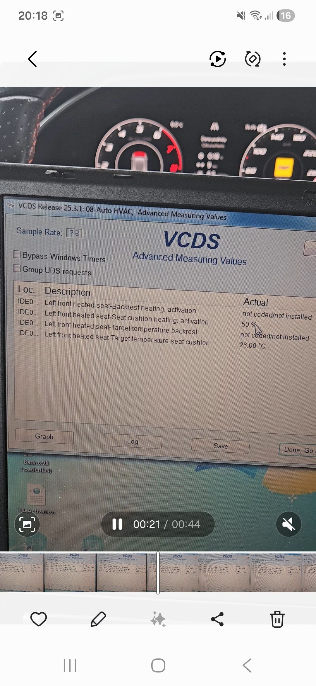

I have used vcds and switching of heating levels seems to be working fine as you can see on photos on 3 different "gears" temperature is changing nevertheless heating is turning off after approximately 1 min. Is there any other way to try to diagnoze this problem using vcds? Do you think heating matt should be replaced?
