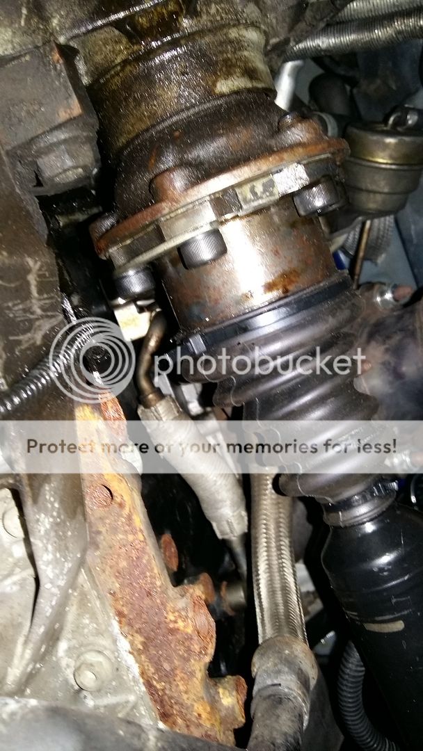

Evening all.
Driving my leon cupra and seems to shake and knock while accelerating, jacked it up and worked it out that my inner cv joints am clicking so looking to buy new cv joints.
Looking on ebay i cant seem to find correct ones. As the shafts look different. I will post pics of mine on car plus a ebay pic.
Need to order asap :( horrible to drive
