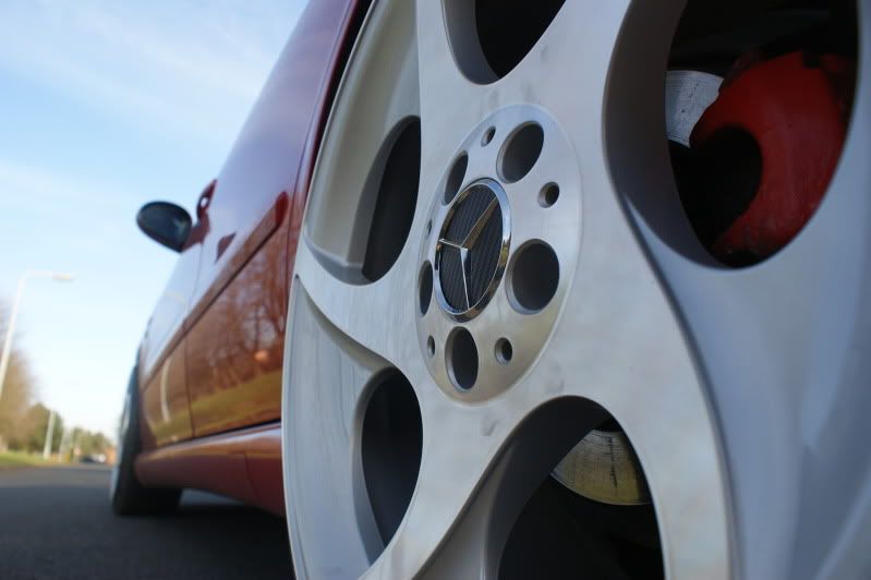

So just now your saying your spigots on the wheels are different to the spigot size on the hubs??
WOW!!!
You can get spacers for these.
I would not be driving a car with this miss match, have you thought this through??
The side load/shearing load on the wheel bolts will be huge. There not built or designed to resist this type of load.
Please rethink this set up
Yeah the middle circle on the spacer slots onto the hub nice and tight, held on by the 5 bolts.
Then the wheel center bore is slightly larger than the spacer so if you put the wheel on the spacer it cant just be spun round to line the bolt holes up. I need to raise the wheels slightly so everything lines up.
I have seen the spacers my mate who works at my local garage showed me theyr just crappy black plastic circles.

wheels look stunning,
Derek, are you after standard bolts for the LCR, or for Merc Alphards?
LCR = M14 x 1.5
Merc = M12 x 1.5 (again not 100% sure on these, well the M12 I am, but not the Pitch)
you are getting spigot rings for these yea?
you must not rely on wheel bolts to do anything other than clamp the wheels.. centre hub is the part which should carry the loads not the bolts in shear.

Derek the centrebore is Merc, so 66.6 (or something like that)
