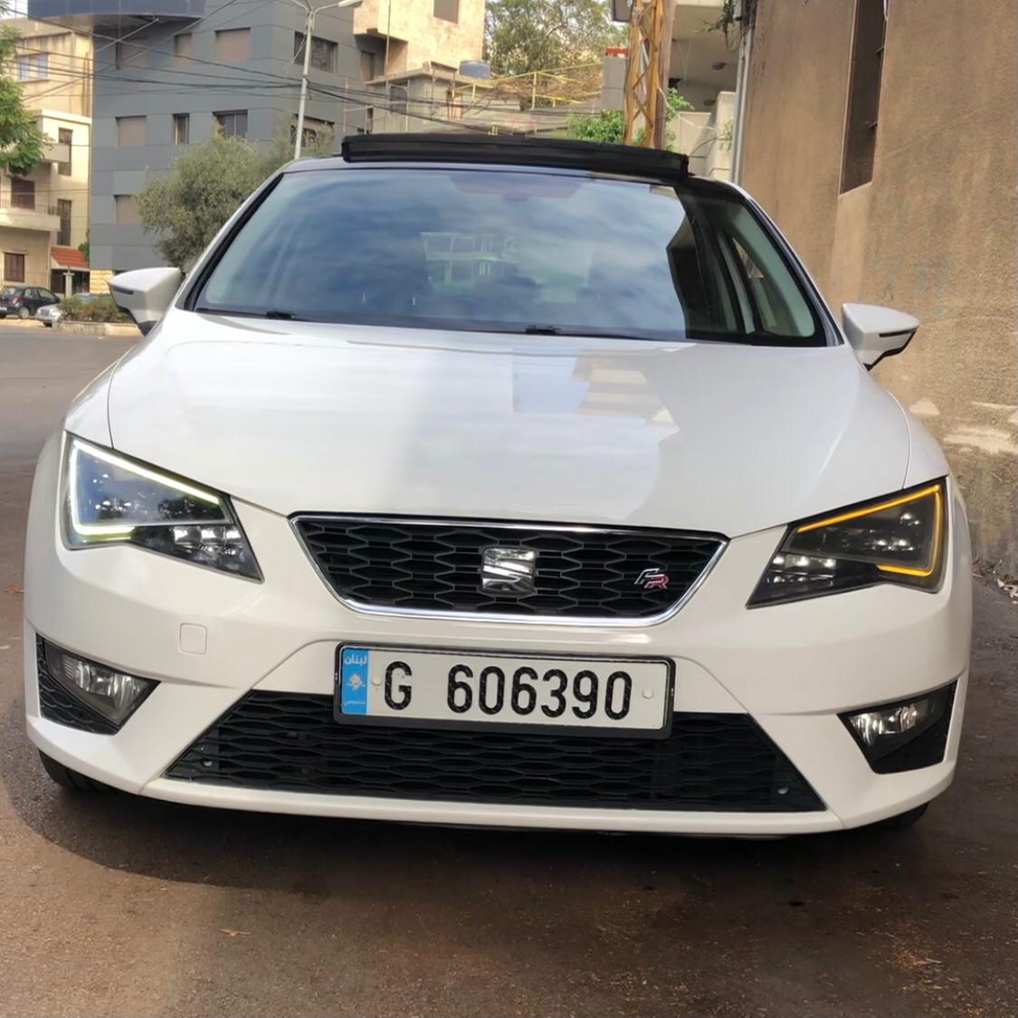

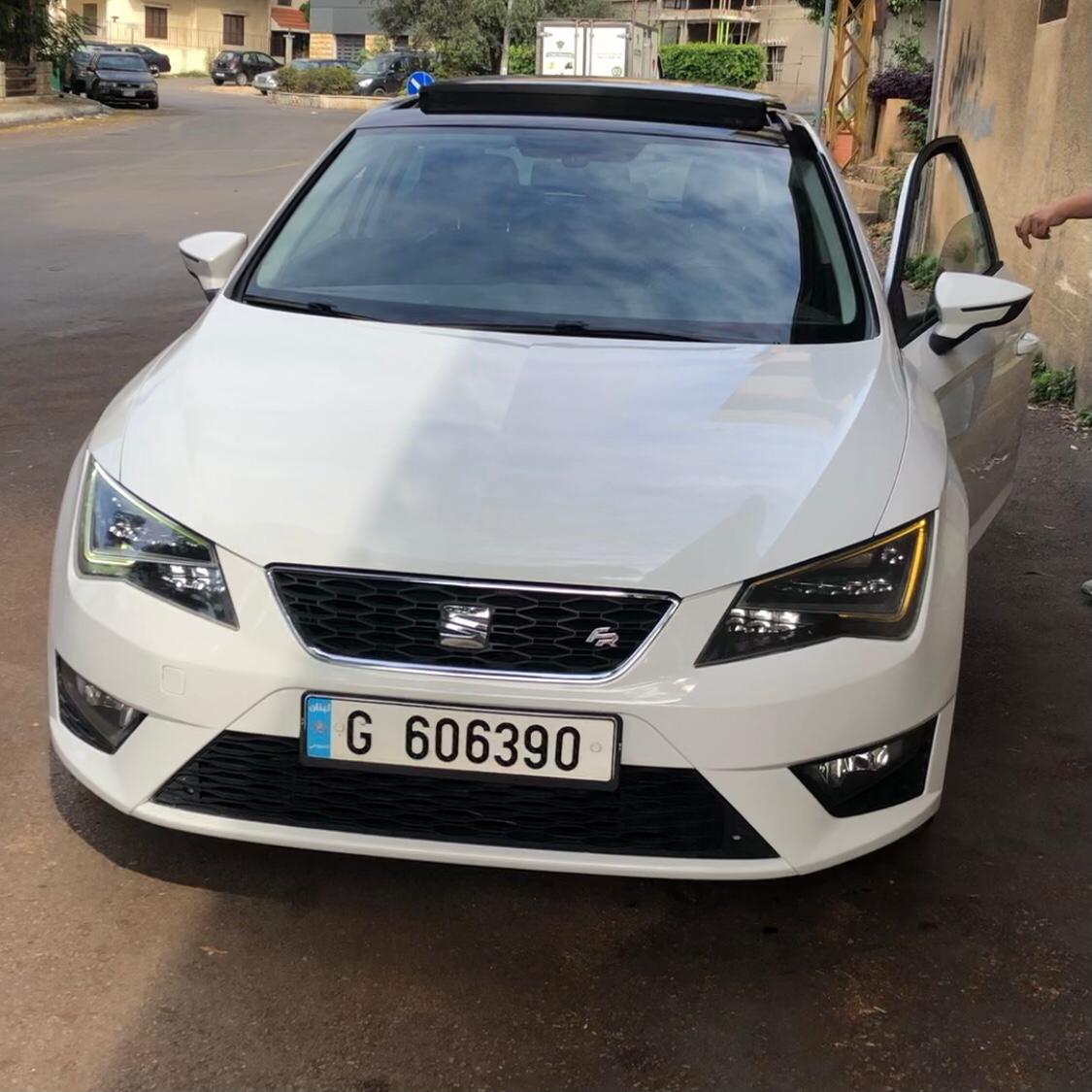

So I'm eyeing a second hand 2014 Seat Leon FR with 120,000km on the clock. Problem is, the front left DRL is yellow and dimmed just like @gaffer1986
What was your solution for this issue? Did you end up having to change the entire headlight units after the module replacements did not work?
Can anyone help? Don't want to buy the car then have to put in a somewhere around $600 to replace the entire headlight ;)
Attached two pictures of the car to compare the DRLs

The heat from the engine, the sun and the day time running light all together can get hot enough to actually singe and melt the end of the day time running light tube turning it black which means you'll need a whole new light as it doesn't let as much light through. It's either that or the tube is fine and the day time running light LED unit needs replacing which is around £60. But until you take it off and have a look inside you won't know. I still have mine as I don't want to pay £1000 for two new headlights when I can just turn the DRLs off. Although I may get new headlights soon as the lens is now starting to craze (loads of tiny cracks) which looks bad.
