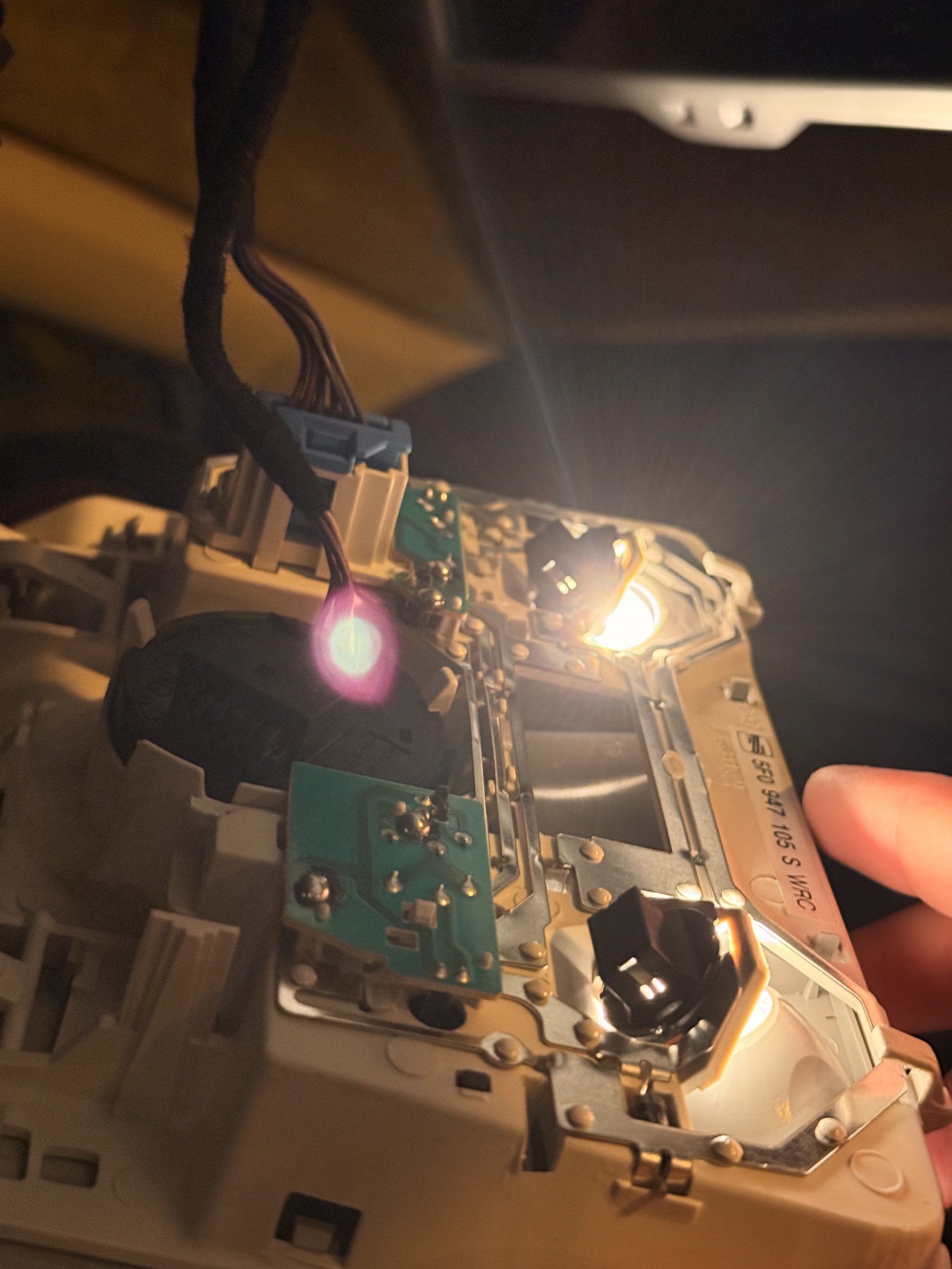

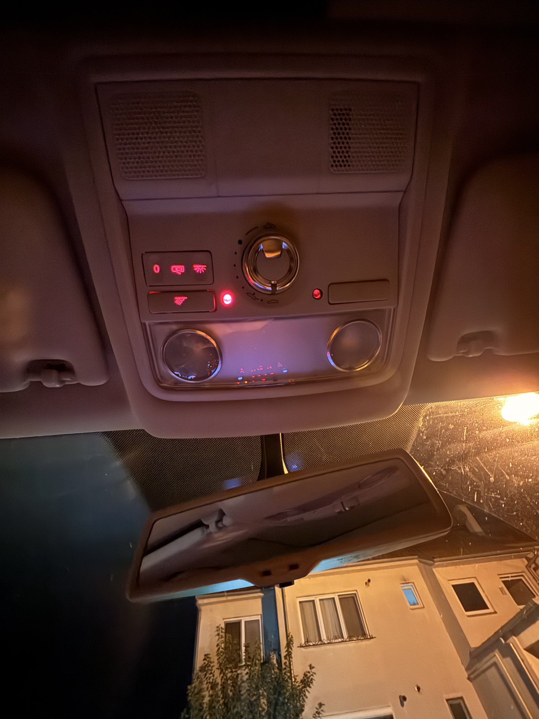

This light on the right
That light. Probably it's electronic rather than something you messed up in coding. Not one of those fibre that directs the light forward moved away from source ?. Failing that the LED is probably just failing or something got disconnected. My heated wing mirror coil was never clipped in all the way at build. Probably passed the guy on the production line so he didnt press it in so it went click... had a sip of coffee and missed it.
sometimes work sometimes wont light up
