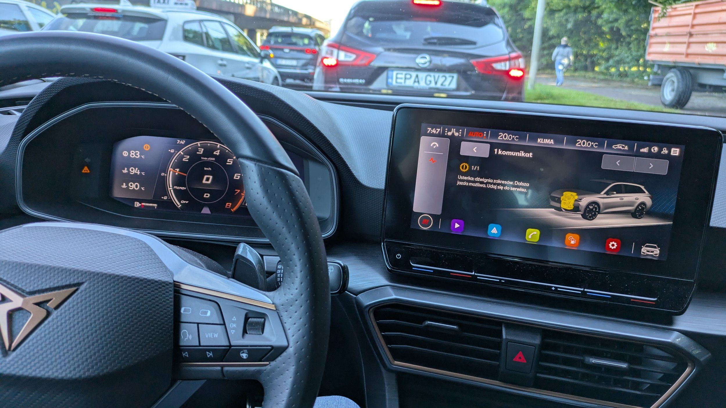

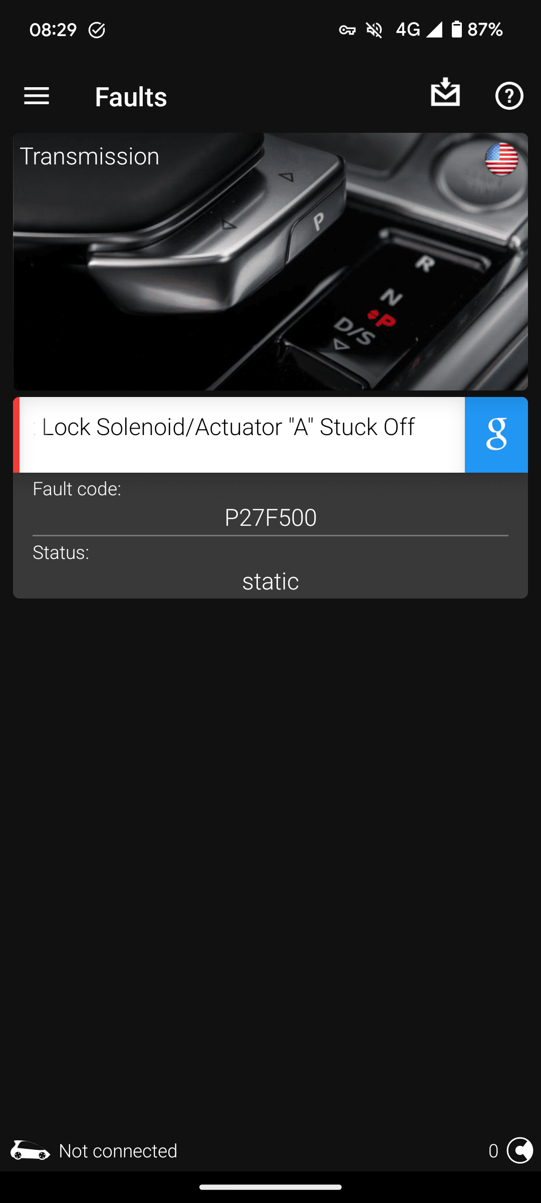

Yesterday in the morning after being stationary for 2 days a gear selector lever fault popped on my dash. Since it is fairly common for various errors to come and go I restarted the vehicle and error was gone even before I managed to plug in my OBDEleven. Did 500 km without further issues.
Today in the morning the error came back and now it is randomly showing and disappearing. I think it is here to stay. Booked service in 2 weeks.
Fault code is P27F500. Found some reports on the Internet, usually ends up with replacing the whole selector module 5WA713033.
Did any of you encounter this problem? What was the resolution for you?

Authorized workshop diagnosis is as expected - whole selector module needs to be replaced. Part is currently unavailable in my country. Waiting until they bring it into Poland.

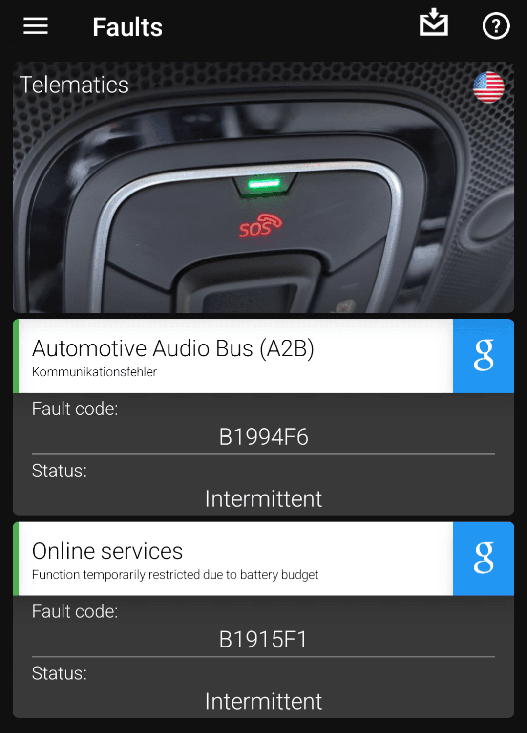

Dealership replaced the selector module. I don't know the number of a new part. After the operation they called me that an eCall error came up on the dash and they would like to keep the car for further diagnosis.
Since I already have problems trusting them I went to see the car and scan it with OBD11. In fact there were new errors related to Telematics module.
Technician followed the one about audio problem - B1994F6. One extra day for diagnosis, one for getting the parts shipped.
It ended up with additionally replacing the lights/eCall module in the roof lining.
Strange coincidence - I've never had any errors from SOS.
For the moment there are no faults while scanning. Hoping it stays like that as long as possible.

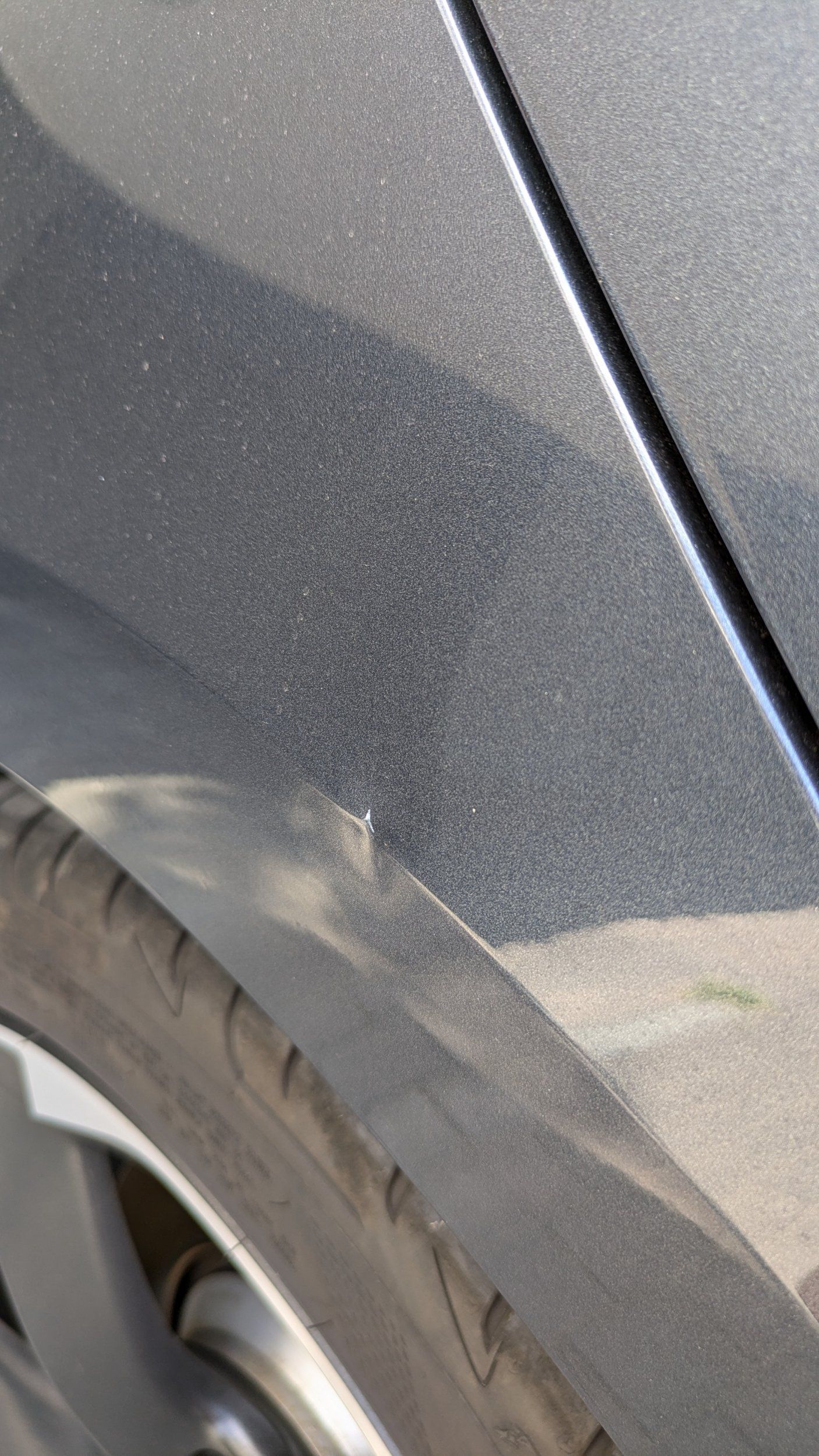

PS
I found a souvenir on my car after the repair. FFS ?
