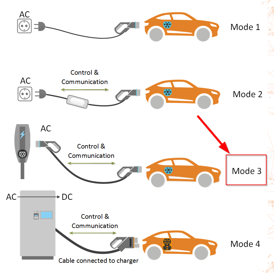

Mode 3 its different from cable type.
The cable used in mode 3 is a type 2 cable.
Reactions: romster1
