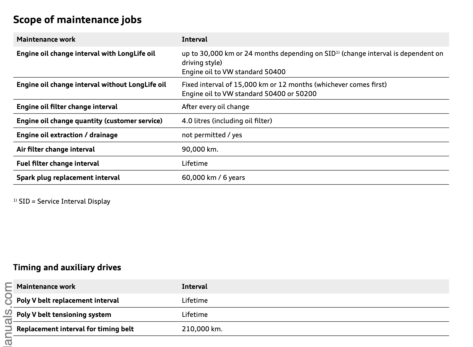

I was reading the technical documentation on the EA211 engines and the lifespan of the timing belt is supposedly 210k km. Does anyone have any real world data? And then its inspection thereafter. Any info about the tensioners, etc...

also, a "doubl- hexagonal socket" is used ... never heard it called that ... usually a triple-square or a XZN socket (XZN to signify the 12-points) ... thus, I guess "double-hexagonal" works and is as awkward as triple-square ... lol
anyways, nice video ... I'll just go with the periodic inspection unless anyone here has more real-world info ...

I'd rather replace the front end auxiliary belt every 8 years or 60K miles, saves any inconvenience - though maybe I'm just suggesting that as my wife's 2015 Polo 1.2TSI 110PS is coming up for its year 8 service! I'm sure that the original change period for spark plugs was 4 years as the standard fit plugs are not Iridium tipped. Again 4 years for the air filter works for me, so I'll stick with that.

Yes that was always what I found, ie when you needed cambelts replacing every 5 years, the advice was just to change the now removed auxiliary belt - and the coolant.
I just service our cars every 12 months which means roughly 6K miles on the Polo.
