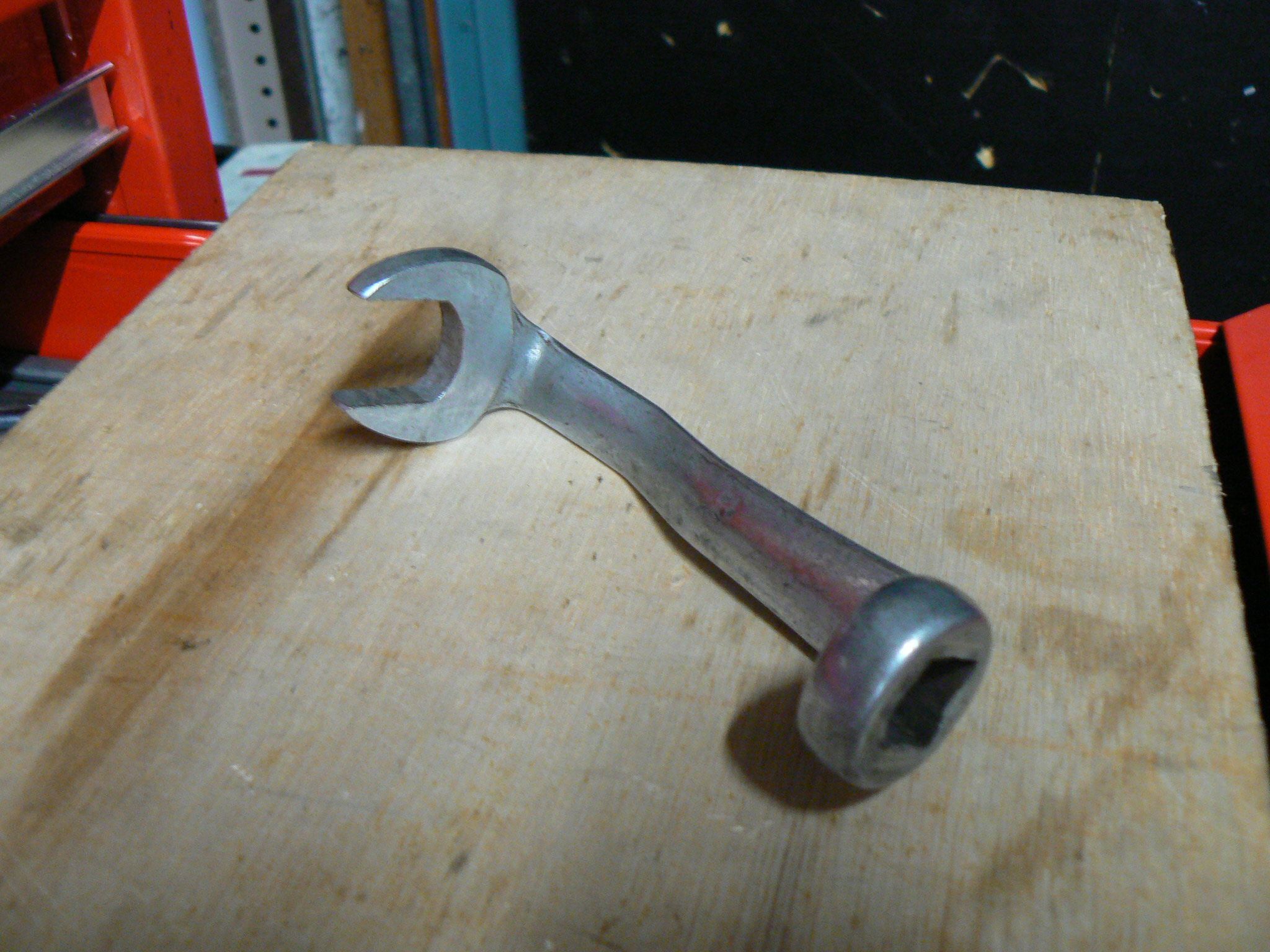

I had "seized the moment" many years ago when I spotted a tool being sold on ebay to press these TCA rear bushes out and in, so I'm "glad" that now I can use it!
I've got a few things like that which have been acquired on the spur of the moment due to me perceiving them to be good value. For instance the special crow foot I bought for doing the lock nuts on the Pinto when adjusting valve clearances. Made doing the middle ones much easier.
Strange thing for me to buy when you think it was mostly BMC/BL stuff I worked on? Probably only used it about half a dozen times!
