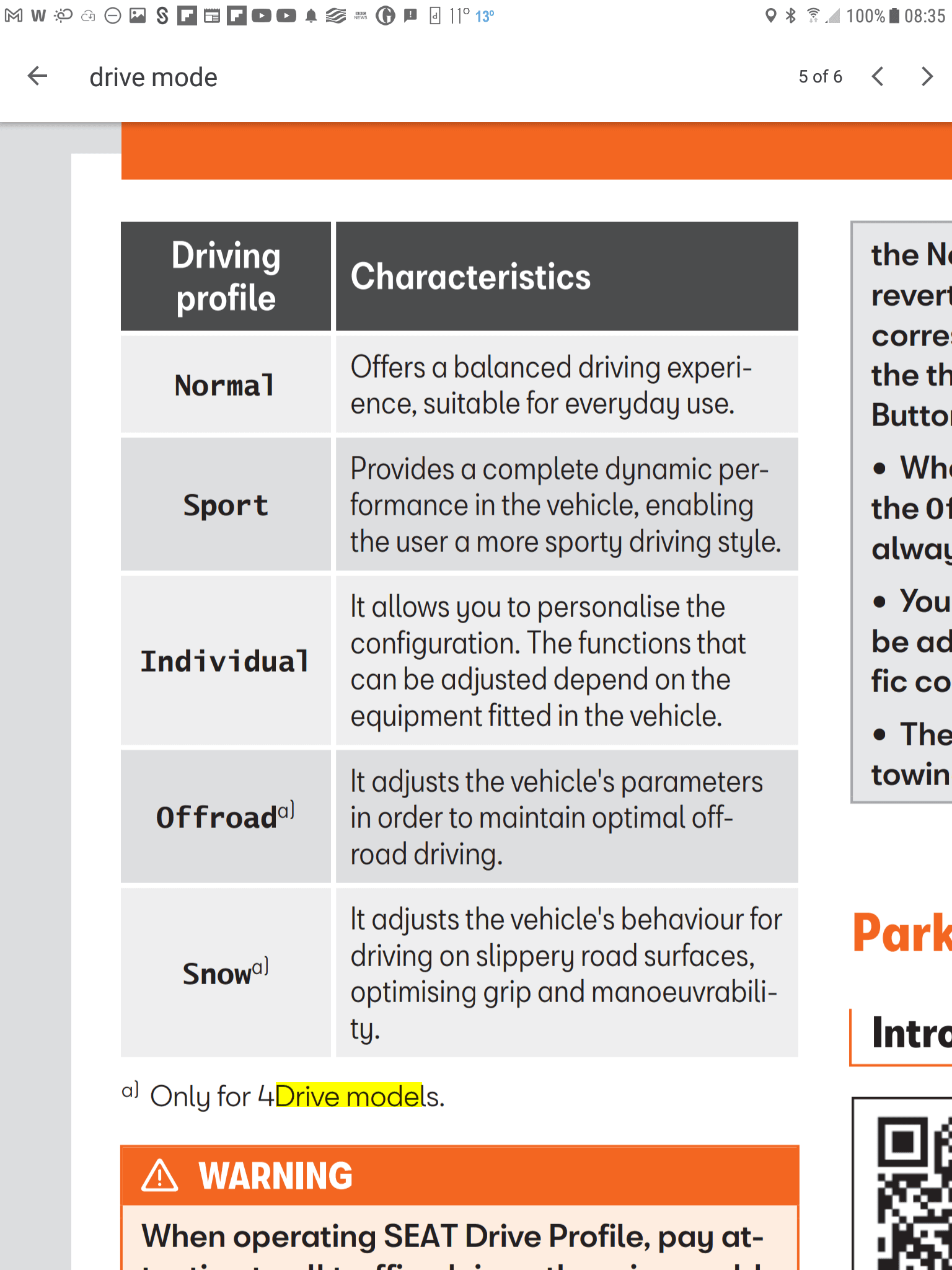

I don't reckon anybody knows but you can have a look to see whether you have "Individual" on your set up. I called it personal, it's actually called individual. That's the user balance on the settings... make your own up. Something to look for in the menus. That's suppose to be the configurable bit of the options. Never touch it myself or the paddles except in adverse conditions.
I already tried the individual profile
However, the ACT and eco symbole active in all modes ( i didnt try sport mode yet).
The question is: shouldn't the eco (ACT) turned off in normal profile?
