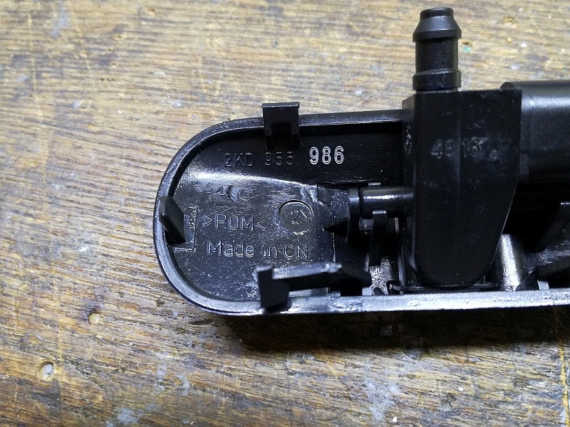

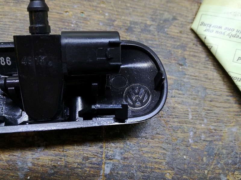

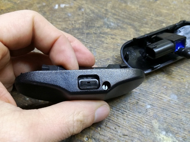

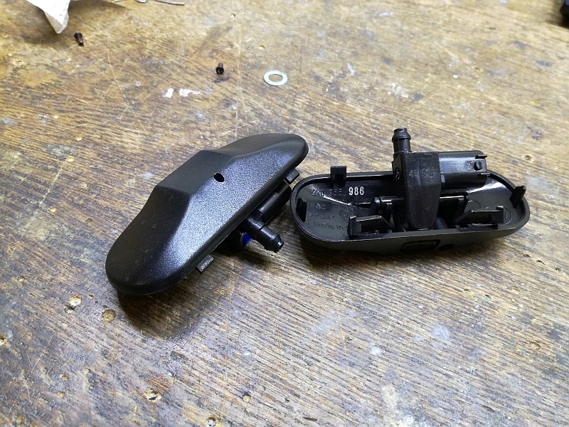

It has been a productive day. I have now installed the windscreen spray nozzles, heated version, set of 2pcs from Aliexpress 12€. Local VW dealer is asking 50€/set, friend got some older VW ones from scrapyard for 10€/set.
Installation is fairly simple, it took about 3-5minutes.
video: https://www.youtube.com/watch?v=VAwp2WghcTk

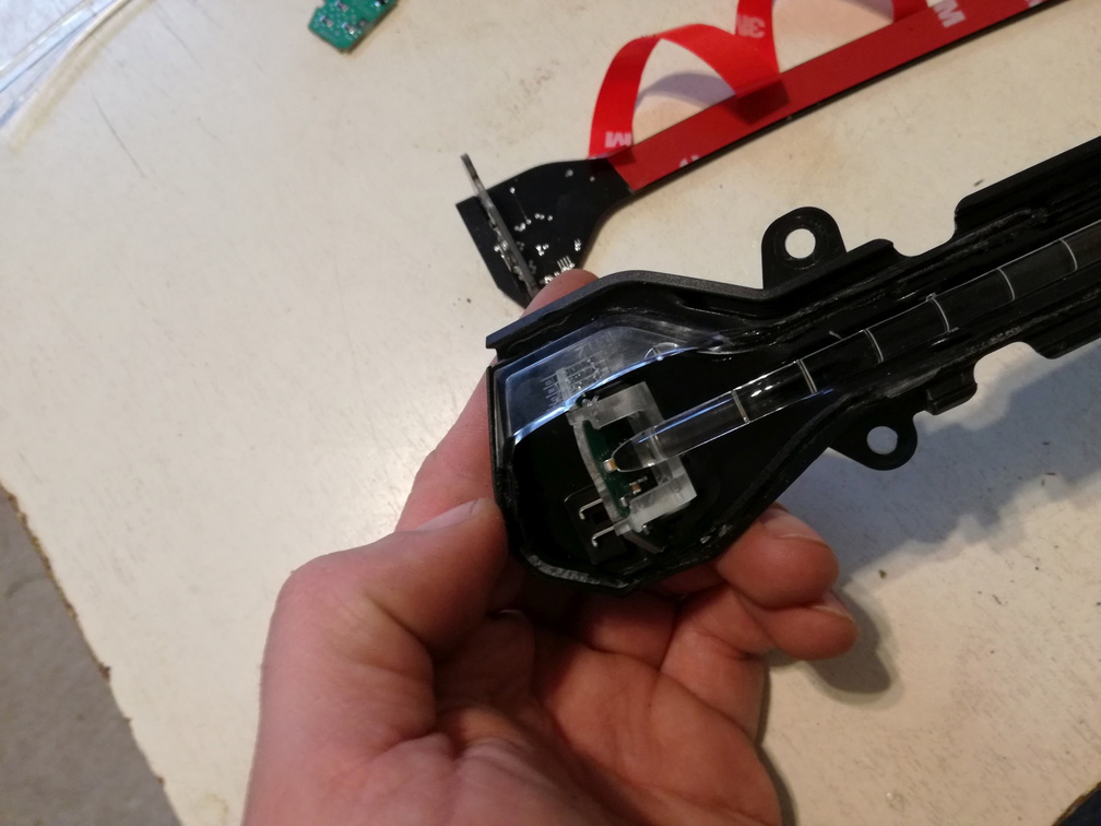

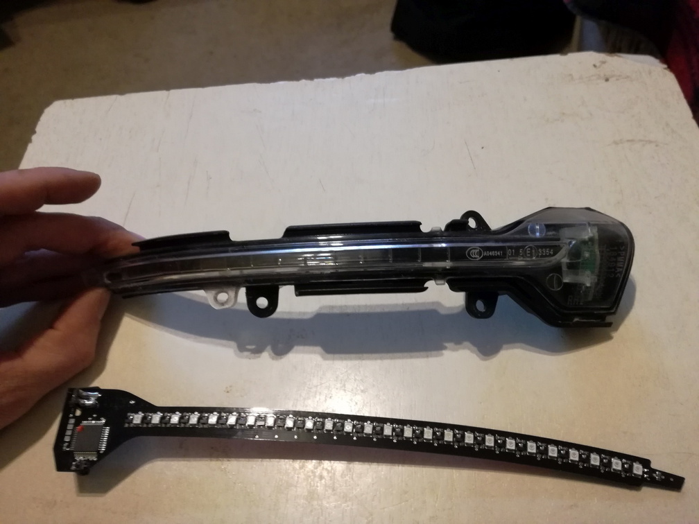

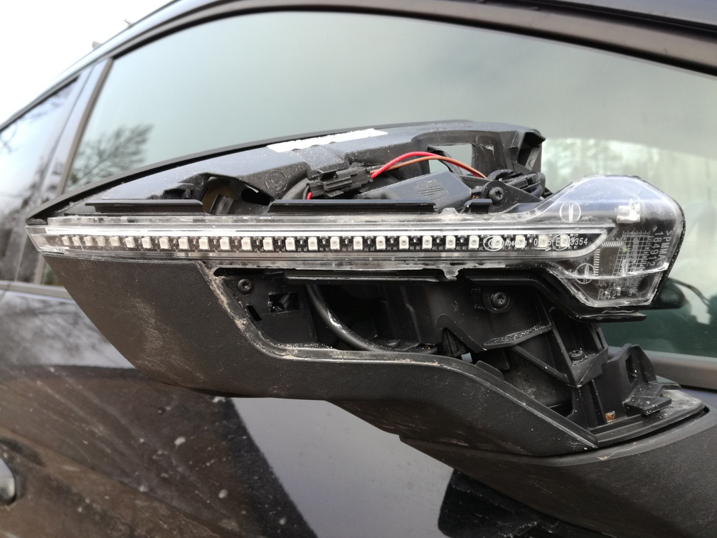

Dynamic blinker kit got also installed today. This is already some heavier stuff, kind of not for the faint-hearted, but nothing impossible.
The kit was ordered from Ebay user hs-cnc

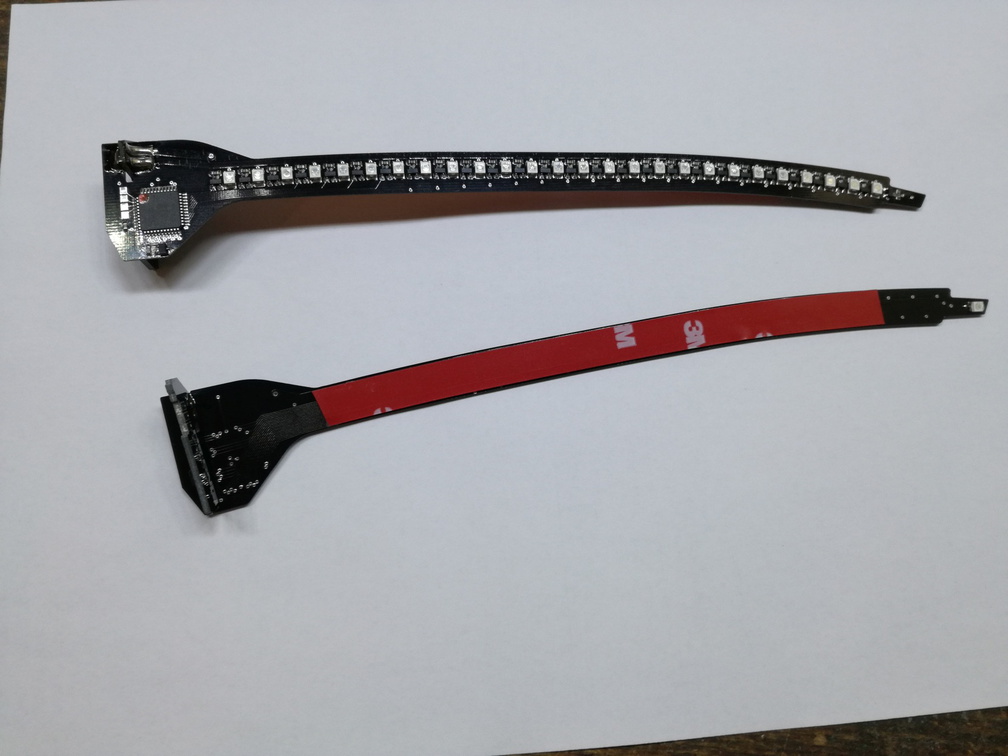

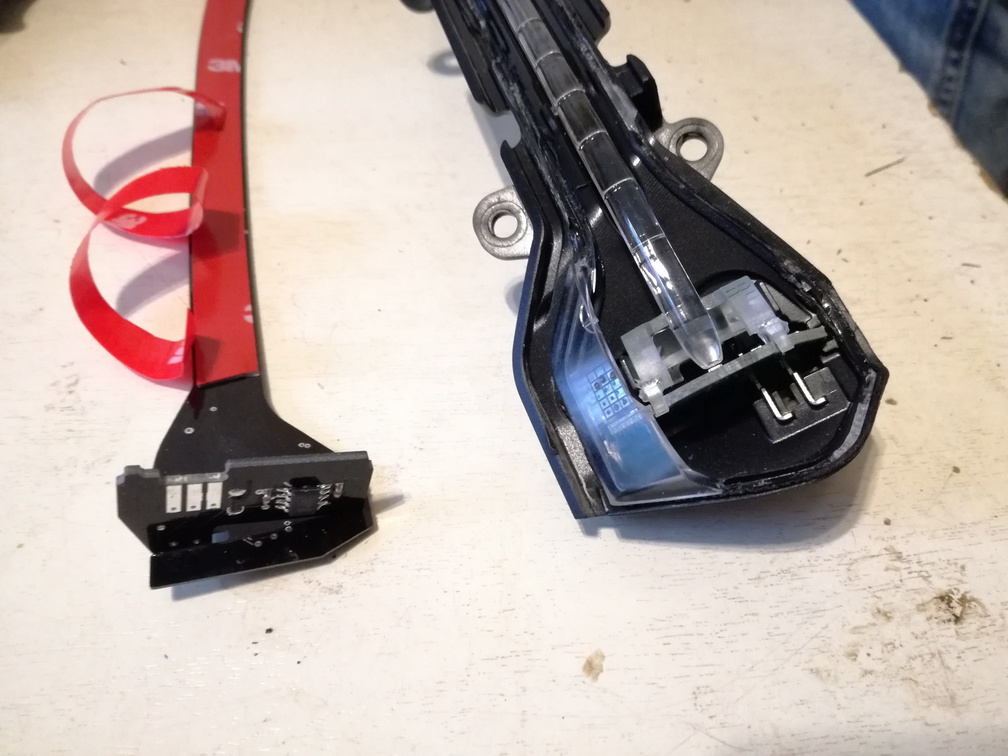

firstly the packing is nice, metallized plastic bag with lots of scrapped paper and a box :D They are flexible PCB-s with Atmel MCU driving transistor for each LED. For powering they use 78L05, some hall efect sensor for switching modes. So usable voltage range about 7 to 25V. [end of electo-technical description] Behind the strips there are double sided tape to stick it to the original light guide groove.
To install the strips:

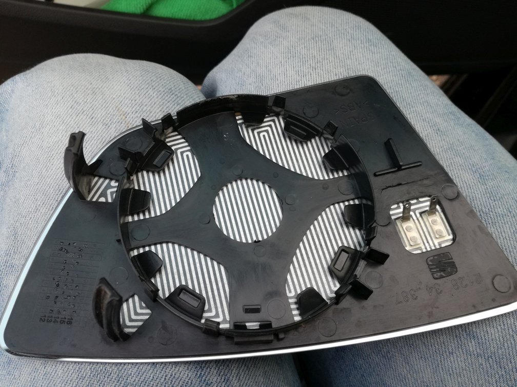

1) Turn the mirror most inner position, so you can remove the glass by finger, you just must pull it out. I suggest to try to put your finger as far as possible behind the glass and pull. PS! Be careful, the heating element wires are on the car side and not the longest ones. Hold the contacts against the mirror and pull the connectors off.

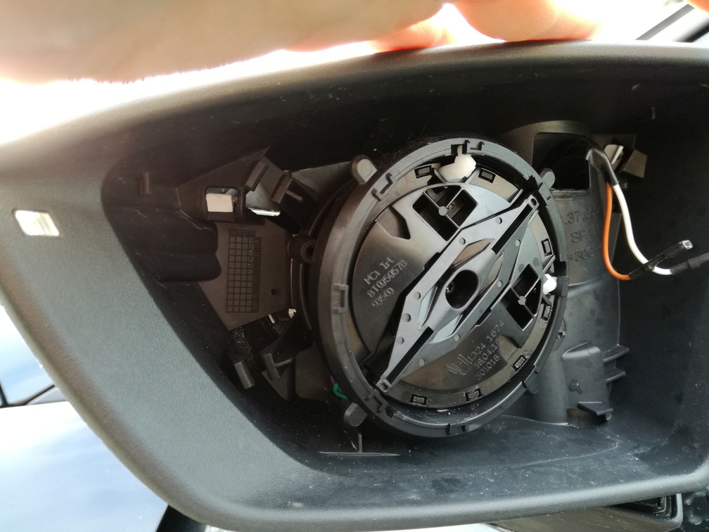

2) Then, in my case, the white mirror cover removal is a bit tricky. It is held from 3 different locations by clips that really want to brake (I managed to break 2 of them). White clips on the top right and left corner and on the left lower corned, "in the hole". This one is between and under the black clips, this is most harder to get to.
3) To remove the lighting part there is 3 torx screws and some fiddling necessary.
4) Now comes the scary part. The transparent plastic is glued to the place. I used knife to cut and mostly push-pull-break it off. Managed to brake one part of the plastic too, but it is inside the mirror, so no problem. I noticed that one side can be opened much easier and then you just can pull the other part open.
5) Pull the original parts off, the connector has some push-on clamps for electrical connection, put them to the LED strip PCB and mount it. Before removing the double sided-tape make sure you make some trials on fitment.
6) Try the assembly on car BEFORE gluing it back together. I used some Super Attack gel superglue, tried to make it as watertight as possible. It was not the nicest, but all are hidden inside the mirror.
7) Attach it in reverse sequence.
8) Enjoy the turns :D
more pics: http://www.egertifoto.com/galerii/index.php?/category/923
video: https://www.youtube.com/watch?v=oNLvakIyaCc
PS! Someone could try to leave the light guide in. For me, as an electronics engineer, the distinctly visible LED-s are not the nicest in styling compartment in my opinion. Since mine is glued already I can no test it nor test some semitransparent-foggy plastic sheets there also.
