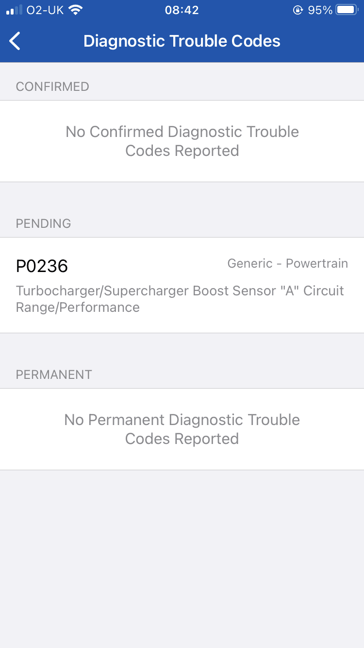

I have a 62 plate Ibiza, the diesel 1.6 FR.
It has had a problem with the turbo boost sensor, fixed, 9 months later broke again, just had new genuine seat sensor and mount, drove fine for a week and fault now back and car in limp mode.
When you plug the computer in it shows everything working as it should, according to the functionality there isn’t actually a fault but the sensor keeps flagging up, but the sensor should be fine given as it’s new!
Any ideas please? Sorry if I’m vague, I’m not very techy and I’m a grand in so far (also had to have an issues with the alarm fixed) and feeling a bit fed up!
Not sure if they need learning, my turbo actuator needed setting up with obd11 when replaced
