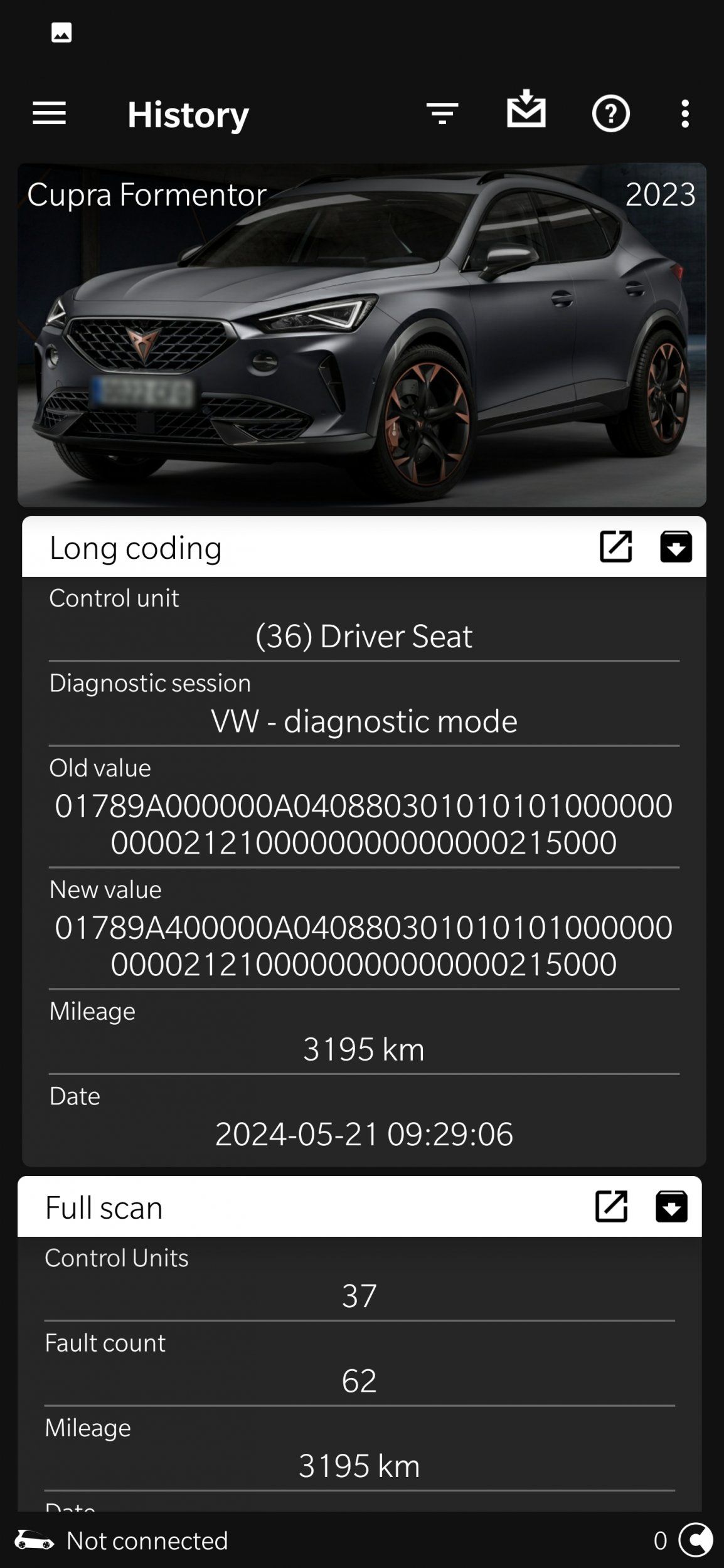

I used OBDEleven to do the changes: Unit 36 → Long coding → Byte 03 → Activate bit 6.

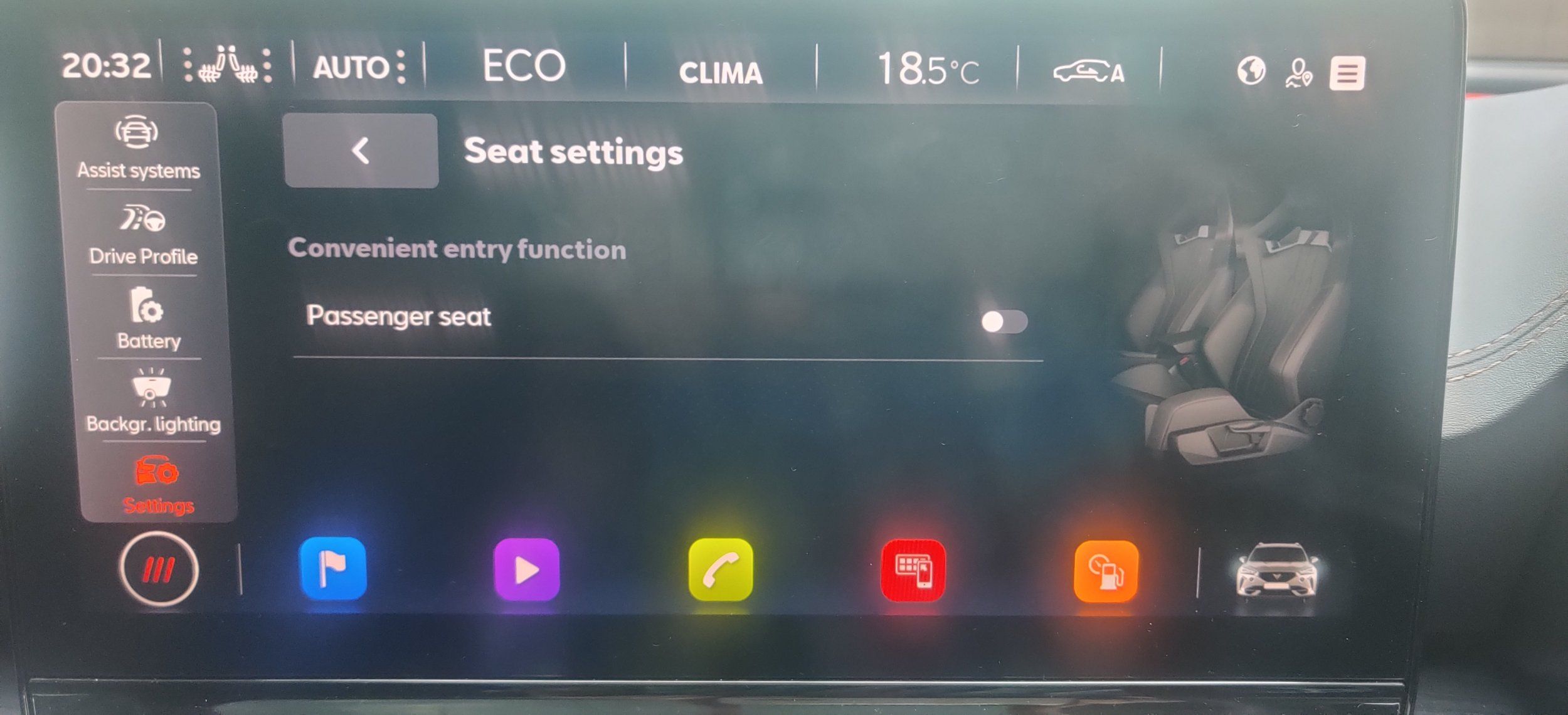

I did this, seems to work but noticed the infotainment 'seat' option has just a passenger option available. I've electric on driver seat only.
Was there a way to enable and disable the driver easy entry via the infotainment?

I was expecting the car to have this option like other cars from the VAG Group, but I couldn't find it at all. And the only way to enable it was this one :) If this has changed it would be really nice.

Edit: Just works for saved positions 1 and 2. No effect if position 3 is set
