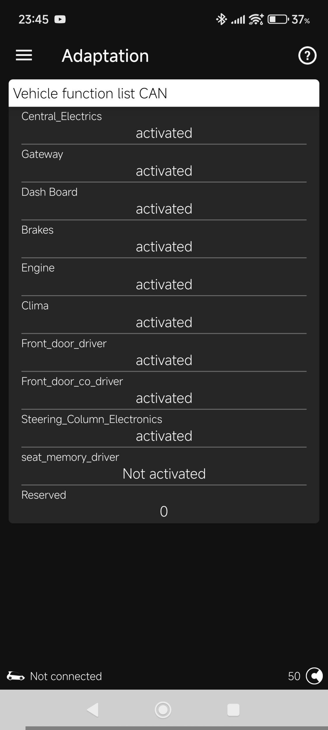

My 2025 Cupra Ateca has this option in the car settings menu but it always stays in a disabled state. When I tap it to enable , it slides to right just for a second, as if it would get enabled, but then goes back and stays disabled.
The user manual says this works only if car has Cupra Connect feature. I find this very strange, what kind of relation could an electric seat option have with online connectivity?
Anyway, I looked around control units using OBD11 and found an inactive "seat memory driver" entry in Telematics unit that I thought might be related, you can see it in the attached screenshot.
I'd like to try to activate it but my car has SFD2 protection so I have to pay someone who can crack that protection. Yours probably doesn't have SFD2 so you might want to try it and let me know too :)
Cheers,
Serdar
