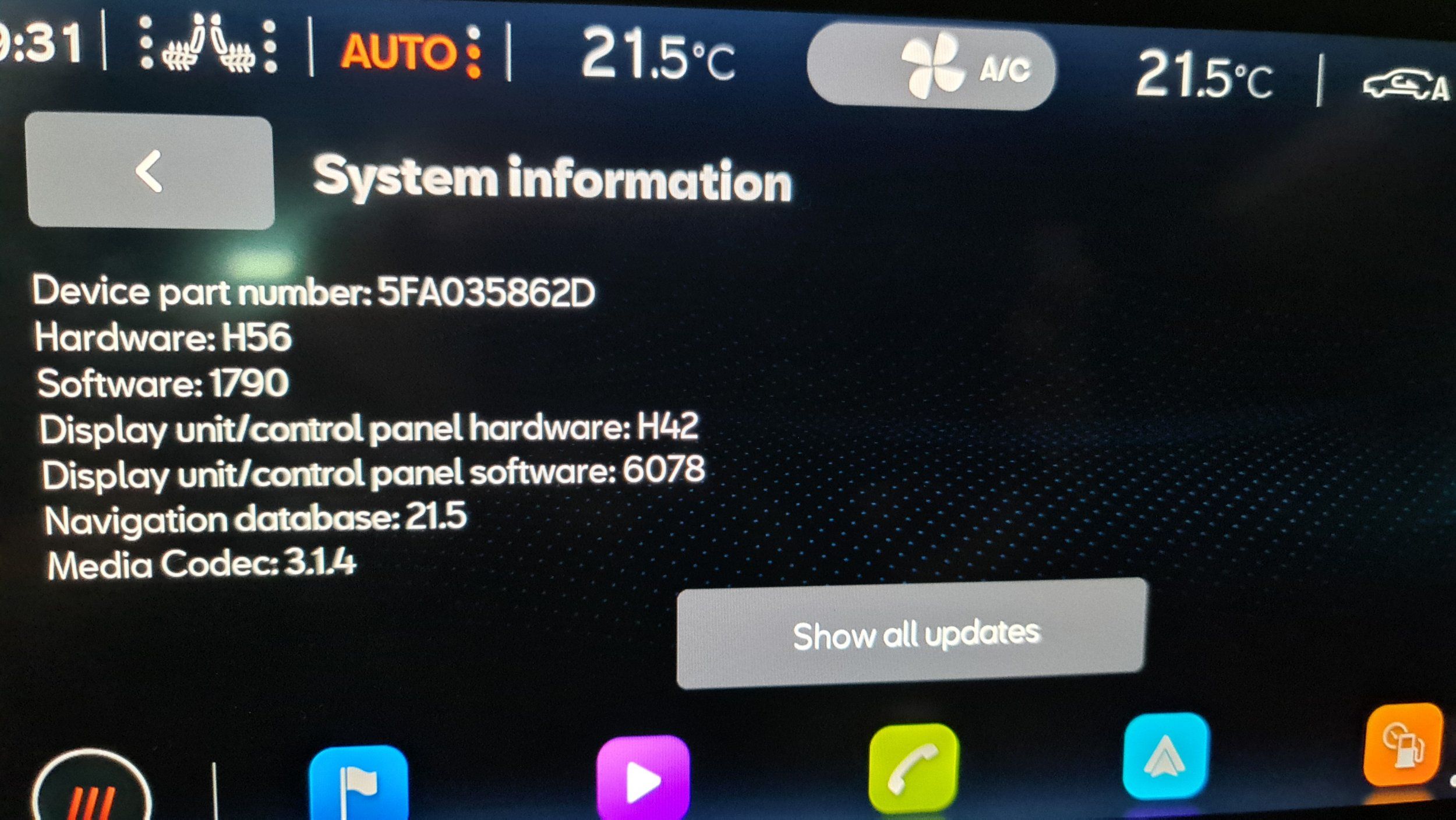

Mentioned previously I'd provide my software details. I have an earlier infotainment I think, hence why the main software version appears lower.
All my numbers are the same as yours, except that my display unit/control panel software is 6069. Perhaps that is the update they performed on your vehicle?
Mine is booked in for an update, I presumed it would be the 1803 one but maybe it will be the 6078 one instead / as well as.
1790 is the over-the-air part, the other software element is dealer-only, so that makes sense.
1803 is an update only for other models of the infotainment I think, not for ours. I'm fully up to date anyway, and no 1803 for me. :)
In any case, ever since I had the update, I've had absolutely zero problems with it.

Spoke to the dealer today to provide feedback on the update and inform them that it's been fine since the update - took the opportunity to ask which element it is that they updated and they confirmed it was the Display unit/control panel software.
Thanks for confirming that, I’ll report what updates mine receives when it goes in.
