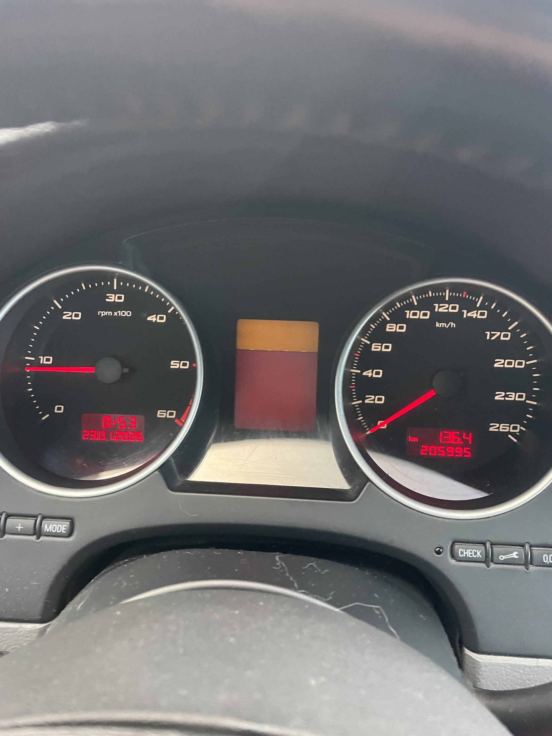

Hi . Here is my new problem that happened 2 days ago - the main center display behind the steering wheel has stopped displaying information. The display is still lit up so is getting power, but there is no info being displayed. Does anyone know what might cause this . Many thanks
I believe AliExpress sells replacement LCD displays but requires some precision soldering.
Search for Audi A4 B7 instrument cluster replacement LCD.
Check if you need the red or colour LCD.
