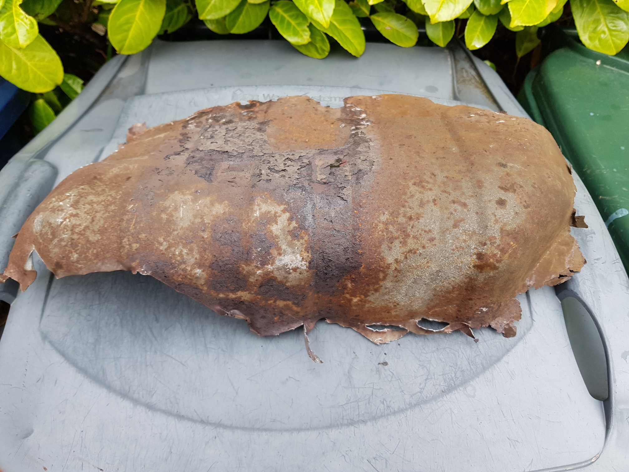

Just an update on my "rotting" rear exhaust box. Just lately it's started vibrating at low revs. Turned out to be the upper outer skin vibrating against the heat shielding.
After purchsing a small tube of silicone grease and a pair of exhaust hanger puller hooks, I managed to lower the exhaust enough to remove what was left of the outer skin.
Job done!
