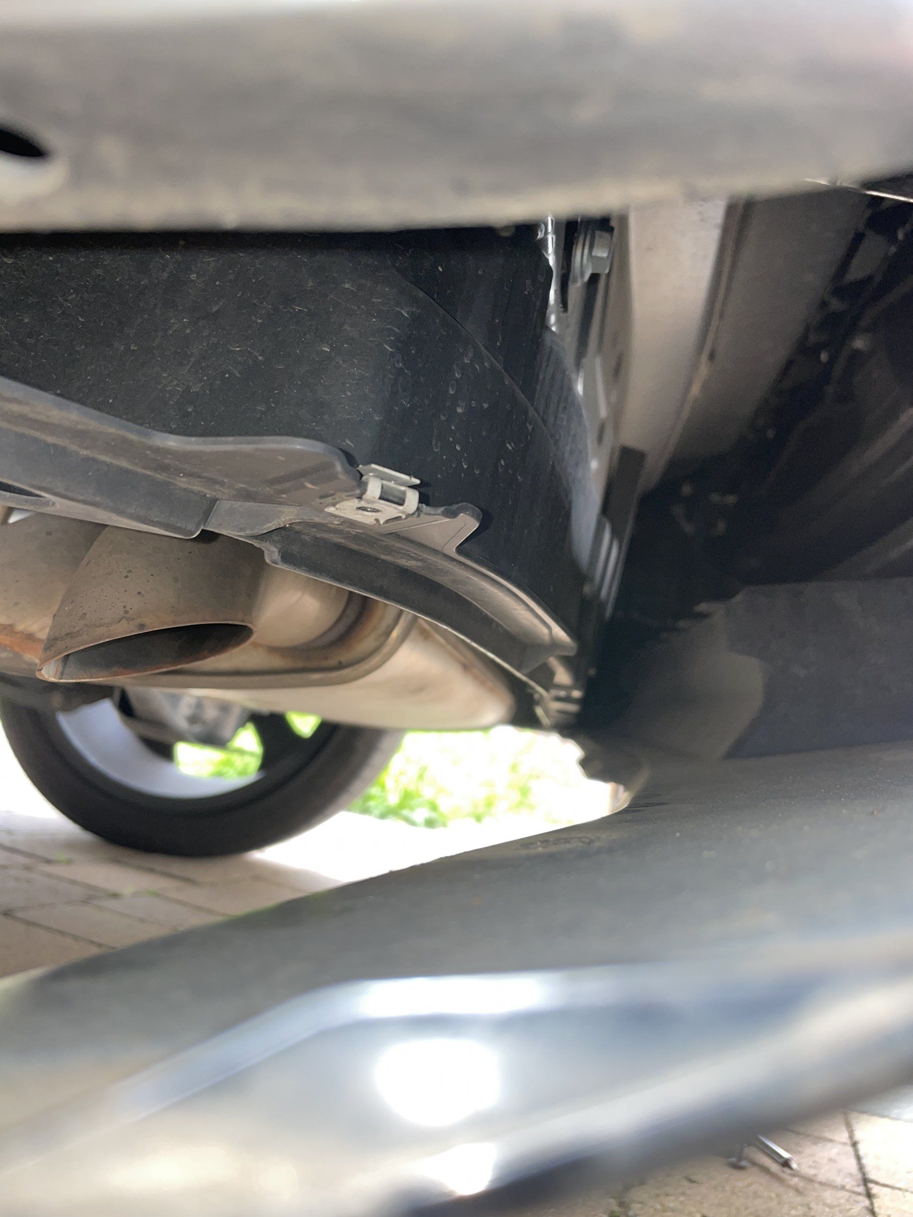

First post here. Been dabbling with the idea of getting a custom exhaust done for my Cupra Formentor V2 1.5TSI, mainly for some extra noise and because I don't like the fake exhaust trim.
Has anyone done this before with any success? I've seen a couple photos on other forums where they've used the 310 diffuser, but I popped off my diffuser today to find a metal bar (Picture attached) Has anyone found a way around this or done an exhaust for the 1.5 themselves?
I have the Beats/Spare Wheel options if that makes any difference.

To be honest I can't see the metal bar you're mentioning? There is only plastic in the way of my exhaust tips, but my spec is retractable towbar ?‍♂️

Thank you for your comment, apologies the metal bar I’m referring to is the plastic bar in the middle of the photo. Ideally don’t want to be cutting through that as it’s where the diffuser mounts too. I could probably get a pipe to go under it but fear it would look stupid!

I don't think there's a way around making a cutout in the plastic bar behind the diffuser, doesn't need to be that big though. What I've got is with visible dual exhaust tips, Cerakoted in a copper finish :love: can't wait to get it in there. Like you, I can't stand the fake plastic trims, so aesthetics was a major motivator for me.

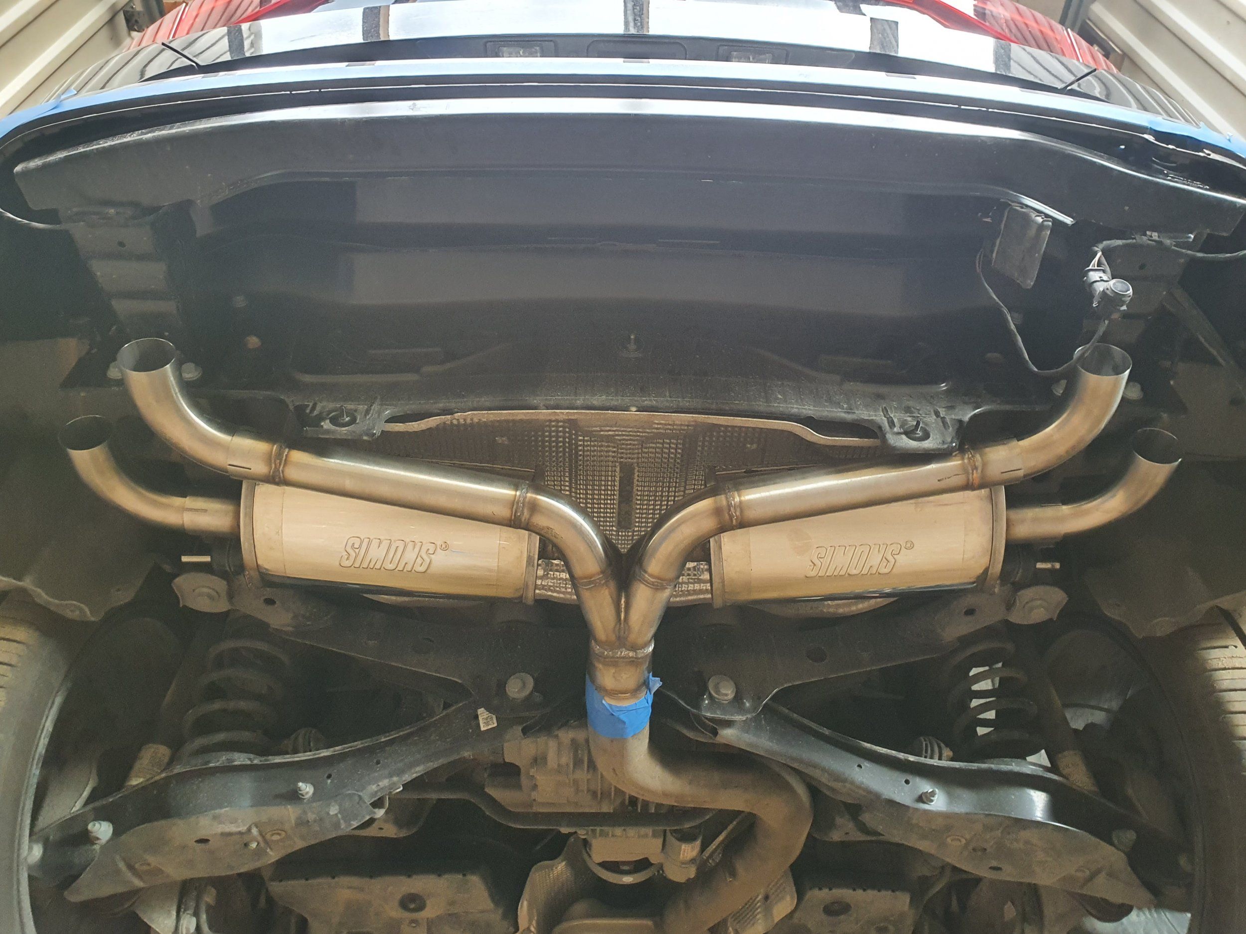

Hello!
I replaced the end muffler and now i have 4 muffler tips like VZ (mine is with 190hp engine). Has anyone remapped to get the Pop&Bang function?

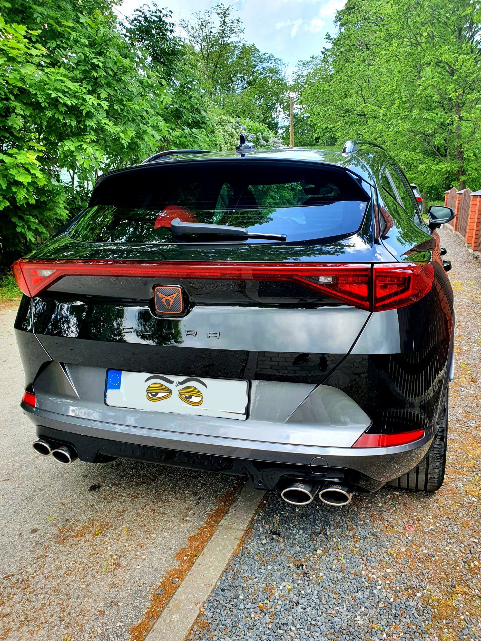

Finished it!
It needs cutting of the plastic wall that you also identified, if you want visible tips. But definitely possible.
I have 2 Simons reso. Also two straight bipe with exhaust throttle module controlled by vacuum open.View attachment 34433
Looks nice, did you just cut straight through the cover or also the bottom part underneath? Had a look at mine today trying to work out how to get it done.
EDIT, how did you get the diffuser off? had 6 or something screws out but still couldnt get it off...

Hi!
I did not cut the bottom part of underneath (you will fit there 3" bipe end (muffler tip) nicely). I took off the whole rear bumper, then it is much easier to get the lower part off/apart.
