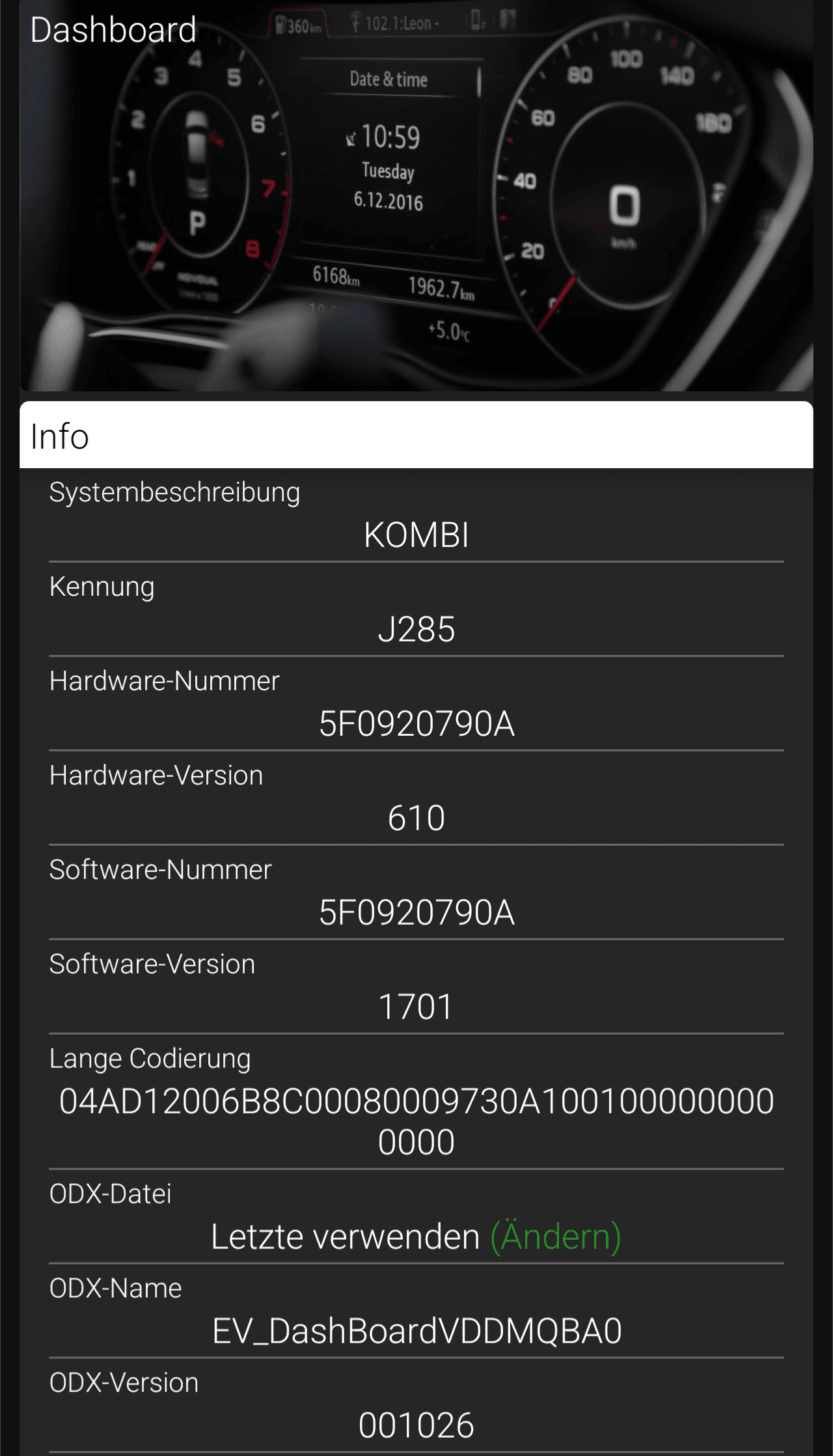

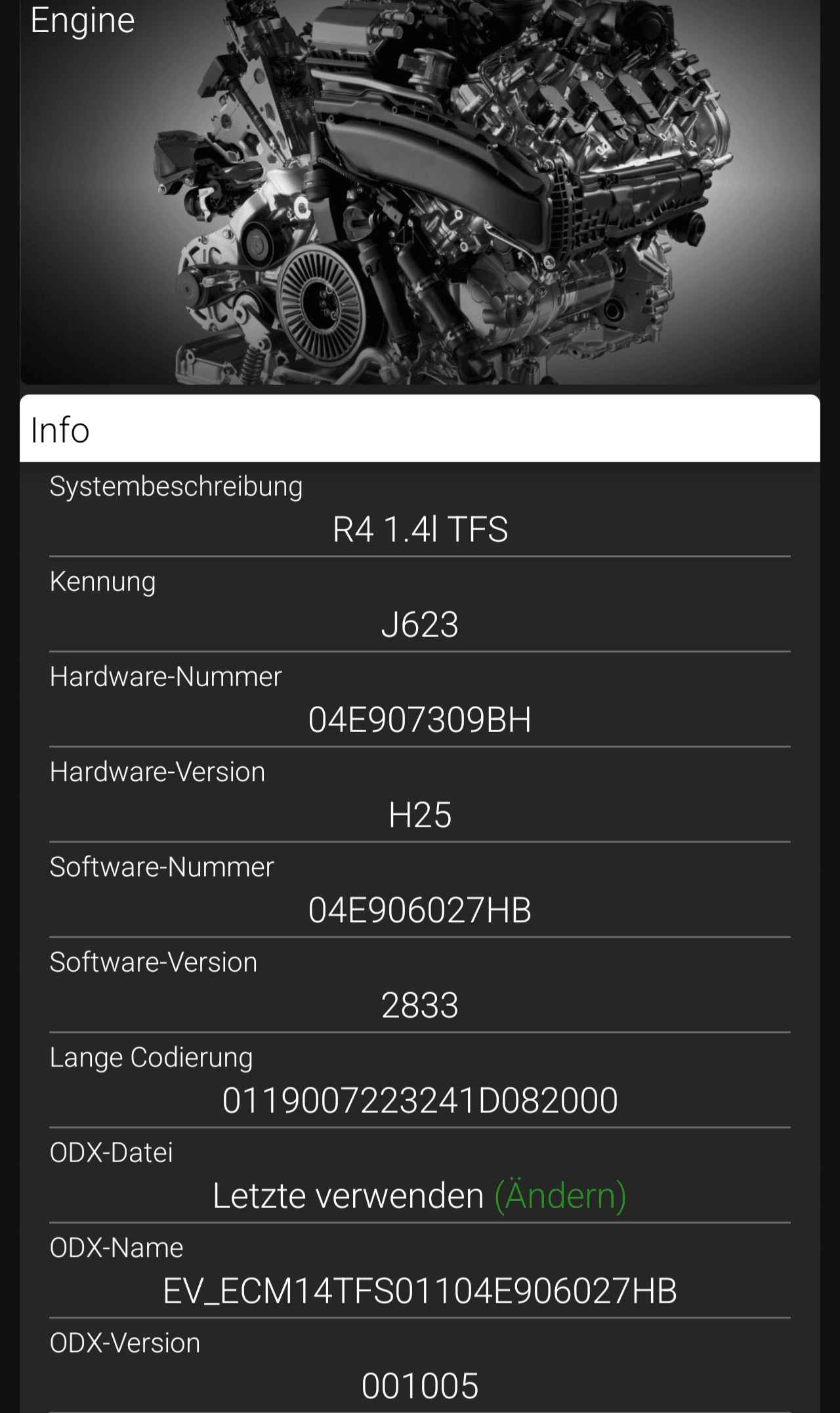

I have activated byte 6 bit 2 in the engine control unit. In the AI control unit, under the settings, I have activated the setting "Display longitudinal control coordinator" for which GRA is active, the speed limiter item.
Now I would like to activate the new speed limiter item via the MFL and the assistant item in the VC. I can scroll there and confirm, but it is not activated. Has anyone ever managed to do this successfully without a steering column switch with a limiter button?

I think that the gateway is too old for it to work via the VC to activate the speed limiter. My gut feeling

I updated the gateway today, changed the index from C to AC, adjusted the coding, etc. Everything is working again, but I still can't activate the limiter via the VC. I even checked whether the accelerator pedal can only control the cruise control, but the pedal can either do nothing or everything. I have installed one that can do everything, of course, thanks to the cruise control.
