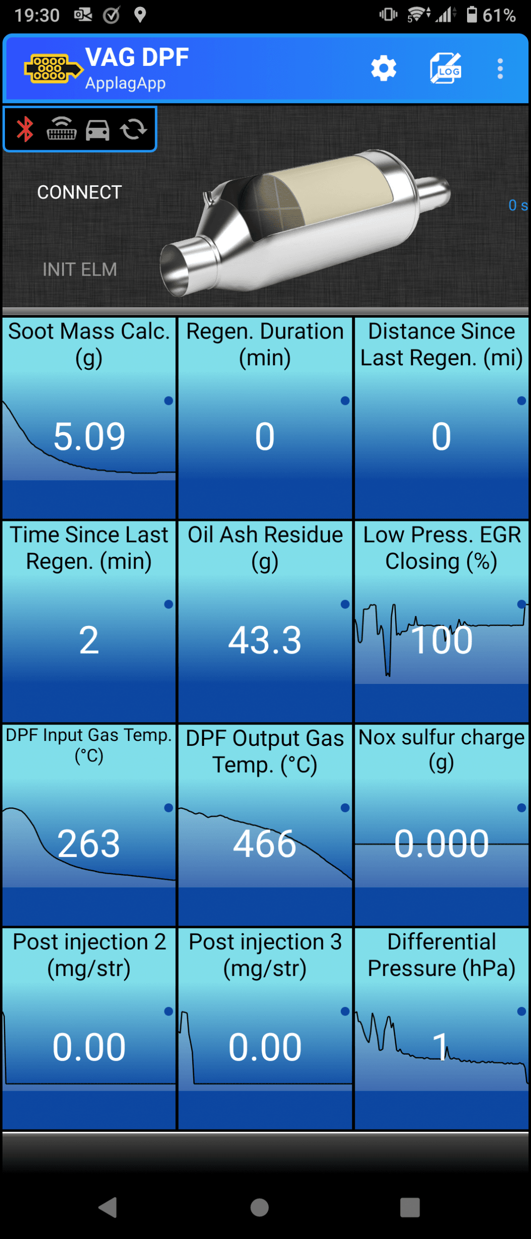

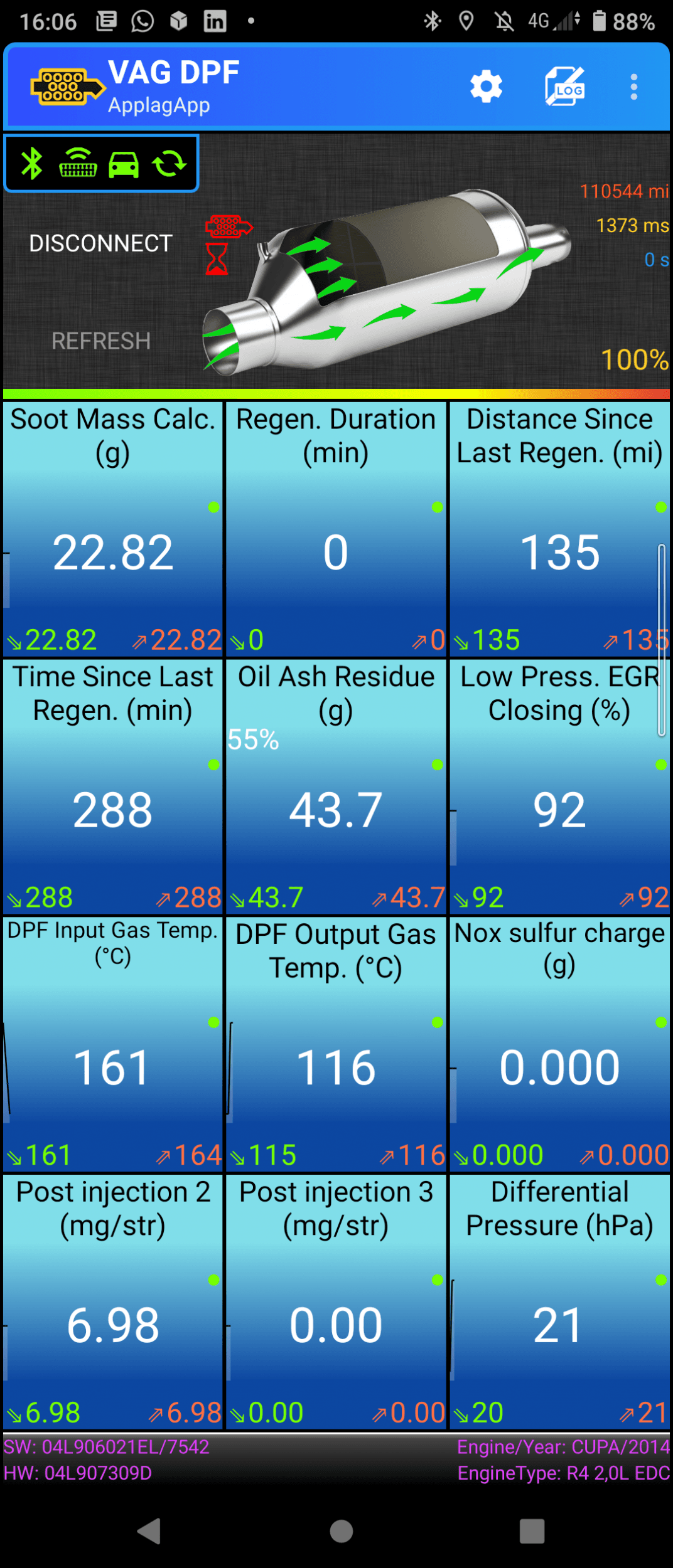

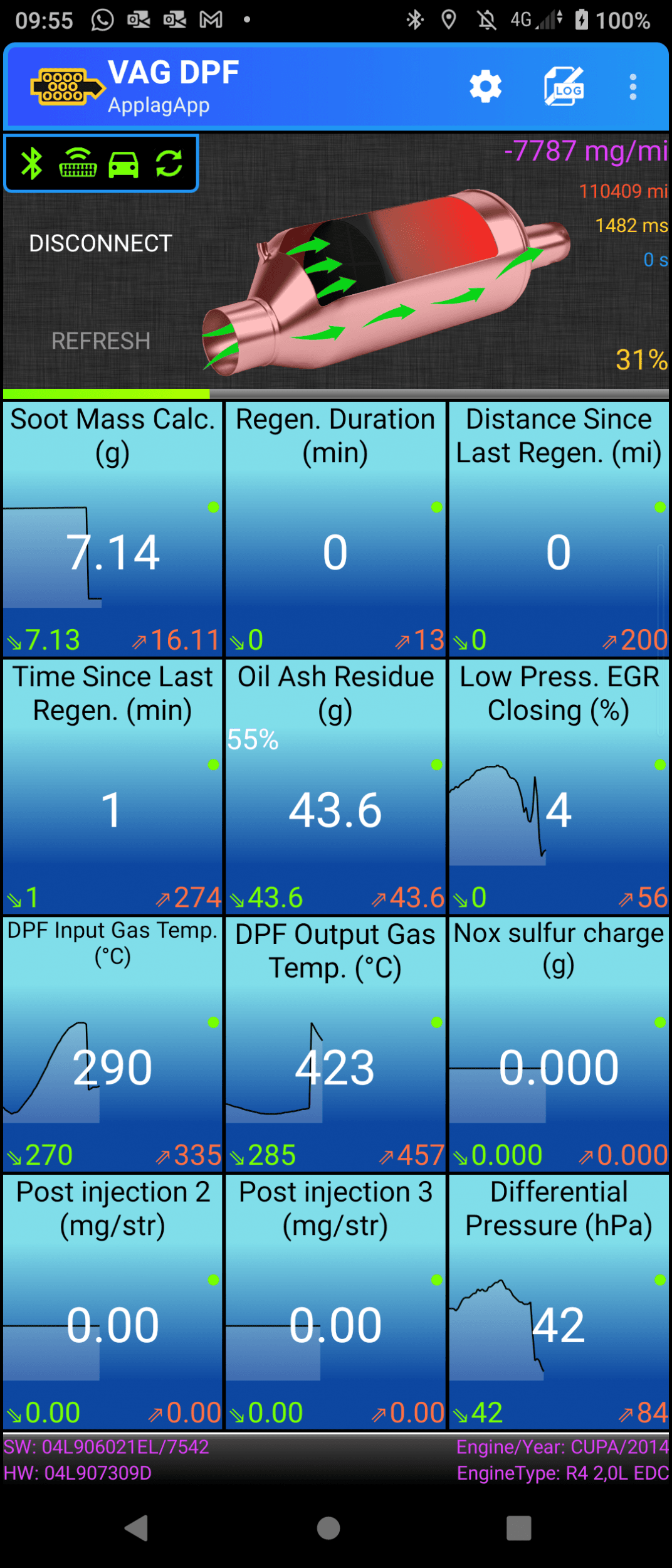

What's your Differential Pressure at Idle after a regen ? And also when it's close to full?
BillyCool
Jan 16, 2020
737
302
Leicestershire, UK
2 of these are from yesterday. It was at 76% (17.34g soot mass calc) then jumped up to 22.82g after another 23 miles and started a regen. The post-regen pic is from 4 weeks ago.
