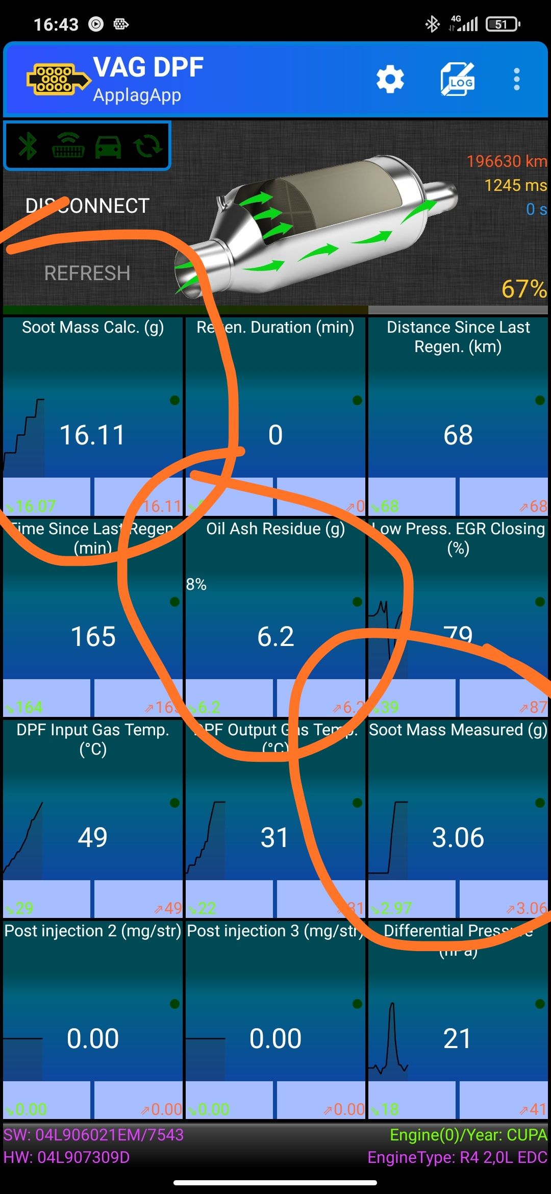

Go to settings, Custom engine group, and select Group 0 CRBC,CLHA,CKFC. They are basically the same engine (the 150hp version, 2L also, EA288), but it will also show you the Soot Mass Measured instead of Nox sulfur charge, so you will better understand why the sudden jumps.
Also what are your avearge values for mg/km ? When engine cold vs engine at operating temp.

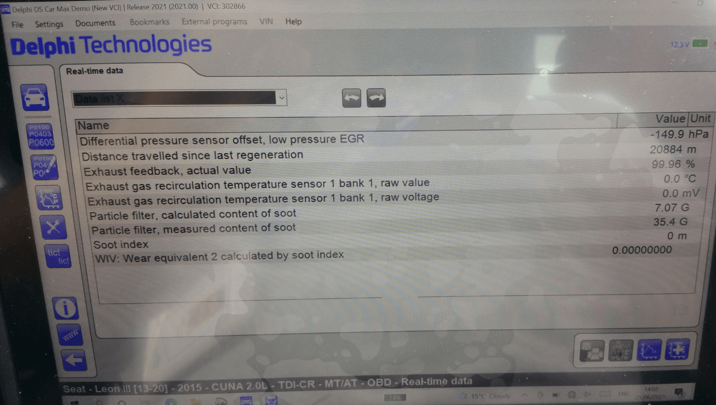

I'm on about 95,000 miles. 2015my
measured soot 35.4g
calculated soot 7.07g
distance since last regen 20.8km
Don't know if measured soot is the same value as ash in the DPF app?

My bad as i wasn't clear enough. The value in the upper right corner in the VAG dpf regarding Soot Quantity. The one that says -7787mg/mi in your screenshot. If you leave the app open for a few minutes while driving, it will also show how much soot is produced per mile( or km, depends on settings probably ).

The ash should be oil ash volume if I'm recalling correctly ( in VCDS at least ). The measured content of soot doesn't seem right as 35g is way above the limit. Also the differential pressure offset seems odd too. The offset should usually be around a few negative hPa. Definetely not -149.

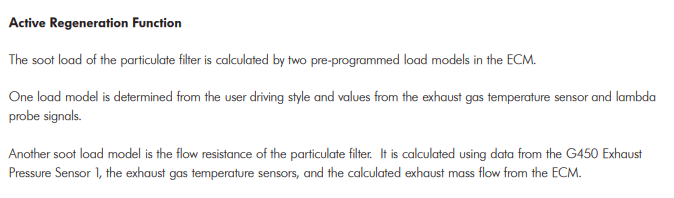

As from the self study program you also linked, there are two soot load models.
The first model referred is the "Soot Mass Calculated" and the 2nd one is the "Soot Mass Measured" .
Most certainly when people see jumps in their Soot Mass Calculated, it's the 2nd model that is getting to 100% triggering a regen.

My engine wasn't running.
Like I said: Don't know if measured soot is the same value as ash in the DPF app?
My edited answer should clarify this probably.
TL;DR: No, measured soot is not the same as oil ash.

Thank you, I couldn't see the measured soot mass on Brian's screen shot.
There were loads of live data streams to pick from. I'll try and borrow the tool and have a deeper look.
That's why I told him to change engine group.

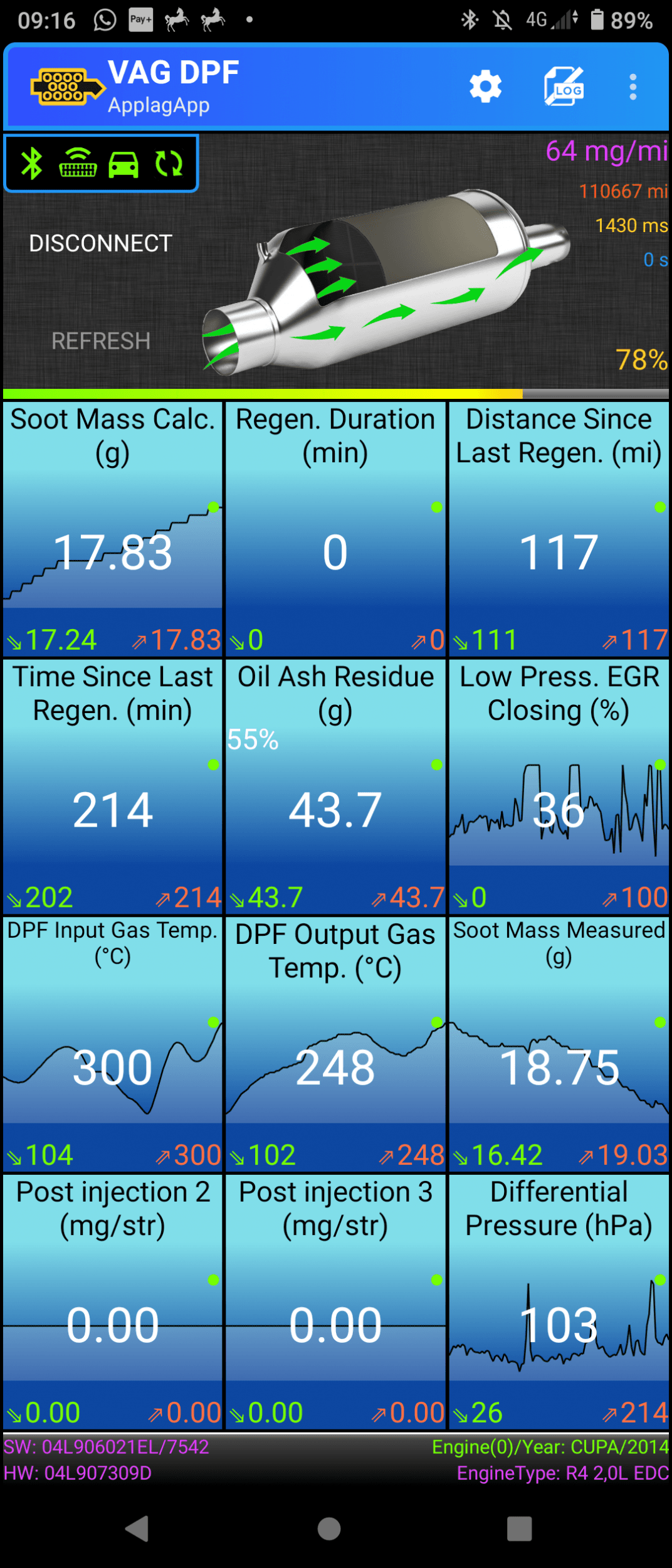

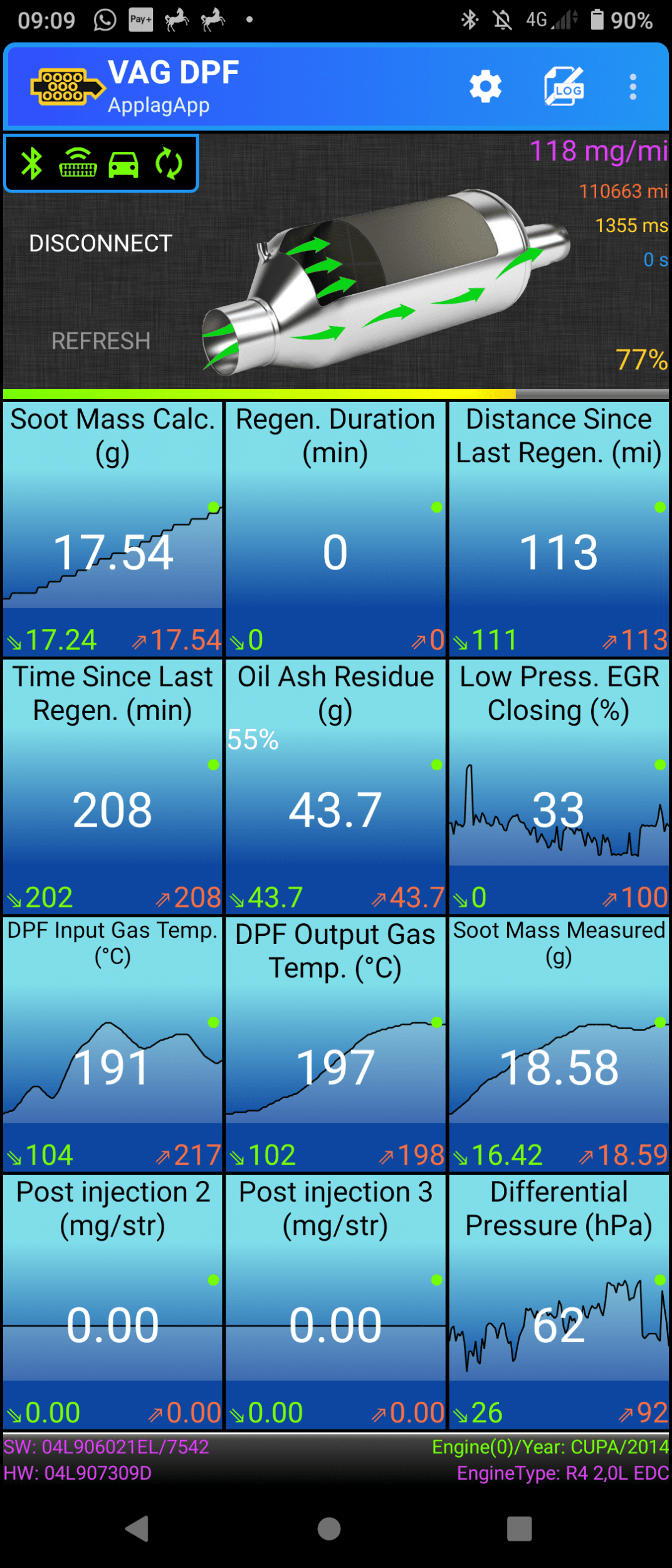

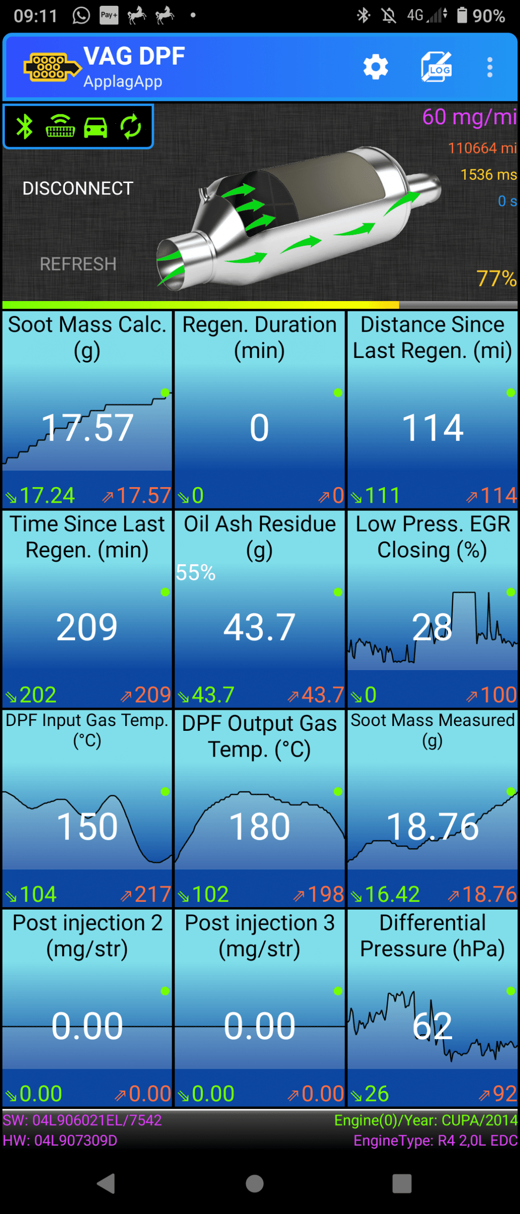

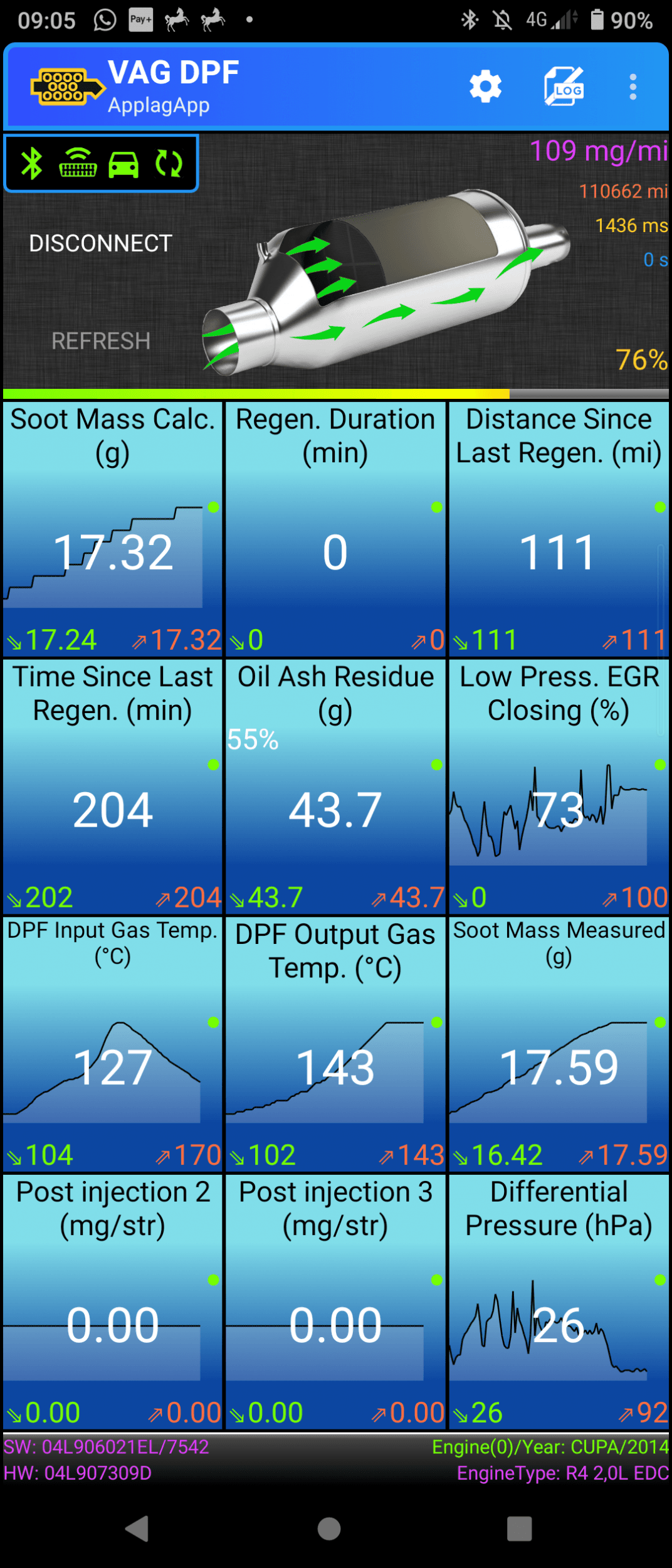

So - here you are. As the car is first started and driven, the calc soot mass is more than the measured and then the measured catches up and becomes the greater figure.
My mg/mi was around 110 when colder or town driving and seemed to drop to around 60 on the open roads. That might explain why it DPF regens more now I'm doing lots of local trips c.5 miles and the car (oil) isn't even up to temp. I used to do a 20 mile commute each was and motorway miles. Now I'm plodding along on rural roads with 30/40/50 limits. I don't even get over 60 and a lot of the time the car doesn't even get the oil up to temp.
I do think that the DPF might be getting more full up as well but I'm open to suggestions.

If the car hadn't been using abnormal quantities of oil, then your Oil Ash Residue reading might be somewhat accurate and 55% shouldn't be a problem. Otherwise, it will be higher than what's estimated and your DPF might indeed be more full.
