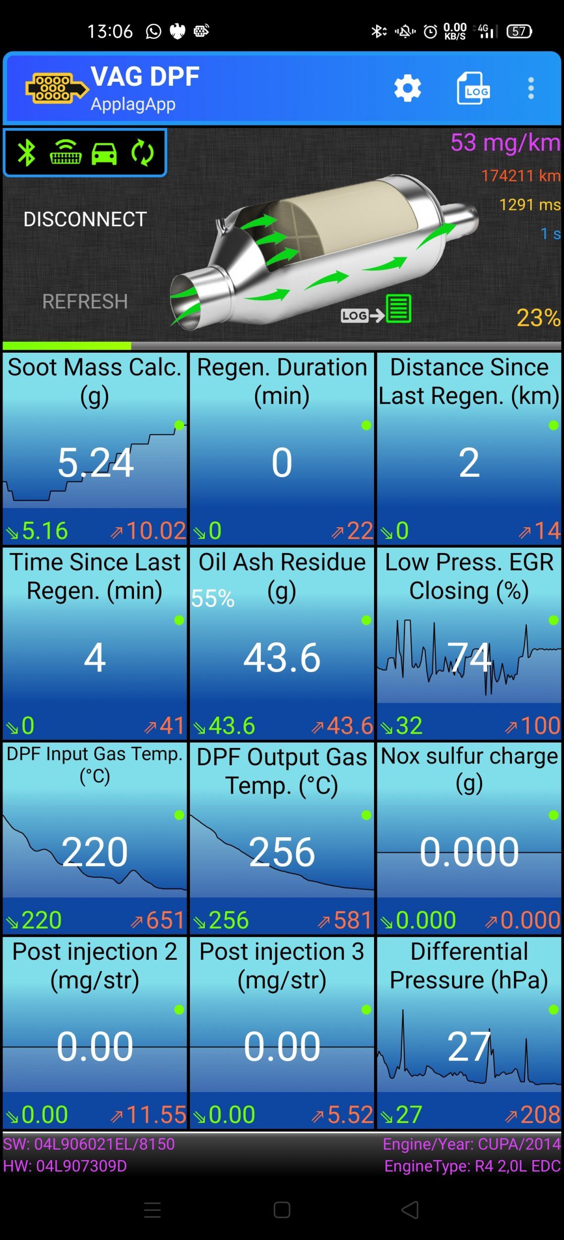

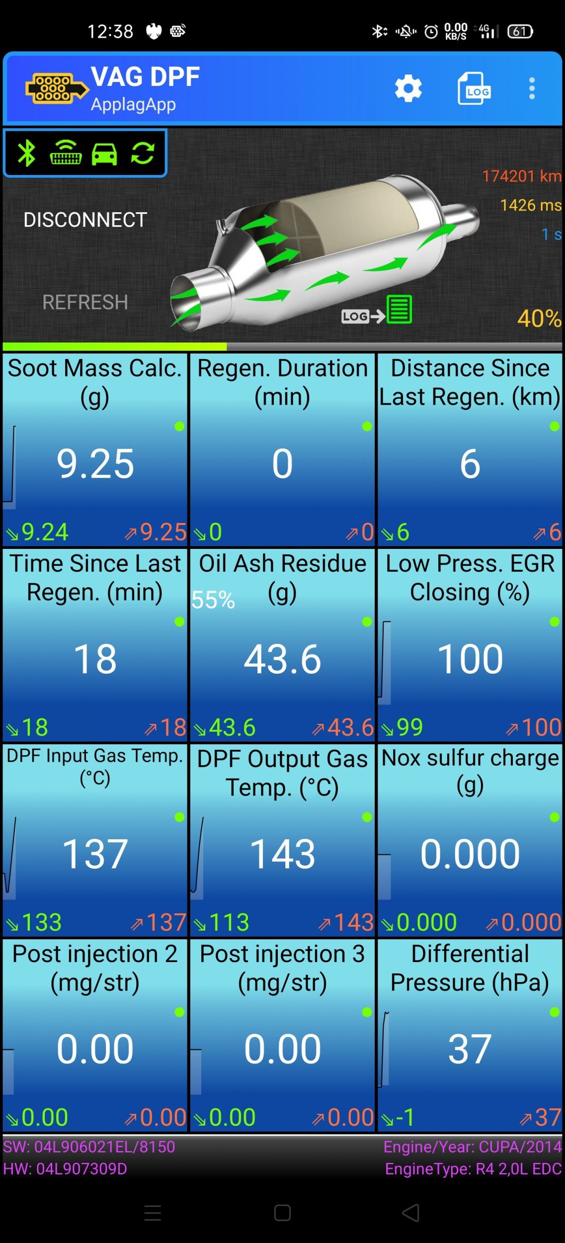

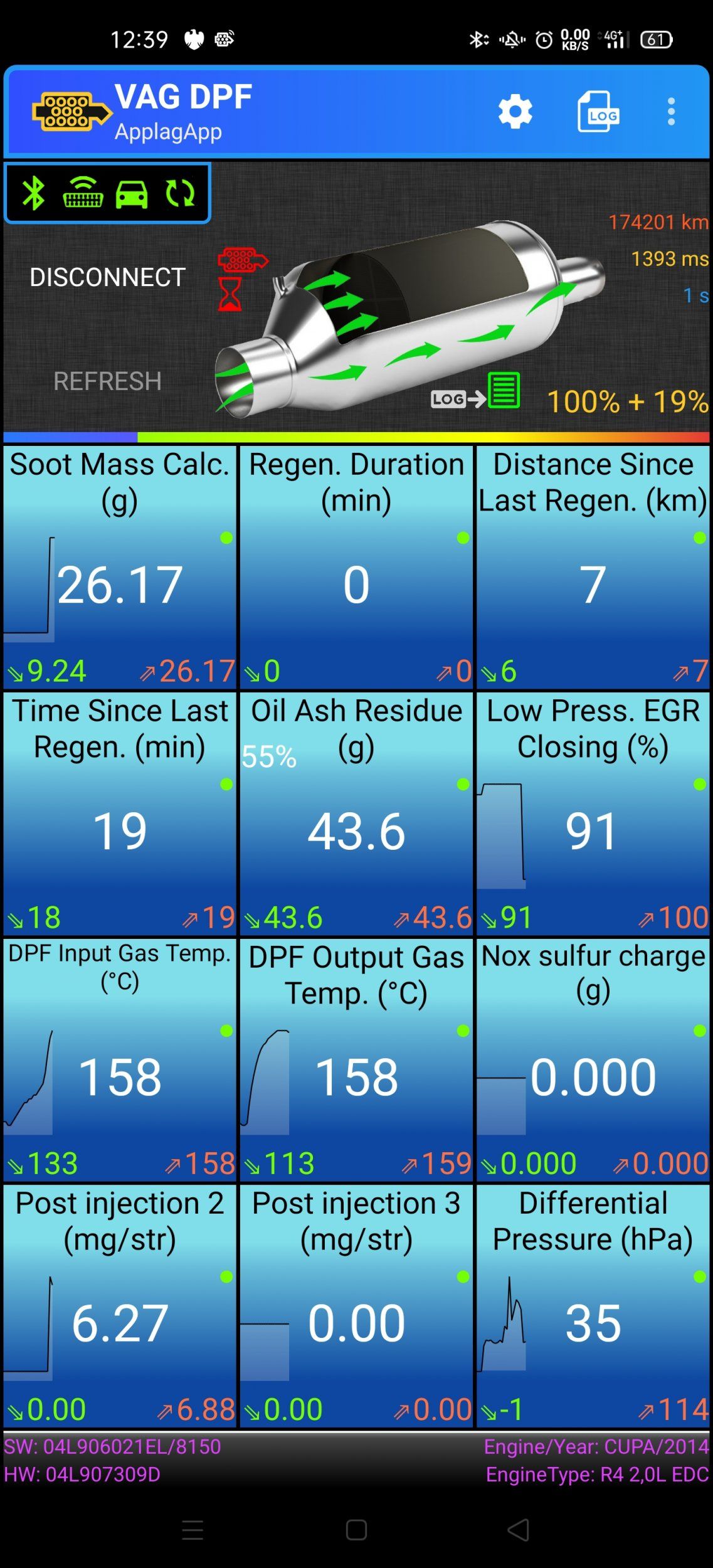

As for the app it's brilliant, many thanks I will upload some screenshots now. Had a fuel light this morning, so a regen can't start, as soon as I refueled it ramped the soot up to 100% + 19% on top :D u will see on the screenshot.
First one just before refuel, second just after, jumps instantly to over 100%, third after the regen and u can see on it differential pressure being 26 hpa when stationary, don't know if that's good or still outside of the normal chart

Clearly somethings not right. You're going from a `clean` DPF to full instantly. To me, that's a dodgy sensor and/or blocked sensor pipes. I can't see why a turbo, EGR, piston rings or any other issue can cause the readings to spike so much. It's also the cheaper fix.
If a car does an active regen, it can smell a bit acrid but not sure about the white smoke? You could have more than one issue, it's hard to tell.
As for the differential pressure, I don't know if that's good or bad. I'll have a look at mine.
I read somewhere else that an issue with the ECU can cause erroneous DPF figures as well. I always like to start small and build up. Personally, I'd take the DPF sensor off and blow some compressed air through the 2 pipes. I think that if you have VCDS you can check the air flow through the sensor and see if anything is amiss. Then change the sensor (again). If you know the engine ECU is getting dodgy data you know where to start.
If that is all fine then you'll have to start writing a list!
