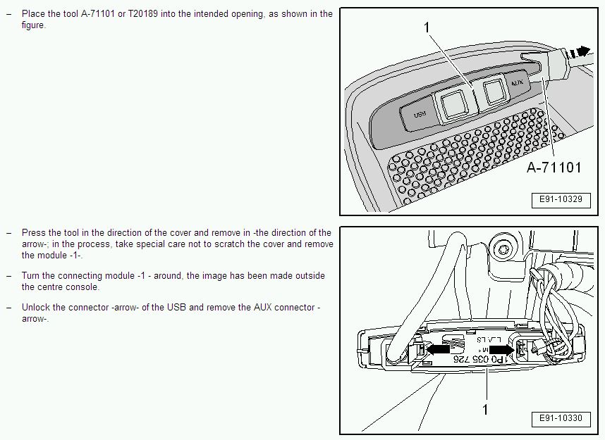

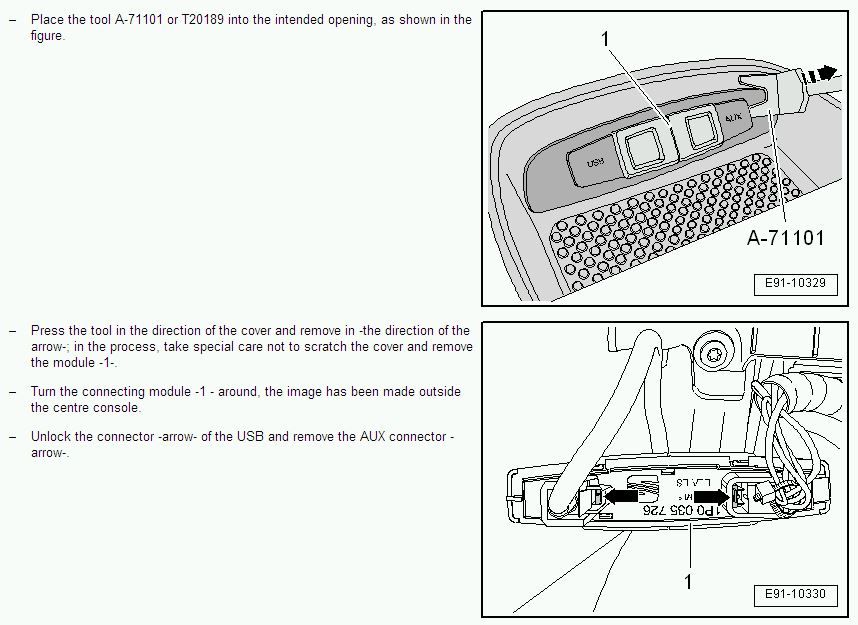

I found an image online of the part if that helps you know how I leady it is to fit lol mine is bubbling on the sliders...

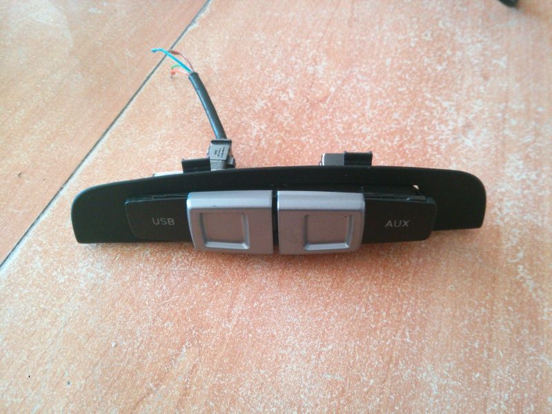

After a lot of swearing and sweating I managed to get it off, thanks to the images provided. Cheers everyone. Cleaned the port with compressed air put it back together but still isn't working properly

it took some getting out as i dont have the plastic trim tool remover. had to use a mixture of flat heads and a old bendy paper scraper lol.
