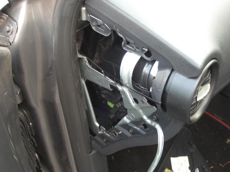

There are two grommits on the passenger side of the engine bay (in photo below, shown without the rubber grommits in place.) You can thread a cable through here and it pops out behind the glovebox / sound insulation. This is where I ran my boost gauge vacuum pipe!
the hole is there for bonnet pull cable for left hand drive cars and the best earth point rear wheel arch bottom behind side trim
