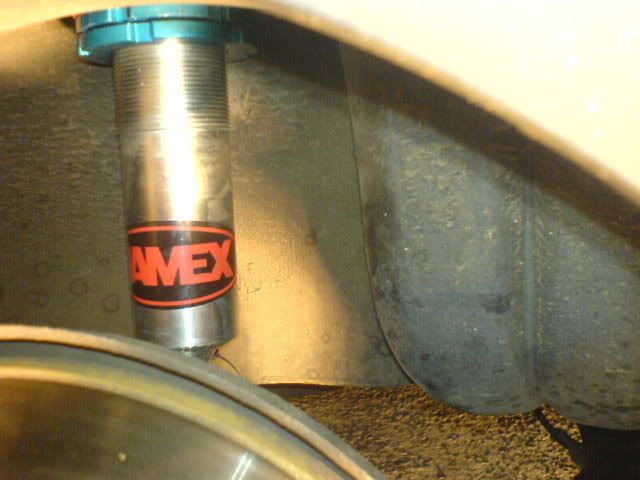

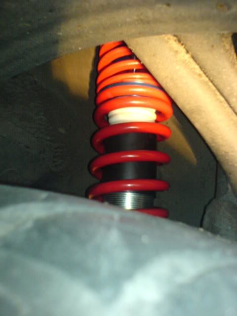

ok fitted one of the rear coilover tonight and i was wondering there is like alot of nuts used on the standard rear shocks to bolt the rubber mounts on, and do u use them on the coilovers as i only got one thick nut with the coilover so ive used some of the nut thinner nuts and put the thick one in side the boot on the top rubber i dont know if this is right lol, also i noticed the little spring at the top of the coilover hasnt crushed up like at the front im assumming thats becoz there is no weight on the rear as the front one has squashed up.... take it that is right? ive set it quite high at the rear probably about 15mm lower<just to check it and will lower afterwards:p (Havent done the other side yet either).took apic of it

Well the spring your on about is the helper spring. Dont worry too much about that. On my kit, which is the same as yours, there is only one complete spring on the front.
nope...mines got helpers on the front also unless im not gettin what your saying lol cheers for help tho:p
What do u mean?... jamex yea they are from philj why? i did think they was supposed to be badged up as v-max oh and the first pic u can see is with the wheel on and the car lowered down i would of thought it should crush like the fronts have, unless its because i havent fitted the other rear coilover yet:whistle:
