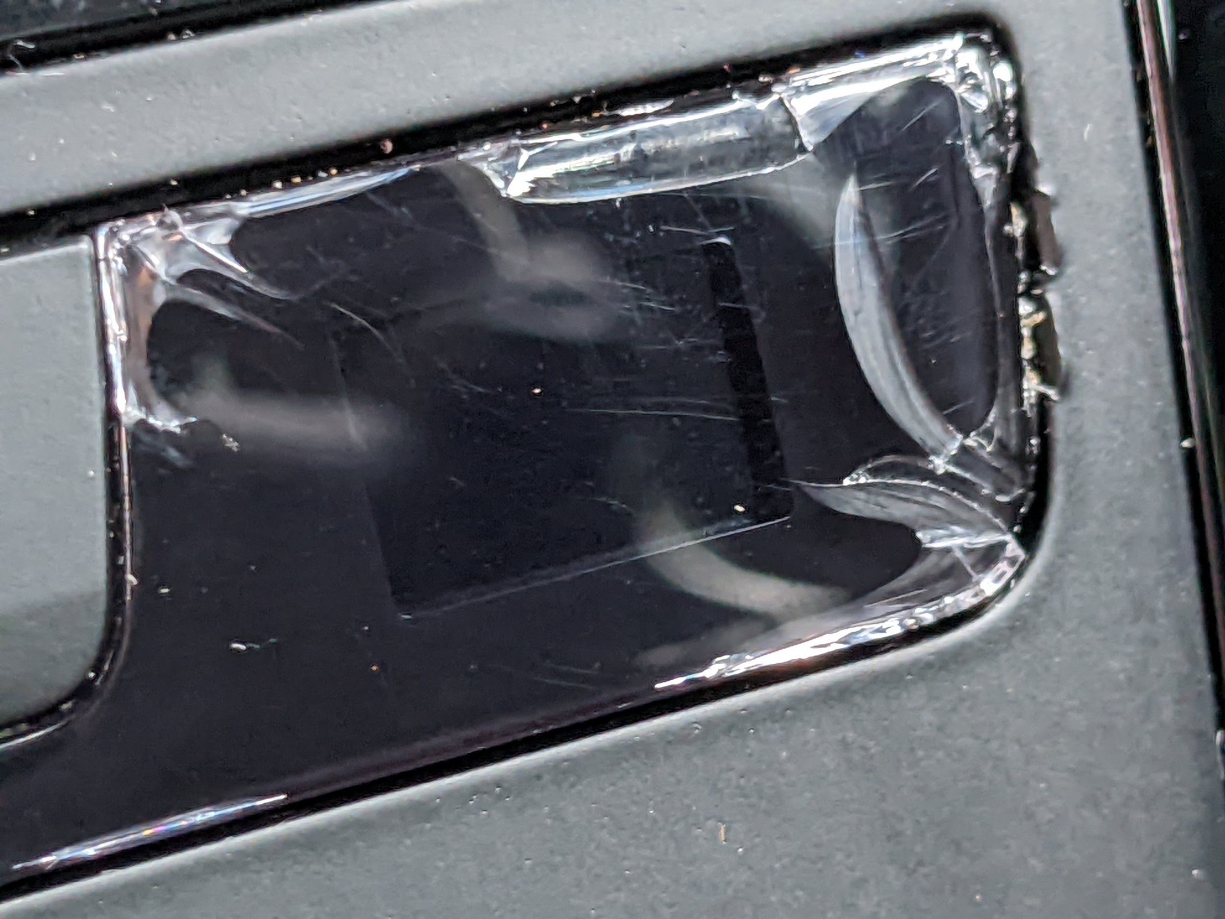

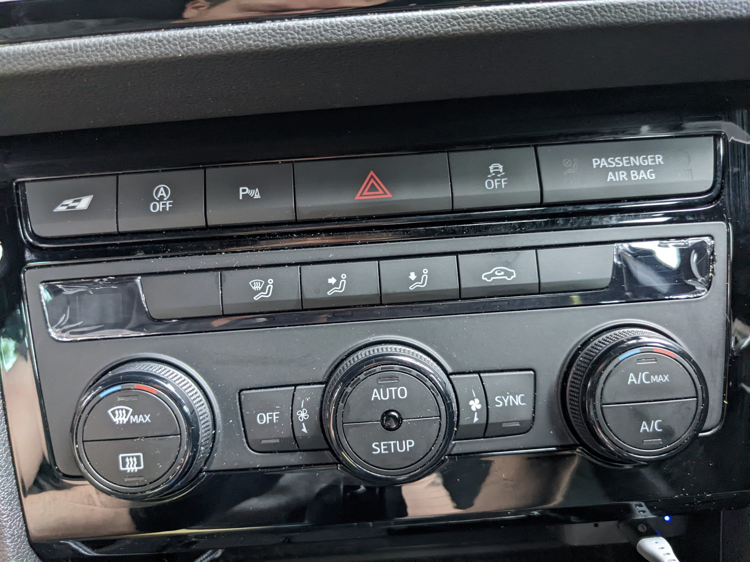

It's taken me a couple weeks to getting around to making this post, but medium story short I had my car valet a couple weeks ago (regret!), right around the days where it was super / record hot, a couple days after I noticed the plastic around the a/c temperatures was fracturing and coming off. We did make it worse in a few places when we initially thought it was a plastic protector cover that'd never been removed (regret!).
1. Anyone come across this before? Is it a result of a tool or chemical the valet used, or the heat, or both? He didn't do a great job so I don't really want to ask him, just avoid a repeat.
2. Anyone know the specific part number and if correcting it is a small plastic part of a giant PITA?
Appreciated!

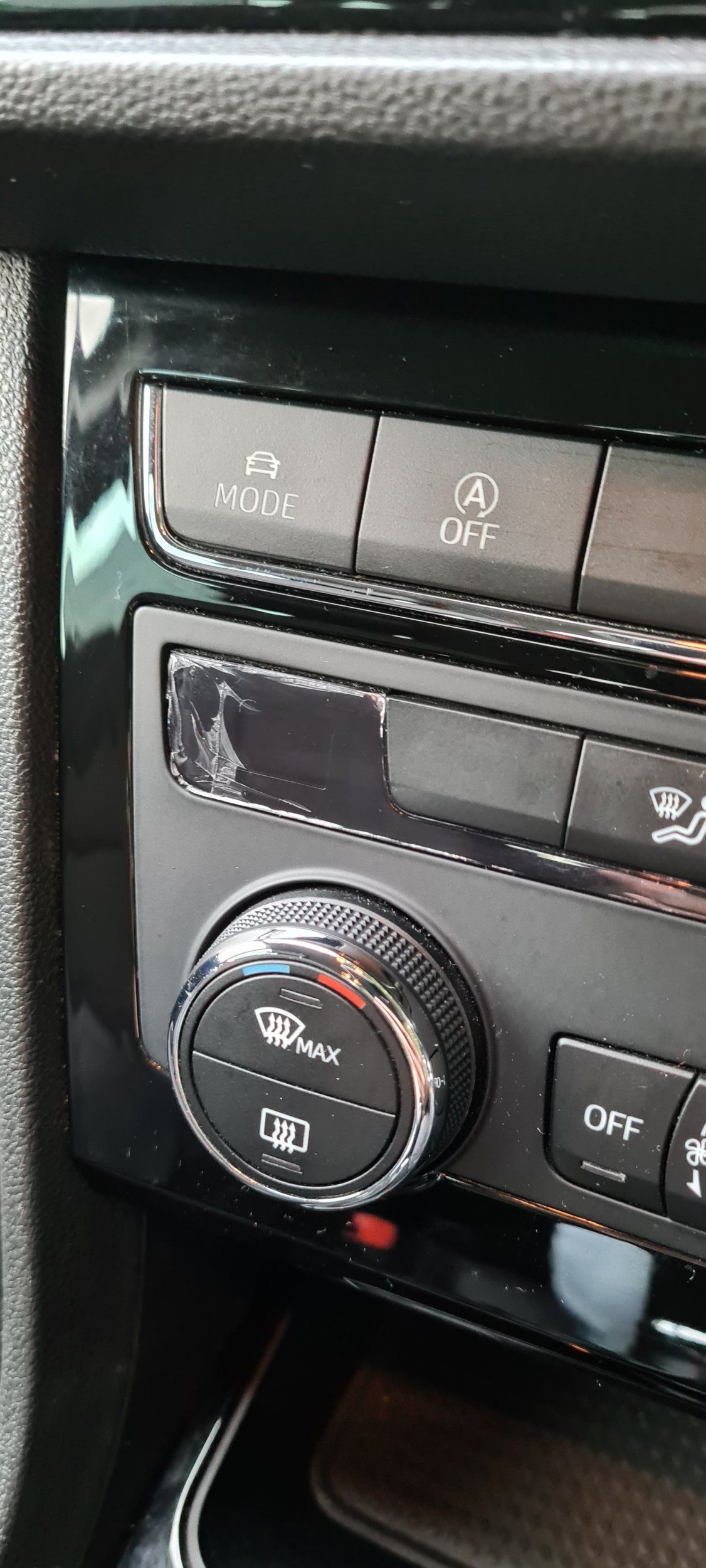

It's my first seeing and super annoying for a 69 plate, any ideas what this panel is called?
Hi this happened to mine during the recent hot weather. I brought a used climate control panel off ebay for £30.
Reactions: carl^
Good to know it's not just me (but sorry for your loss), climate control panel look to be the magic words, thank you!
No, not just you - check out this discussion thread;
Reactions: carl^
Hopefully you'll find a decent one, a lot for sale on ebay with scratches and cracks.
Reactions: carl^
Yeah it's the heat. Crap plastic used from SEAT.
They will just patch you off though and say you must of damaged it
Swapped out the old one 2 weeks ago, limited selection on the ones exactly matching the trim so paid a little more and slightly different part number, plenty of videos on youtube for the best removal method, looks good for now. Thanks for the help.
