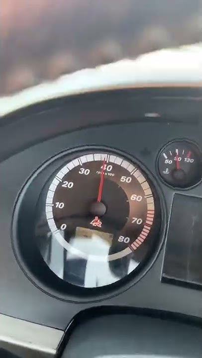

Have a look at my video on this thread, is it similar to what is happening here?
Feb 26, 2022
5
I don't think so.
It is hard to judge by watching the video without looking at the rev counter.
It goes like this.
I am in any gear > revs build up fine until I reach 3500 > this is when it will suddenly jump up over 4000 then drop down again and then act normal.
Do you reken a coil pack could create an issue like this?
