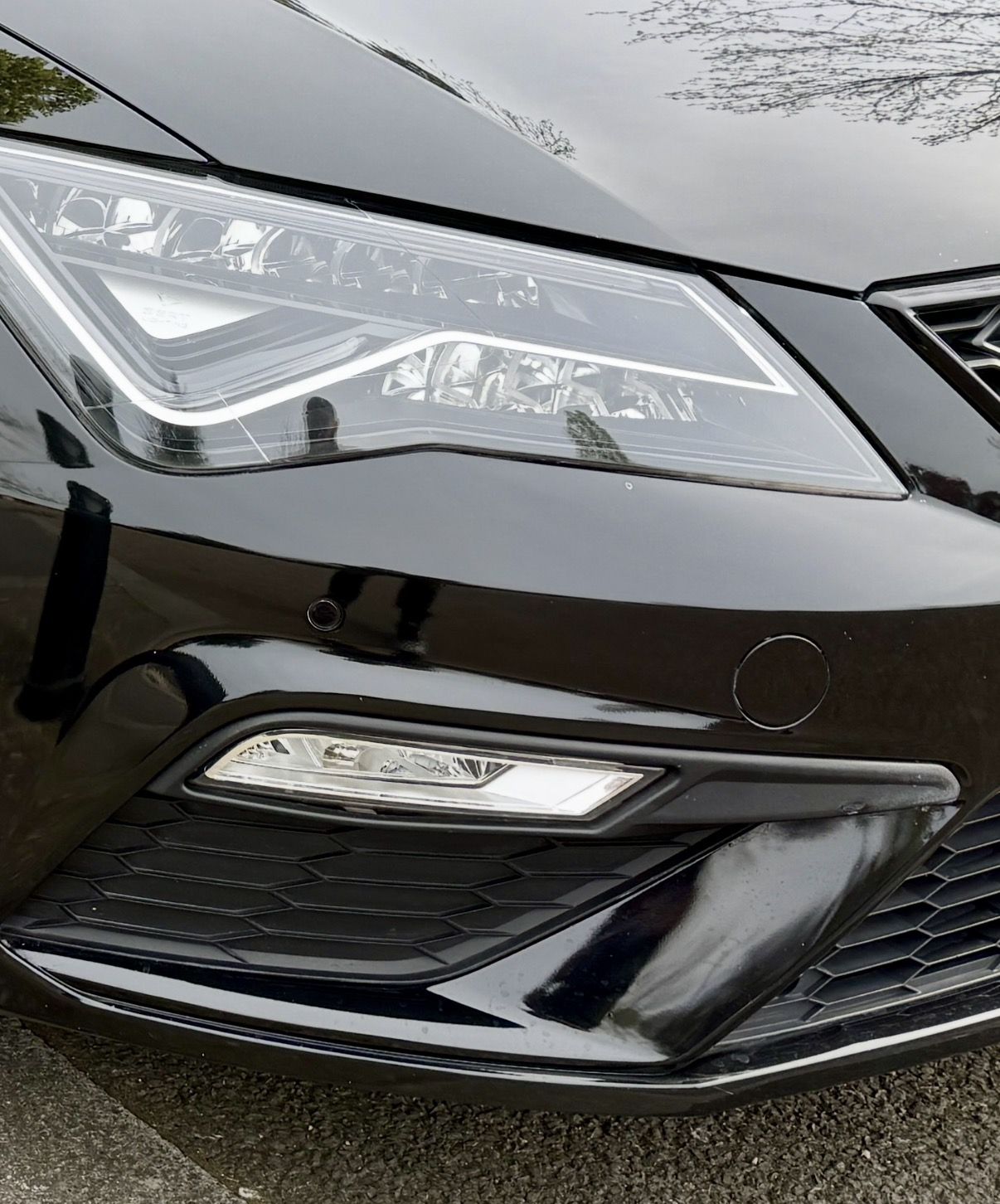

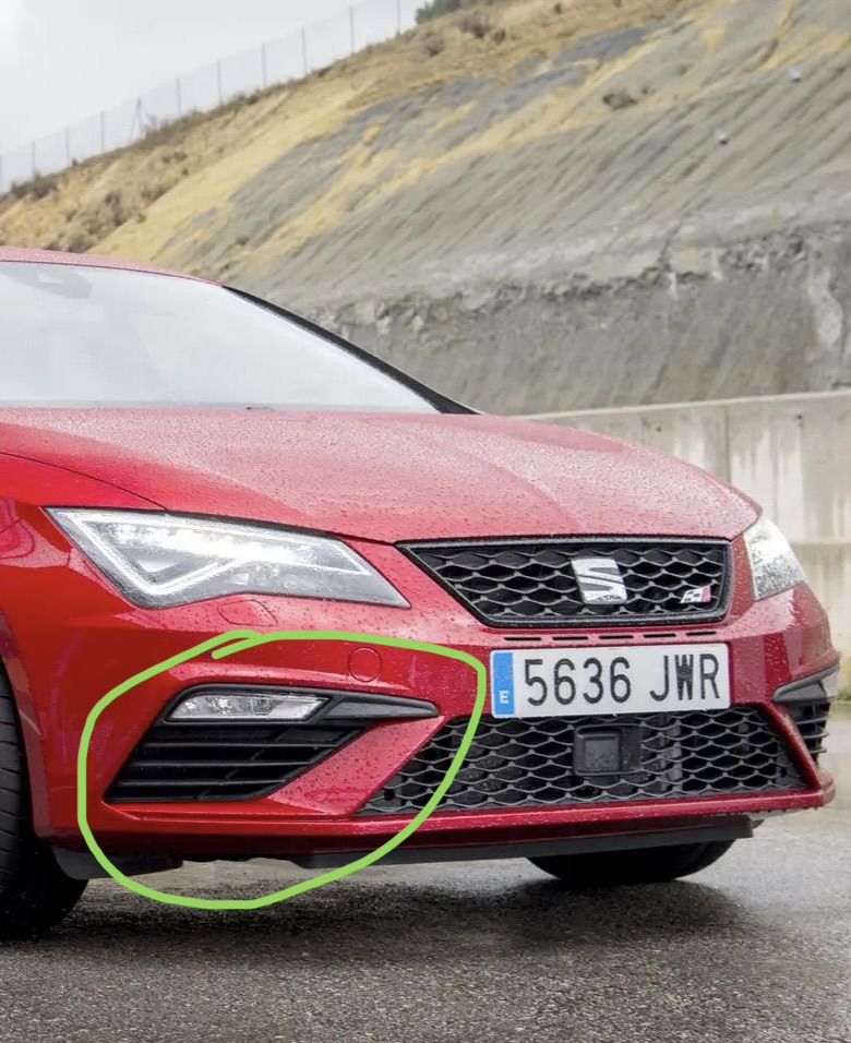

Hi all, my fog light trim on my FR is quite faded and the other has some damage.
I'm looking to change em to these cupra ones, I'm sure they'll fit but does anyone know the part number?

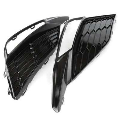

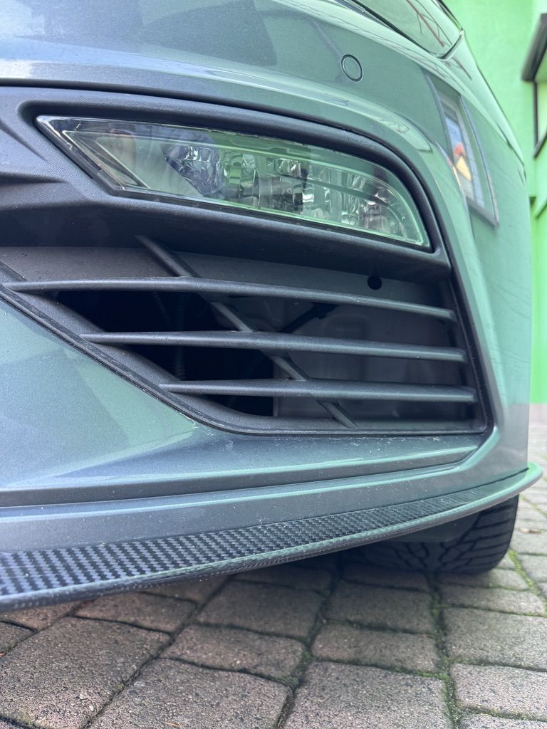

5F0853665J Cover left 01/17-08/20 9B9 Satin black
5F0853666J Cover right 01/17-08/20 9B9 Satin black
Try to find some real life photos using those part numbers & check accuracy before ordering.
Reactions: Mo_86

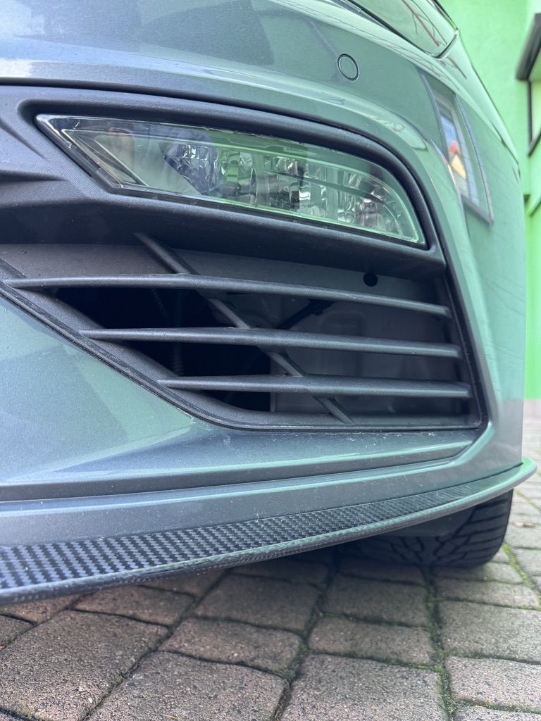

I can see the top picture but not the bottom, you have changed yours too? Was it easy and do you have much debris on the washer bottle now then?

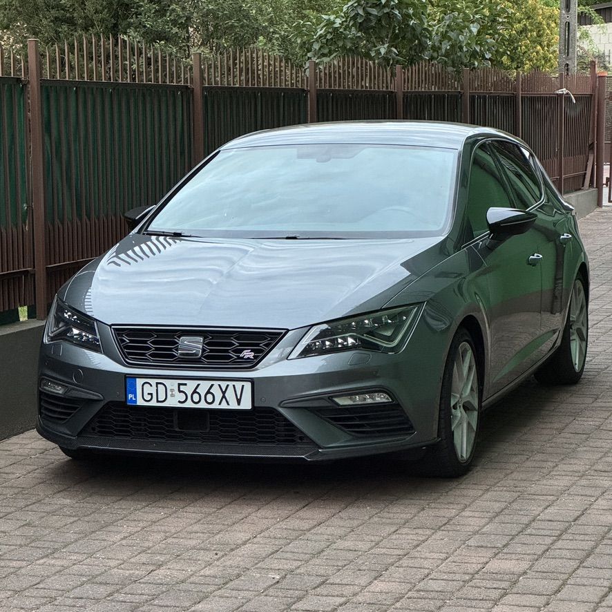

Ah yes, imgur... I forgot that for some reason it is not available in the UK. It should be fixed now.
Yes, I've changed them in my car. As every job with plastic trims it is preferably to work while it is not freezing cold outside. Also I would recommend to remove bumper from the car as even with that I took me about an hour to remove them without damaging anything.
Here is how that washer bottle looked after month of driving with those trims. I would say that it looked exactly as before.

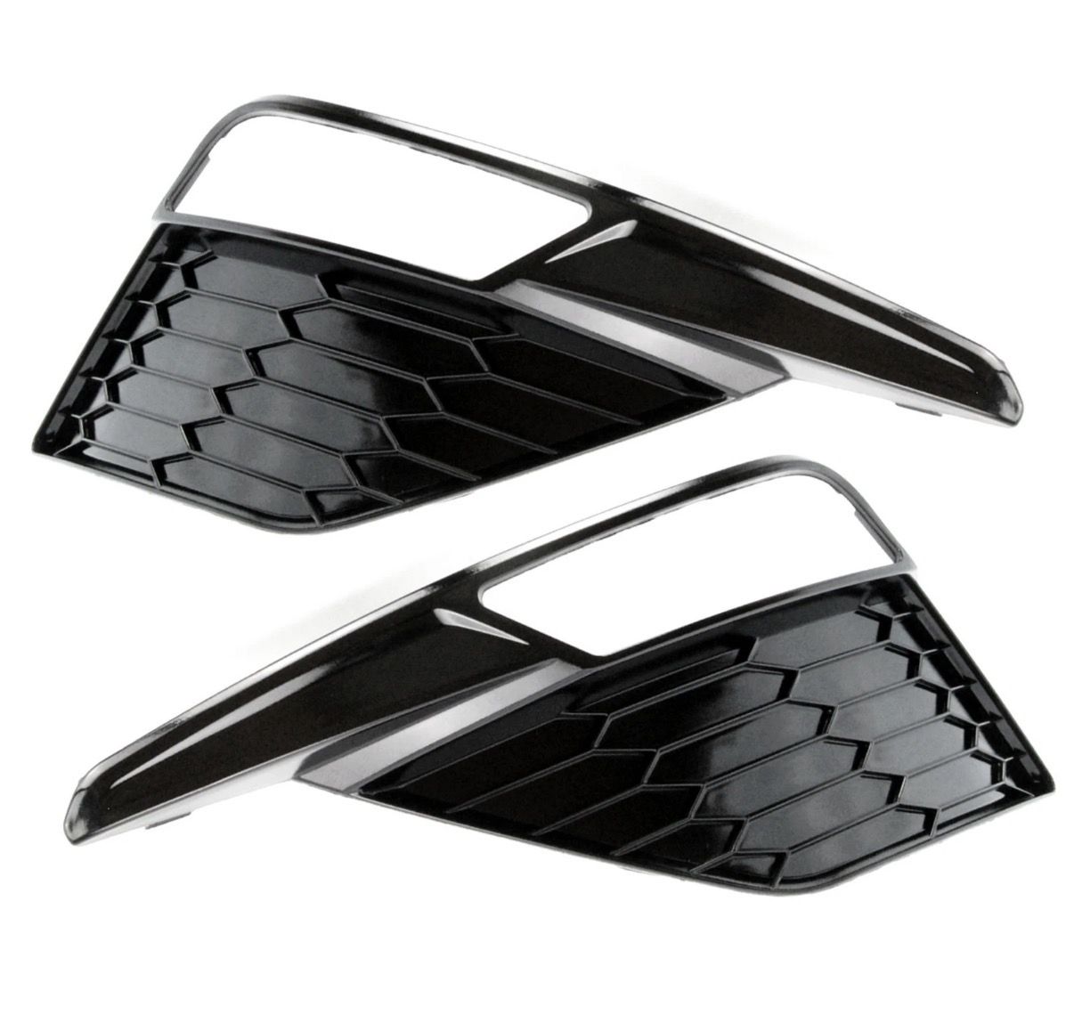

Was about to purchase the cupra grills then came across this;
Has anyone got these fitted? I quite like the gloss black and it would match the main grill surround.
Has anyone got these fitted? I quite like the gloss black and it would match the main grill surround.View attachment 53165
I have installed on the Car, but painted OEM
