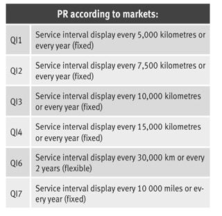

You should be able to tell which service regime your car’s on from the number of days until the next oil change and inspection, which should be accessible in the vehicle settings menus via the infotainment screen Additionally, you may have a data
sticker for your car - with VW, they’re usually located on the boot floor or in the front of the owner’s manual (or in both locations). The data
sticker includes a number of PR (product) codes, one of which should be for the service regime, although strangely, it’s not always listed. The complete range of PR codes for the different service regimes are as per the table below (they are the same for VW and Seat, so presumably also apply to
Cupra) - for UK vehicles, codes will be either QI4 or QI7 for annual time and distance servicing or QI6 for flexible / variable servicing.

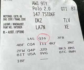

Here‘s a data
sticker for a VW showing the variable service regime PR code QI6 for that vehicle;
